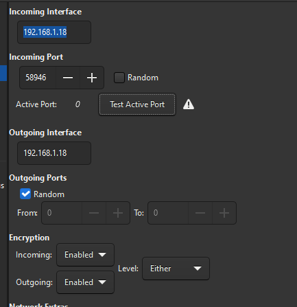

Hey Guys
not sure if this is the right place to post or not, but I have been using the BinHex version of deluge for a few weeks/months now and its been working absolutely fine.
Though over the last few days its stopped downloading any files, no matter from any trackers. I haven't changed any of the config so I'm not sure what's happened, there's no errors in the error log either.
I have reinstalled the docker image and of course rebooted Unraid as well.
Any help would be greatly appreciated.
9 minutes ago, terrorc0j said:
Hey Guys
How Your settings look here?

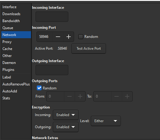

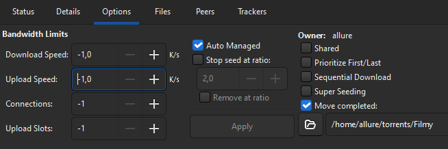

Hi
These are my settings
always download 0 %

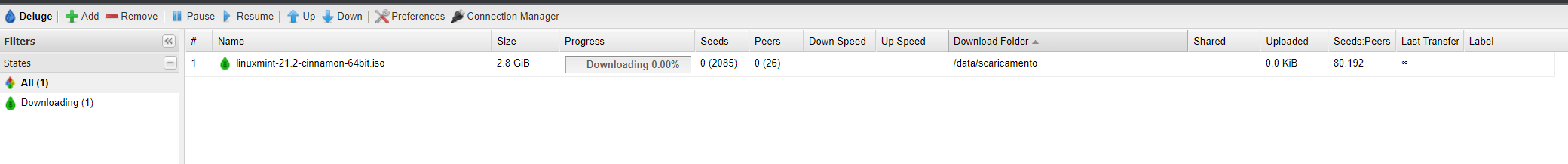

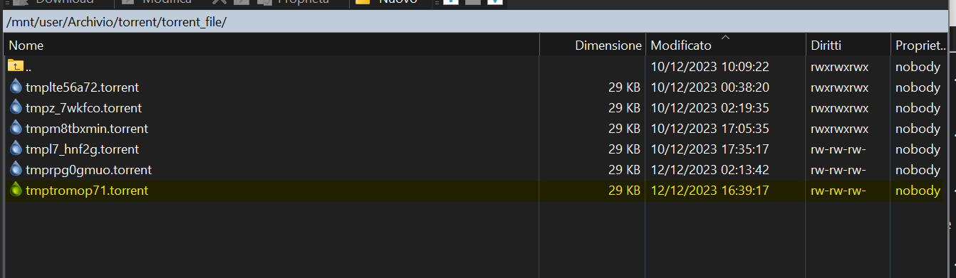

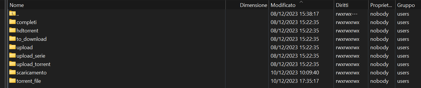

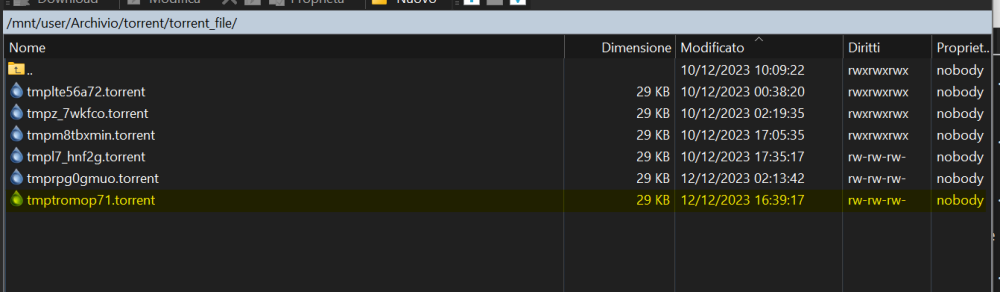

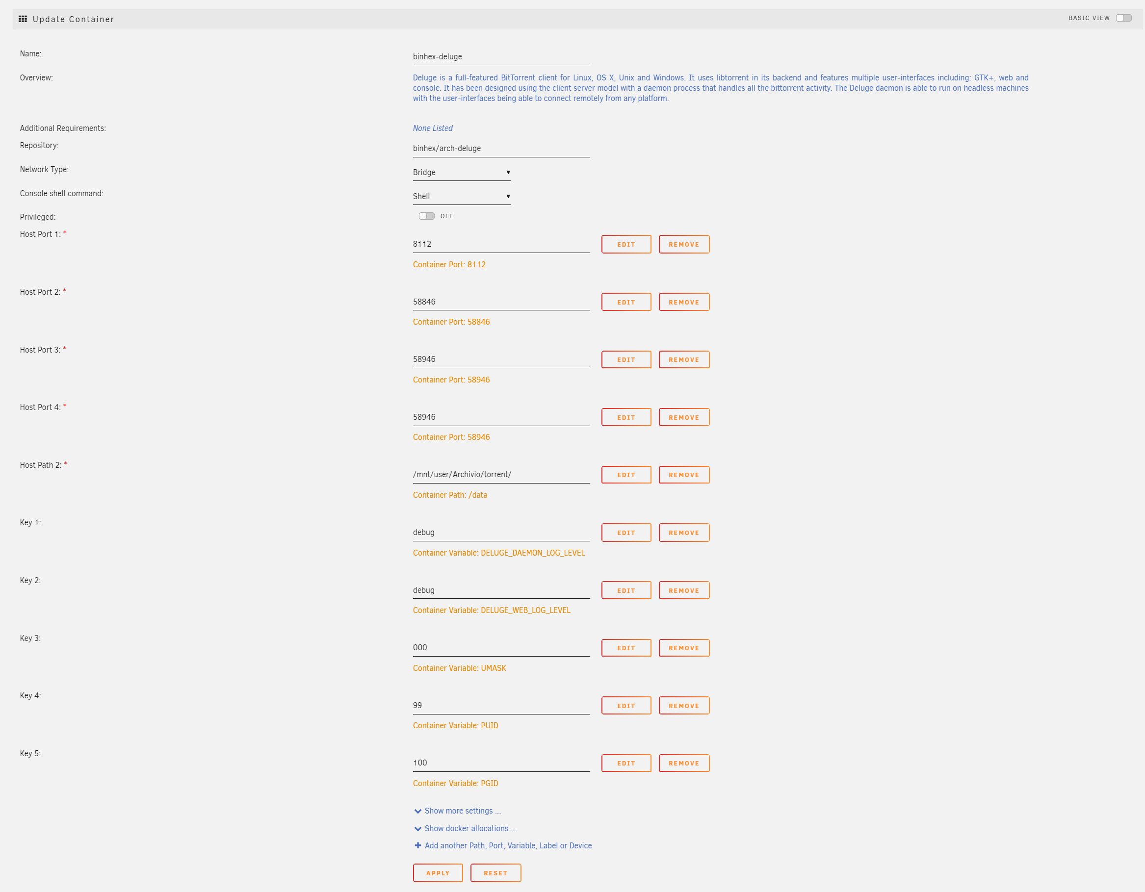

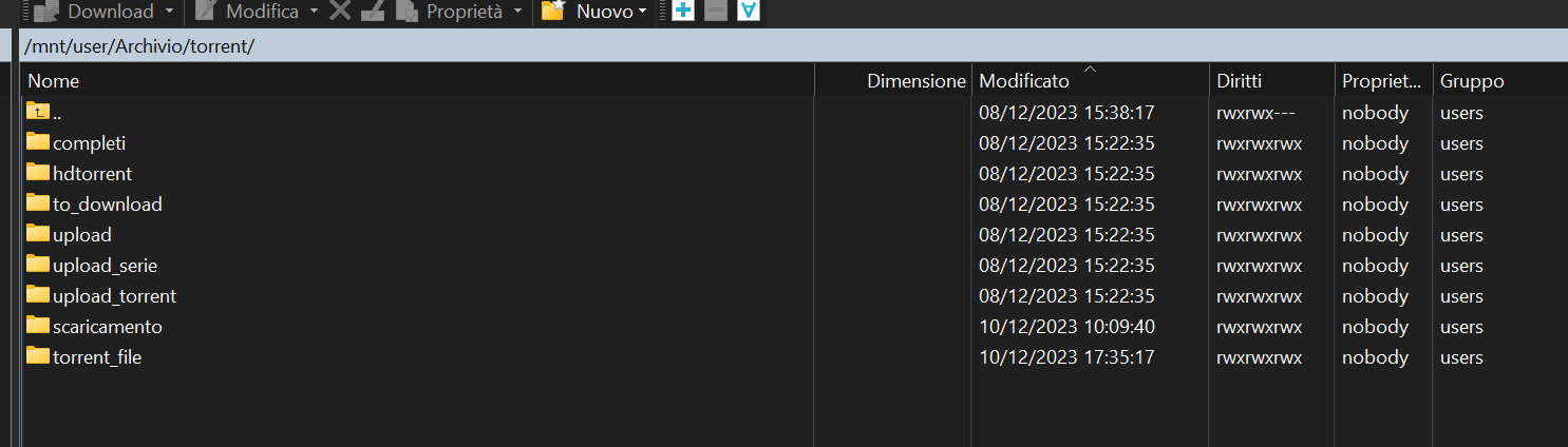

Hello everyone.
I am setting up the new NAS with UNRAID. It is a "small" machine with low power consumption. I opted for a machine with a lot of cache (2x4T in raid1) 4Tb to allow the disks to stand-by as much as possible
The machine is this one and I installed these dockers
With some swearing I get all the dockers working but deluge

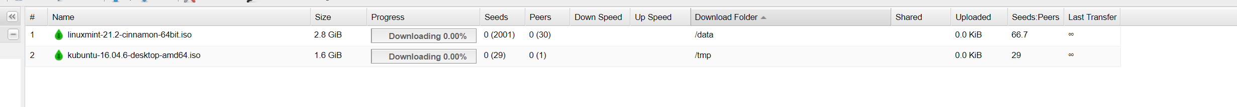

seems to work perfectly but the download of any file remains at 0 (image 2)
I check the paths ... all fine

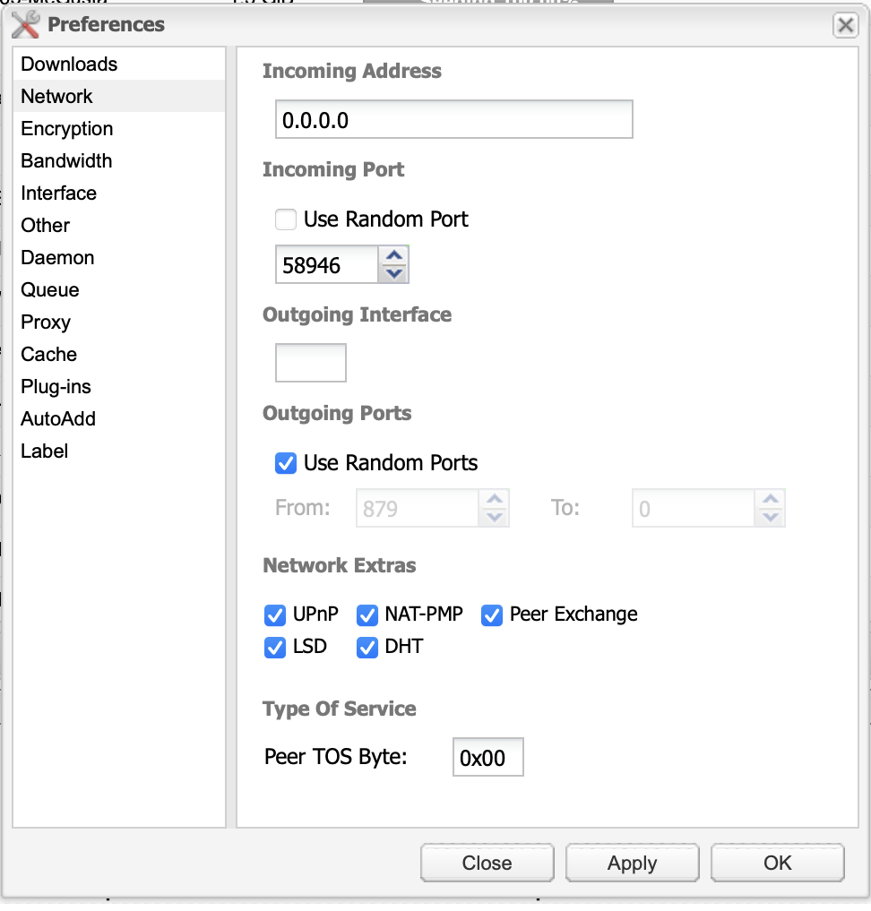

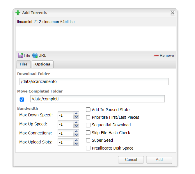

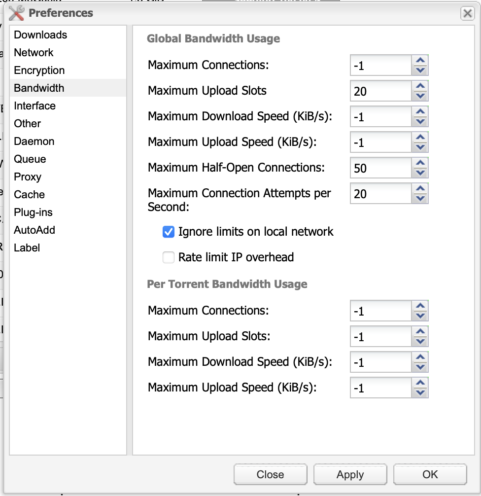

(image 3-4-5)
Especially since the file ".torrent" is written in the correct folder ... so ... it's all correct isn't it!?!
I set the docker log level to debug and there is absolutely nothing
supervisord.logdeluge-web.logdeluged.log
Guys I don't know what to do anymore.
Thanks in advance
so on the unraid host do you have a path /mnt/user/Archivio/torrent/scaricamento ? because that is what you have in effect defined in deluge web ui by specifying /data/scaricamento, same question for /mnt/user/Archivio/torrent/completi
i see the screenshots above but its not 100% clear whether these paths do exist or not.
A debug idea - temporarily set completed folder to /tmp (will cause the download to be written to the containers filesystem), if the download starts then the issue is path and/or permissions related.
In the meantime, thank you.
I confirm that the folders exist (in this image you can also see the absolute path)
I tried using the tmp folder.
I tried both setting the /data variable and the absolute path.
Always the same behaviour
is it possible there are some bugs?
should I try using an earlier version?
Thanks again

So here, port is opened, but as mentioned above, from time to time, I'm getting errored on tracker announce.
and here, after putting my server IP address, something is wrong with port:
If it's useful, here is my network config;
Can someone help me with this problem?
Any help would be much apperaciated.
Thanks!
Edited by rogales
The 192.x IP is not the IP to an interface the container has access to, normally you do not need to put an IP in this (particularly for docker containers) at all. This is generally only used for multi-homed (multiple interface) systems. Docker is not one of those systems.
You are basically asking to use an interface address it does not have, and thus are not getting any connectivity.

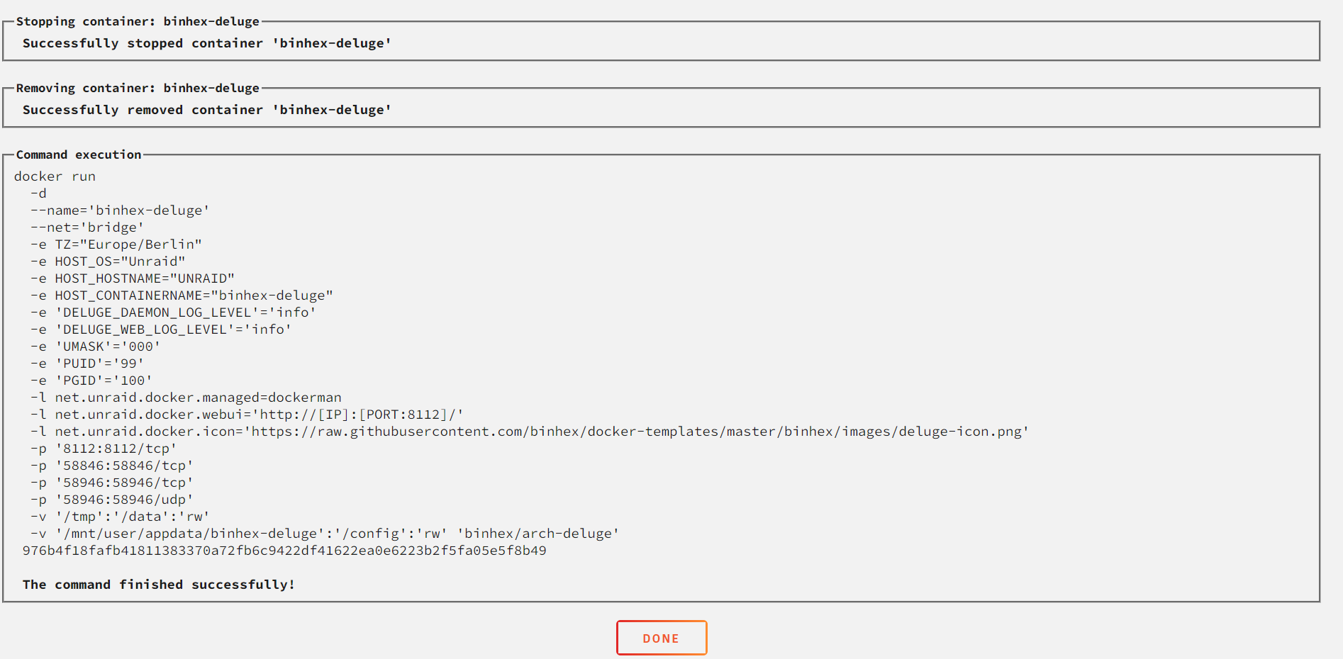

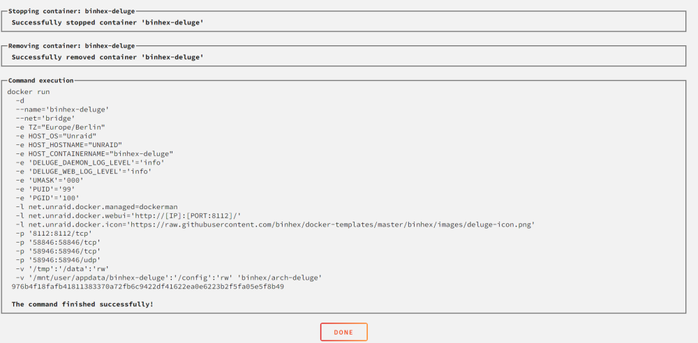

Hello, thanks for all your hard work maintaining this Deluge image. I have been a happy user until recently, my container stopped successfully starting up on my Unraid 6.12.10 box.
I've tried deleting and recreating the container from CA but I still get "bad parameter" on startup. In the detailed docker run log, I see:
docker: Error response from daemon: failed to create task for container: failed to create shim task: OCI runtime create failed: runc create failed: unable to start container process: exec: "/usr/bin/dumb-init": permission denied: unknown.
Is there something I am doing wrong here? Let me know what steps I should try or if I can provide any more info to help diagnose this. I've attached the log containing the full startup command.
binhex-delugevpn.log
