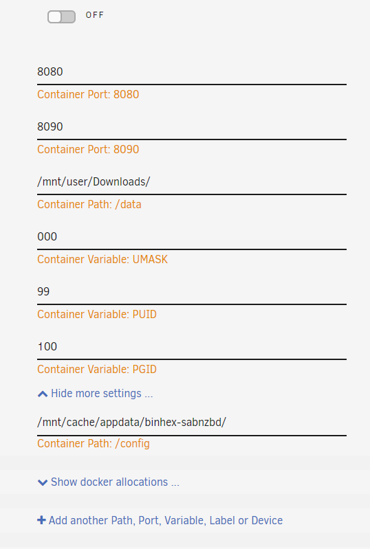

can you send me a screenshot of your unraid docker web ui for this container, left click the icon, select edit, toggle 'advanced view' top right and then screenshot and attach here.
Sure thing here you go. I basically deployed it with zero changes to the config except one which is that the appdata folder is on a unattached device SSD that I use for all my appdata folders for faster speeds.
Also one more thing I noticed later is that when I first install the SABnzbd docker it reloads to 172.17.0.2:8080 which is unreachable but then when I go to the correct IP on my network it works and asks me to configure.  I see this on my docker container main page:
Hope that helps thanks for looking into it :)

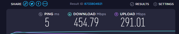

Second seperate issue so I made a second post but I have been unable to see speeds above 30MB/s with this docker and my old Freenas setup with sabnzbd (not your version just a standalone app on a ubuntu 16 server) was almost always between 80-90MB/s. Is there any reason for that?
Test transfer to the system from my PC upstairs
Test download through sabnzbd
Speedtest of network (with tons of stuff running not clean)

yep you def do have permissions issues, note the directory listing shows user 'root' group 'root' is the owner:-
whereas the container is configured to use PUID value of 99, which equates to user 'nobody' and PGID of 100, which equates to a group name of 'users'.
so to fix this stop the container, then delete the file /config/perms.txt and then start the container, this will reset permissions for this container only to the correct values.
