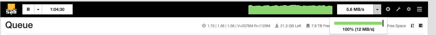

I configured my SABnzbd docker yesterday in unraid 6.8.1. And put a test download on it.
Previously, I have had a Win10 VM running SABnzb client, and I have been getting very high throughput (10-11 MBps on a 100/40 Mbps fibre link).
In docker, it usually goes upto 6.5 MBps and rarely ever touched 9-10 MBps.
I have paused the downloads in docker to run downloads through VM, so we know its not connection bottleneck. And I noticed once again VM is able to touch 10-11 MBps.
What could be the reason ? Should I increase any assigned resources for the docker ? Sorry docker noob here.
EDIT My download folder is setup on the SSD cache disk.
I dont have any bandwidth throttling set in docker. See screenshots below.
