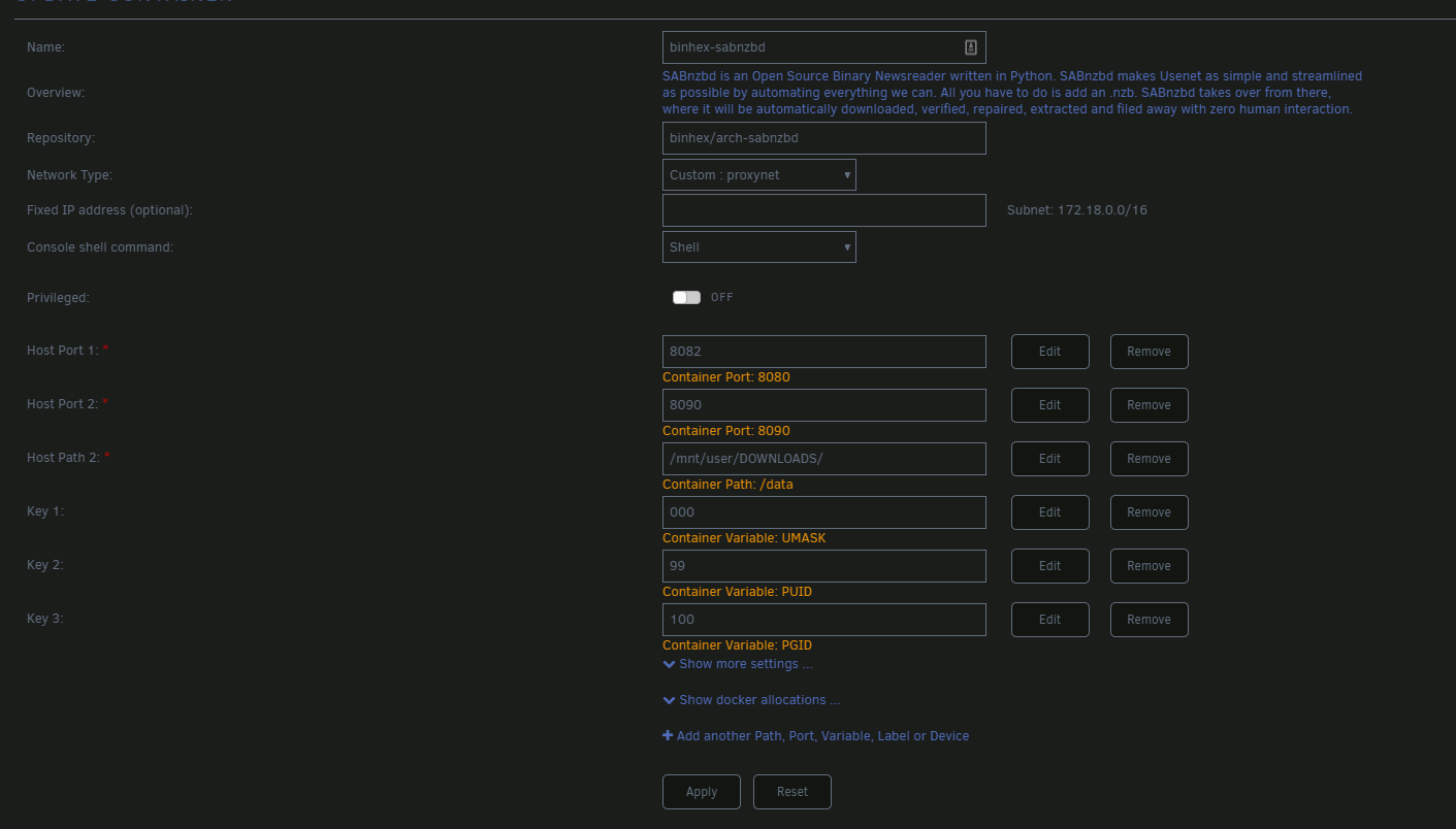

I am having an odd issue with Sabnzbd beginning this morning - I've had the same setup for months now with no issues. I keep getting the following error when trying to start up the container:
Error response from daemon: driver failed programming external connectivity on endpoint binhex-sabnzbd (48d3c0a31a0410c1aae7ccad21ad072b1641d1e7e137d80451110d8cada326a6): Bind for 0.0.0.0:8090 failed: port is already allocated.
I have tried many different ports and get the same issue and it is doing it for both ports. If I change one port it will give me an error on the other port. I removed the container and re installed and still get the same issue. I've checked multiple times and don't have any other services or containers running on these ports.
I am using port 8082 instead of 8080 and have had it setup this way for months now with 0 issues, then this pops up today.
I can't get to any logs because I can't even get the container started.
Any ideas?

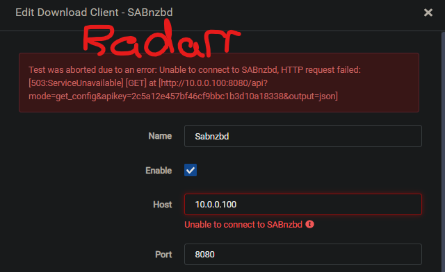

Sabnzbd has suddenly stopped talking to my Sonarr and Radarr for some reason. It was working for months before, nothing has been changed. My server running Unraid has an IP of 10.0.0.100
Radarr says "Test was aborted due to an error: Unable to connect to SABnzbd, HTTP request failed: [503:ServiceUnavailable] [GET] at [http://10.0.0.100:8080/api?mode=get_config&apikey=2c5a12e457bf46cf9bbc1b0000000038&output=json]"
some numbers in API key changed in case that is sensitive info
seems to be HTTP related but all my settings seem to be correct and have been the same. Any idea why suddenly sabnzbd cant be reached by anything? All dockers are the Binhex ones, and all are the most recent versions.
I also noticed if I change any values under SABnzbd, it forces me to restart, and once I do, everything is reset back to default upon logging back in. Not sure why. I was trying to turn off HTTPS to check. SSL is off on Radarr/Sonarr. I've also tried changing my API key and no changes.

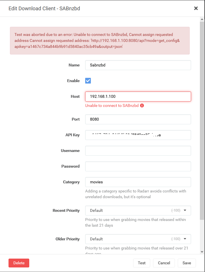

Hello. I have problem which recently developed. Both Radarr and Sonarr are reporting an error: Unable to connect SABnzbd. Lidarr is working fine with the same details for my SABnzbd server. Its been working fine, for well over a year actually, and I have not changed anything with the server.
In the host field I have always had my servers IP address (192.168.1.100) and port 8080 in the port field. But now 192.168.1.100, localhost or 0.0.0.0 all report the same message when I try to test the connection.
The log file has this error.
2021-03-08 12:23:05,405 DEBG 'sonarr' stdout output:
[Error] Sabnzbd: Unable to connect to SABnzbd, please check your settings
[v2.0.0.5344] NzbDrone.Core.Download.Clients.DownloadClientUnavailableException: Unable to connect to SABnzbd, please check your settings ---> System.Net.WebException: Error: ConnectFailure (Connection refused): 'https://localhost:8080/api?mode=version&apikey=a1467c734a844b9b91d5840ac35cb49a&output=json' ---> System.Net.WebException: Error: ConnectFailure (Connection refused) ---> System.Net.Sockets.SocketException: Connection refused

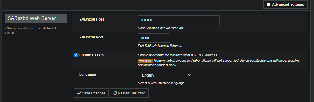

Having the same issue; and when I try to update/change SAB server settings (I think HTTPS getting enabled is the issue, as well as listening ip is back to 0.0.0.0) and hit save, Sab reboots and does not retain the settings, they revert to 0s and HTTPS
I tried unchecking "Enable HTTPS" however it does not work. It says the change will require a restart. However, when it restarts HTTPS remains enabled.

I forced the update on the containers of yours that Im running. Sonarr and Radarr still dont work, though Lidarr does. I have added the line --sysctl="net.ipv4.conf.all.src_valid_mark=1" to Sonarr's Extra Parameters field but the Sonarr container has now dissappeared from the list on the Docker tab. I have reinstalled the container but still get  the same message.
I edited the Settings-General-Proxy Settings of Sonarr's config to ignore my server (192.168.1.100). Still getting the same message.

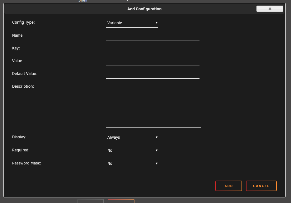

10 minutes ago, darrenyorston said:
As to Q27; where am I adding the VPN_OUTPUT_PORTS to? Am i adding a variable from the Sonarr docker template config page? This page?
the 'variable' is created for the vpn container, although unless Q27 applies then you probably will not require it, as you stated above you are only using a proxy right?, so you dont have multiple containers sharing the same vpn network, therefore ONLY Q26 applies for you.

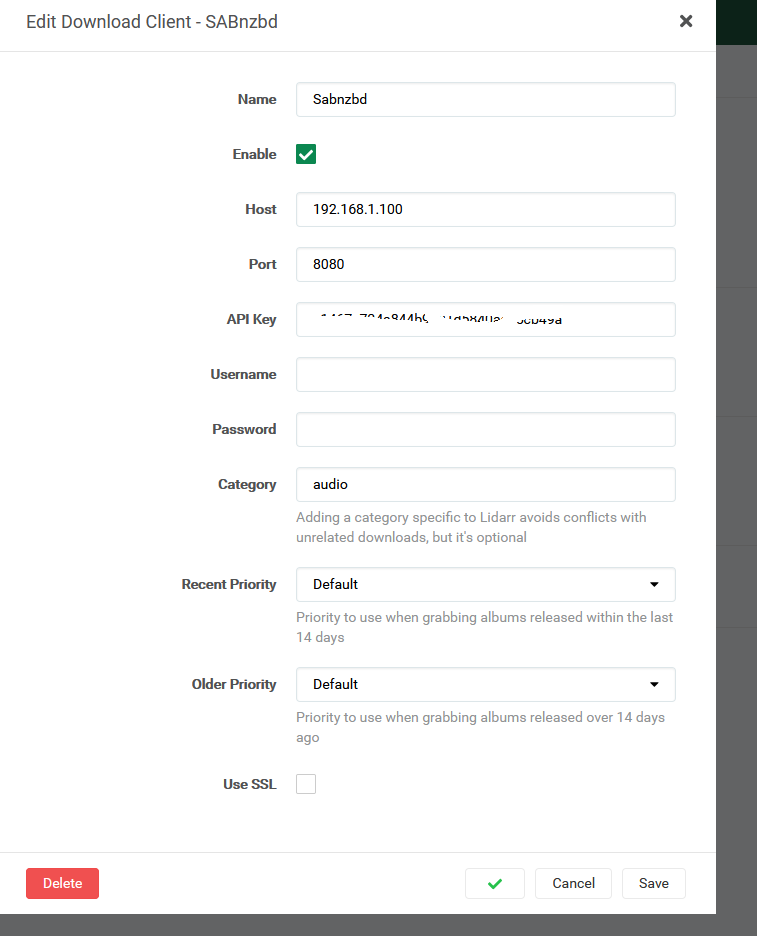

Im not sure if this will answer your question.
I have your delugevpn, lidarr, radarr, sonarr, and sabnzbd containers installed. I utilised Spaceinvader1's YT guide to set them up.
Deluge has my VPN enabled (PIA). Privoxy is also enabled though I have not set any browser or PC set to utilise it.
Sonarr, Radarr, and Lidarr all have SAB set as the Download Client. All three had the same SAB config. I made sure all three were the same. They have all been working fine. Lidarr still is, Sonarr and Radarr are running. I can access the UI on all. Lidarr still downloads fine. The others dont.
I attempted to fix the issue by deleting the Sab download client in Radarr's config. I have since attempted to re-add it assuming it may be corrupted in some way.Upon clicking "Test" I am shown the following screen.
To me this seems to indicate a problem with the hosts IP address. I have tried localhost as the address however receive the same error.

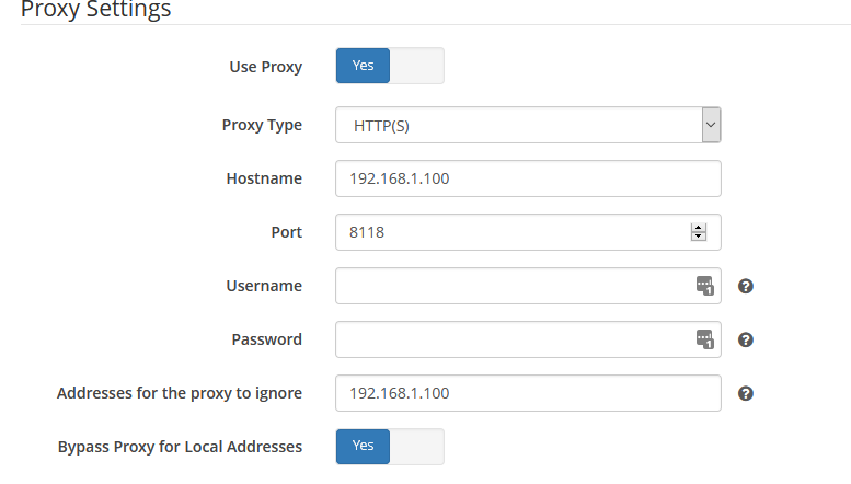

I have attached a picture of the Lidarr confg showing the test is successful. Also attached Sonarr proxy settings as requested.
Edit: So i noted Lidarr wasnt usign a Proxy, hence im assuming why its downloading. Turning off Proxy in Sonarr/Radarr and it works, test successful. With Proxy enabled I receive the error message.
So it seems to me there is a problem with the Proxy path, as it works (including downloading) when Proxy is set to off.
I have not edited my delugevpn container. When Radarr/Sonarr connect to SABnzb does it go through my VPN, as specified in deluge? Could this be why the test fails locally?
Edited by darrenyorston
So I think, think, I may have identified the issue. I was checking the VPN certs and I noticed I have two "binhex-delugevpn" folders in my app data. One has a "." after it. It doesnt have any OpenVPN details. I copied the same Open VPN files into it as is in the similarly named container and now it works. As a result I checked the container details and whilst the container name is "binhex-delugevpn" its AppData Config Path is "/mnt/user/appdata/binhex-delugevpn."
I changed the path to "/mnt/user/appdata/binhex-delugevpn", dropped the "." and now Sonarr and Radarr work with Proxy enabled. I have deleted the appdata folder with the "." at the end of the folder name.
