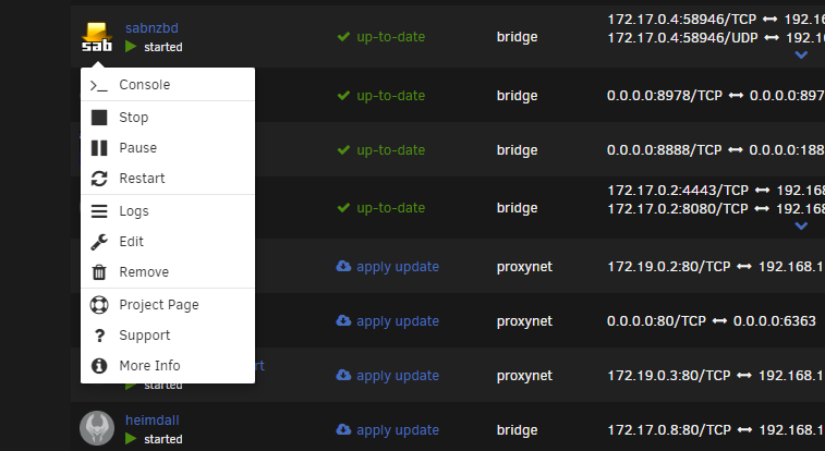

The docker menu doesn't show 'web ui' option anymore, only 'console', see picture.
You can access the web ui by browsing to the ip:port you configured, but the option is gone?

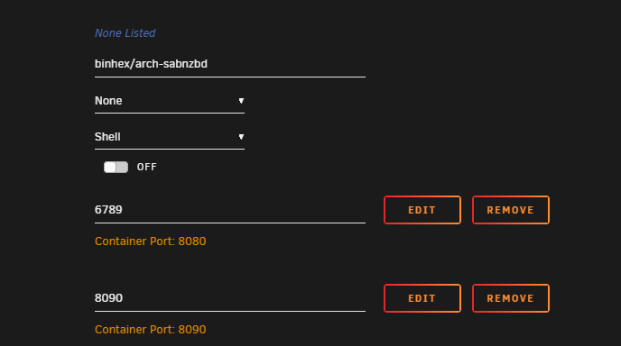

I have mapped my 8080 port -> 6789 to avoid a conflict with qbittorent, but it still runs on 8080.  When I look at the details I see:
8080 does indeed work, but why isn't it 6789 instead?
My fix was to move qbittorrent instead and that works perfectly.  Seems something is broken with this docker.
Edited by lovingHDTV
not at all, you just dont understand port mappings in docker, because this is running via 'bridge' network you only need to change the host port, the container port is left unchanged (and is hard coded in this case), this allows you run multiple containers as long as the host port is unique.
My network type is None as I run it through GlueTun or are you referring to a different network called bridge?
The default network type for this container is the default docker 'bridge' as can be seen in the unraid template, in this mode it works as i previously described.
If you are running this via a shared network such as gluetun or a vpn network from one of the vpn images i produce then you may then run into a container port clash if you have more than one container running on the same port inside of the shared network.
