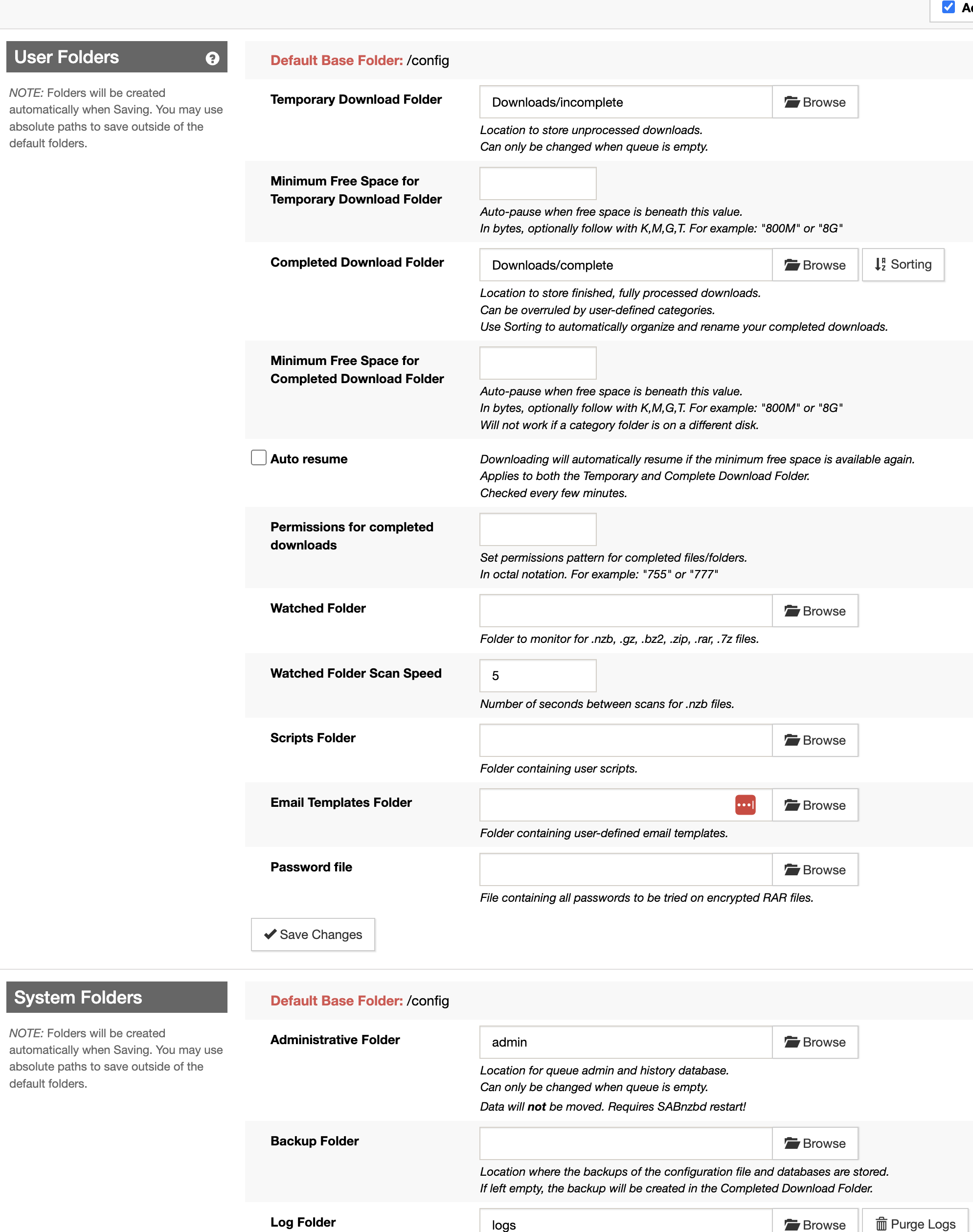

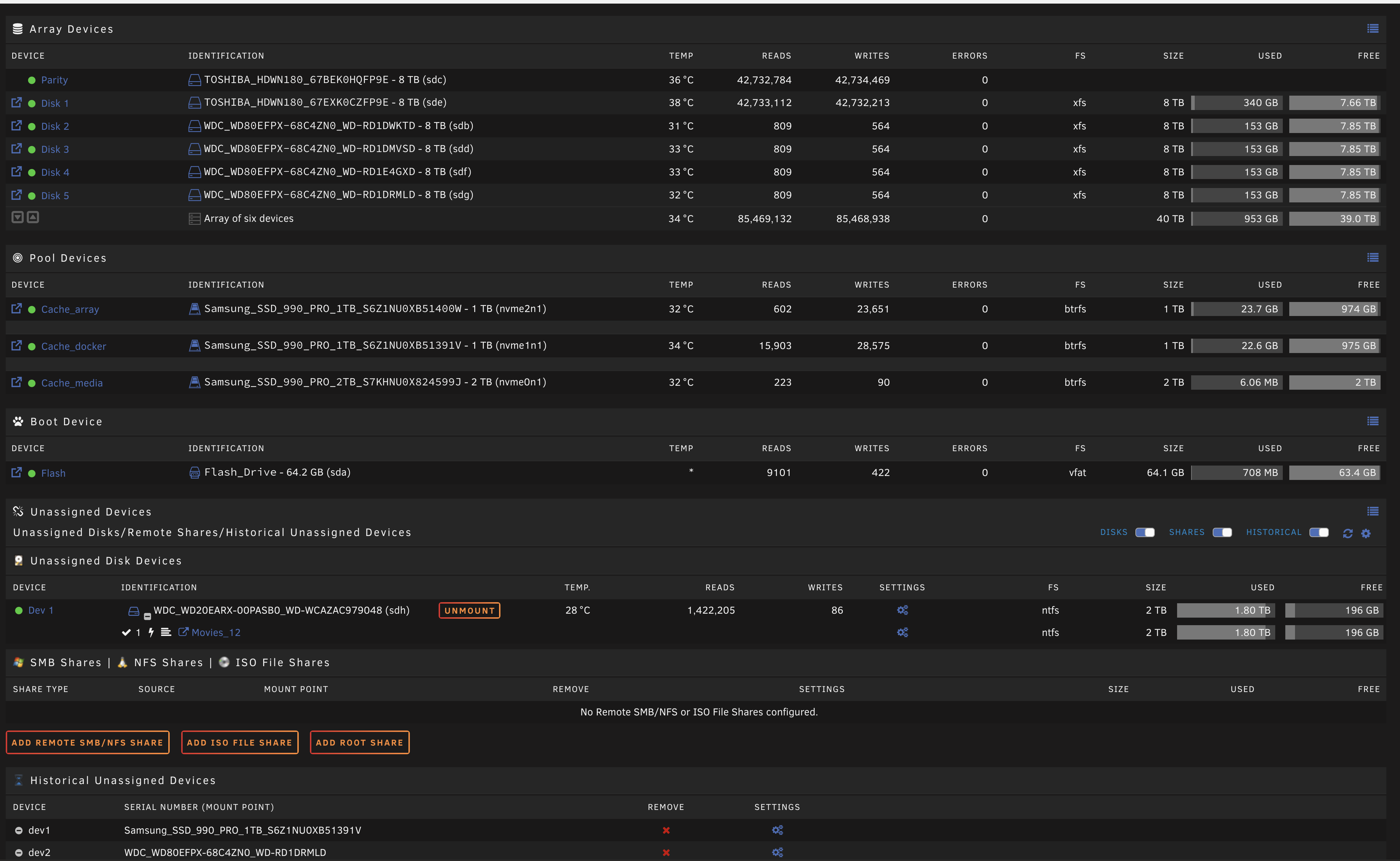

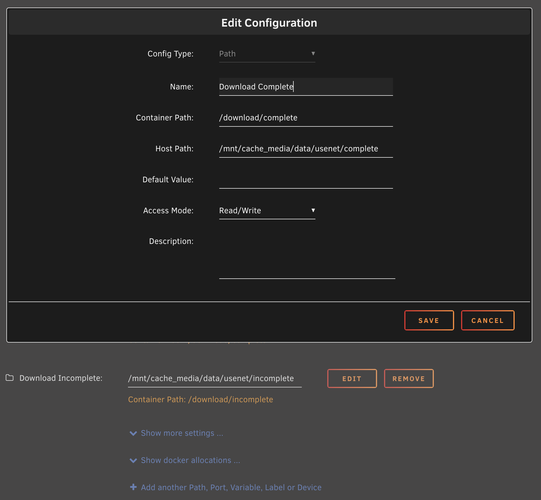

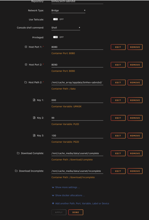

Sabnzbd with three Cache pools (Download location issue)
I have a new build and im brand new to unraid. Came from a 13 year old windows server 2008 & VM setup.
I have three drives configured as Cache Pools
1tb NVME drive called cache_array, which also stores app data for sabnzb and other apps when I add them
1tb NVME drive called cache_docker, which stores Docker & VMs
2tb NVME drive called cache_media  The goal was to use this as the place where usenet and torrents go. I set it up following trash guides for folder structures.

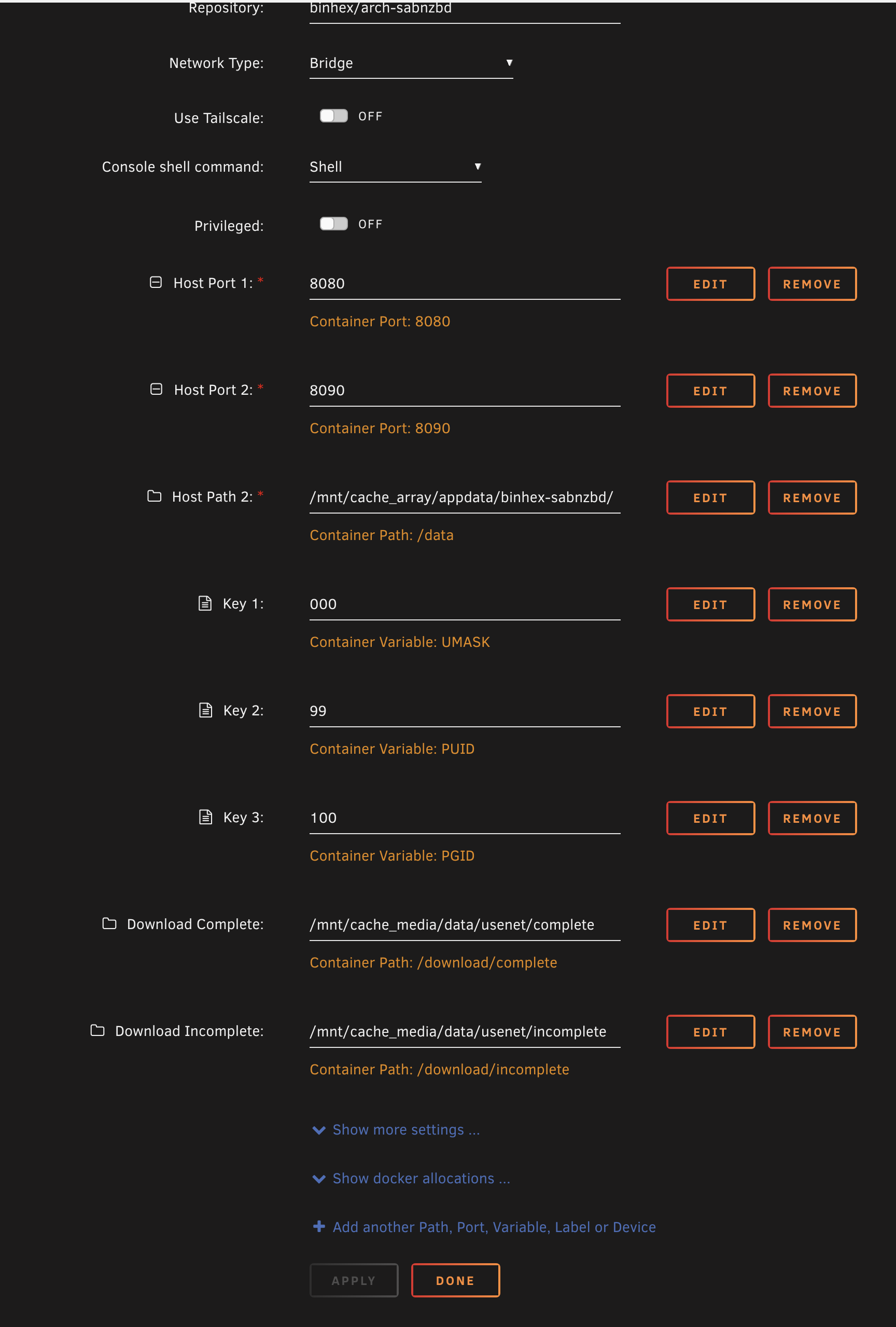

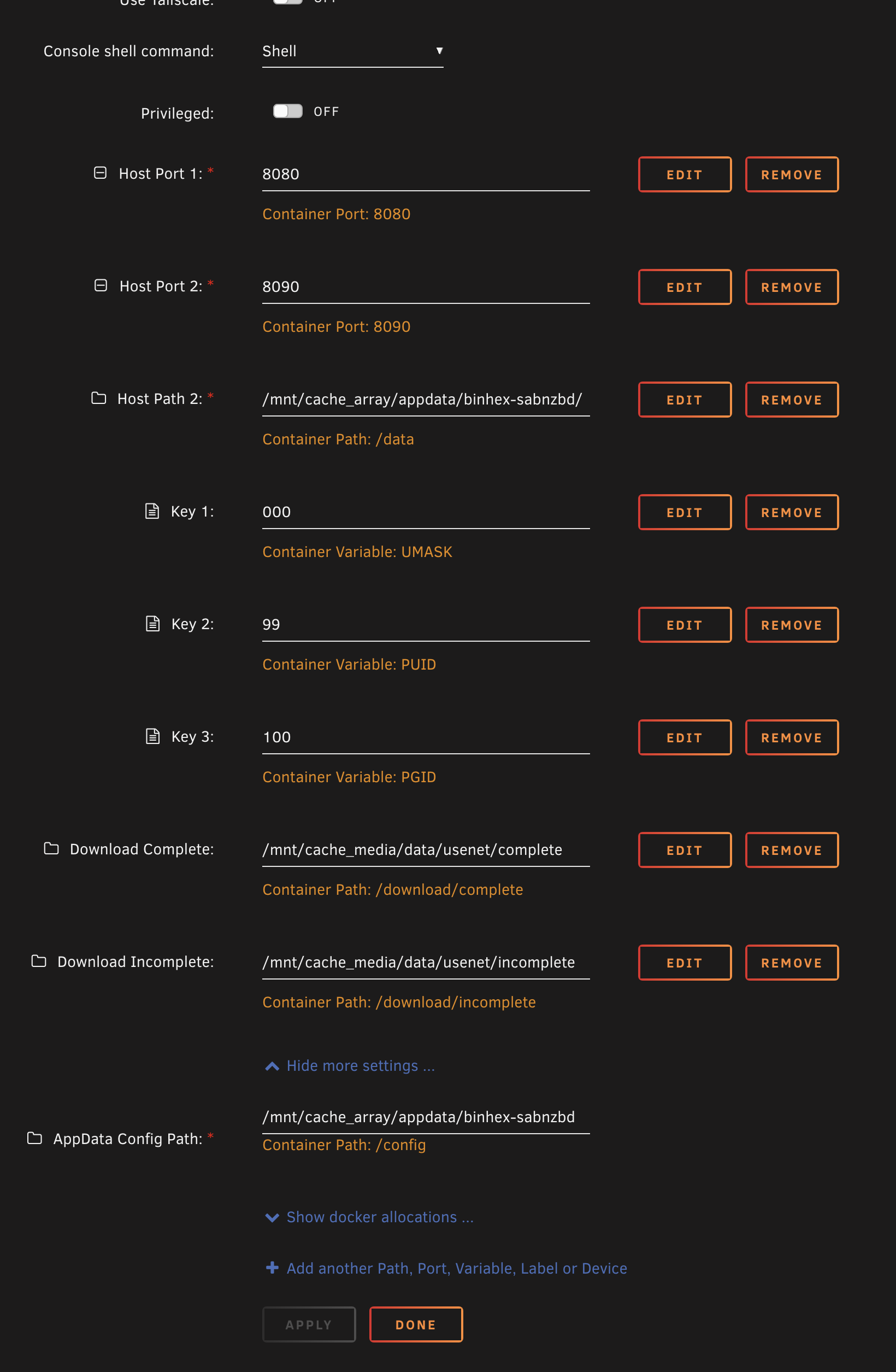

in the Sabnzb docker config
I have the following setup.
  Host Path 2: /mnt/cache_array/appdata/binhex-sabnzbd/
  Container Path: /data
I then added two paths
Download Complete host path: /mnt/cache_media/data/usenet/complete
Container Path: /download/complete
Download incomplete host path: /mnt/cache_media/data/usenet/incomplete
Container Path: /download/incomplete
When I start the Sabnzb docker and download a file its goes into /mnt/cache_array/appdata/binhex-sabnzbd/Downloads/complete  instead of /mnt/cache_media/data/usenet/complete.
What I want to do is have the 2tb NVME cache_media serve as a download cache &  location for usenet and torrents, id move to the array like once a week or month. I dont care if this data is lost.
Have the appdata on its own cache and dockers VM on their own cache
Cant for the life of me figure out how to get the data to go where I want, while appdata sits on another cache
What folder paths have you specified in the settings within the application? Post a screenshot
 Added screenshots to my post 👍

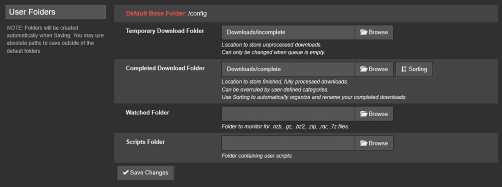

I also use multiple cache pools and custom mappings in sabnzbd and have it set that way to download to one disk but unpack to another disk (which is also the media cache for recent plex/jellyfin additions)
It works just fine for me so I suspect you have a typo or mis-mapped directory in there.
Do you have a screenshot of the Sabnzbd settings, in the 'Folders' page there are the internal directories for incomplete and complete, you need to ensure they are mapped to your new /download/complete and /download/incomplete correctly.
I just use the defaults, my understanding was by setting the host path under the container path would map it to the host path. Seems to work for the appdata cache drive. When im in Sabnzbd my only folder mappings are within the container. How do I tell Sabnzb to send the downloads to my host path Pool vs appdata pool where the sab download config lives?
Edited by iramckey
In the User Folders page of Sab, you have specified paths that are relative to the default base folder, so those paths are subfolders of /config. Also, you have specified Upper case folder names, linux is case sensitive.
What you need are paths like /download/complete and /download/incomplete.
In other words, the container paths you specified when you setup the container.

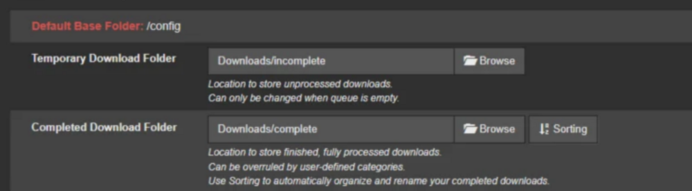

I changed the Sabnzbd paths to be all lower case. and the downloads are still going to cache_array instead of cache_media. I am wondering if the cache mapped to config has to be the same as the download folders? I looked and there is a 4th folder relating to /config pointing to the cache_array (Wrong one)
Edited by iramckey
you sure you are pointing to /download or is it going to /downloadS with an S...
Your SAB setup has the extra S...
That is not the only thing you needed to fix.
Look closely at the container paths you have specified. They all begin with / (as they must)
But in your User Folders, you have them not starting with /. That is exactly what makes them subfolders of the default base folder.
  Those settings in User Folders must match your container paths exactly,

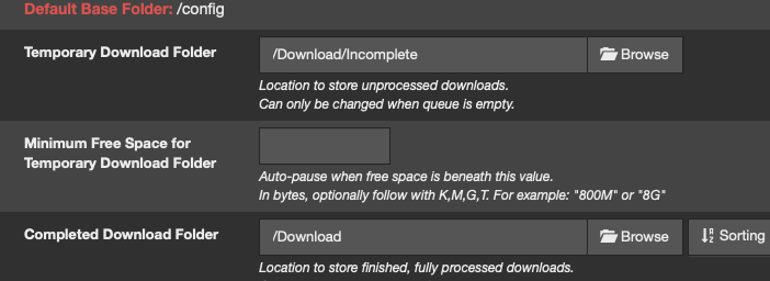

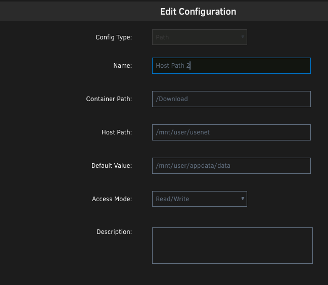

Hi all - I'm trying to get a minimum free space threshold set up, but the issue is that Sab is pulling my array free space rather than my cache free space.
In the Container options I have /mnt/user/Downloads set as the Host Path 2 (with the Container Path saying it's /downloads"; in the User Folders section of the app, it's set to /downloads/complete and /downloads/incomplete
I've looked, and the Downloads share of my array is set to move from Array to Cache, and everything in it is showing as being located in the cache.
Any ideas on a fix?
You sure you got that the right way around?.
If you have told SABnzbd to download to your array (which by the sound of the above you have), then the array free space will be what's shown. If you want to show free space on the cache drive then you will need to set the host path for downloads (i.e. /mnt/user/Downloads) to point at the cache drive, I would strongly advise you do this, unpacking files on the array will seriously bog down your entire server, not only that but it would mean you don't need to use mover to 'move from Array to Cache' (assuming that statement is correct).
I slightly misspoke above, but that note helped me fix the issue!
I did have it set to write to cache, and I've been monitoring that and know that it's working correctly.
However, I had the Array as my secondary storage in case I went over, and then had the Mover set to move stuff back from the Array to the Cache. Once I turned off secondary storage, everything's working as intended. With the limits set up in Sab, I shouldn't have an issue with accidentally over-downloading and running out of space, which is why I had set it up like that to begin with.
If that was dumb for a reason and someone wants to educate me as to why, I would appreciate it :D I'm still learning a lot here and always appreciate a chance to add to my knowledge!

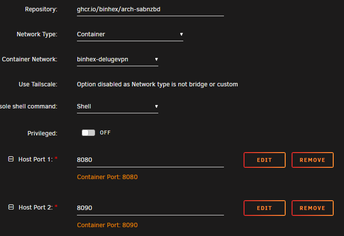

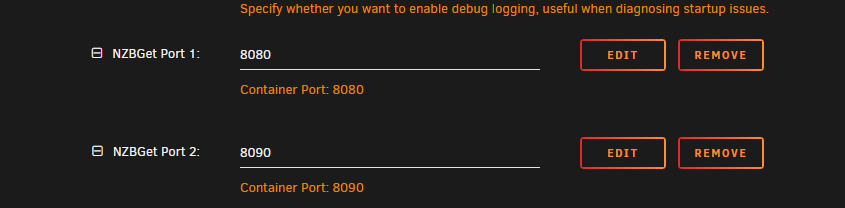

I'm having issues running this and binhex-qbittorrentvpn together. I have binhex-qbittorrentvpn running on port 8080 (default). I have binhex-sabnzbd set to use the binhex-qbittorrentvpn container's network. I tried changing the binhex-sabnzbd Ports 1 and 2 to 9090 and 9091, respectively. I also turned on advanced settings and switched the webgui URL to [PORT:9090]. However, when I go to http://<myip>:9090, I get nothing. I have ports 9090 and 9091 routed through binhex-qbittorrenvpn the same as Prowlarr, Sonarr, Radarr, and Flaresolverr (which all work fine) but I just can't access binhex-sabnzbd no matter what I do.
Is there something fancy I need to do to move binhex-sabnzbd to a different port? Or is there a better way to run both binhex-qbittorrent and binhex-sabnzbd through a VPN?
Thanks in advance for any help. :)
ok becaue you have both containers in the same network changing the host port will do nothing, the way out of this is to change the port that qbittorrent is using, not sabnzbd, as qbittorrent has the ability to change the container port and thus prevent the clash, to change the port see Q4:- https://github.com/binhex/documentation/blob/master/docker/faq/qbittorrentvpn.md
