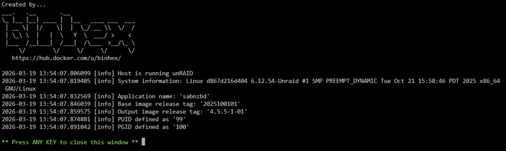

Hello, I am unable to start the binhex-sabnzbd anymore? It just refuse to start at all. There is no log entry, the latest log information was few hours ago when it managed to grab some nzb and now it just refuses to start.
This is what I got before shutting down and being unable to start it:
Log
2026-03-17 07:35:49,319 WARN received SIGTERM indicating exit request
2026-03-17 07:35:49,319 DEBG killing start-script (pid 80) with signal SIGTERM
2026-03-17 07:35:49,320 INFO waiting for start-script to die
2026-03-17 07:35:49,386 DEBG 'start-script' stdout output:
2026-03-17 07:35:49,386::INFO::[notifier:166] Sending notification: Warning - Signal 15 caught, saving and exiting... (type=warning, job_cat=None)
2026-03-17 07:35:49,386::WARNING::[__init__:202] Signal 15 caught, saving and exiting...
2026-03-17 07:35:49,390 DEBG fd 11 closed, stopped monitoring <POutputDispatcher at 22588245402768 for <Subprocess at 22588245721504 with name start-script in state STOPPING> (stderr)>
2026-03-17 07:35:49,390 WARN stopped: start-script (exit status 143)
2026-03-17 07:35:49,390 DEBG received SIGCHLD indicating a child quit
Edited by noax
Add the latest log entry before it stopped

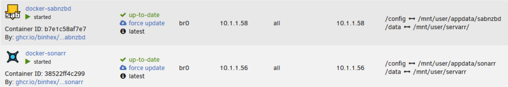

My files are not moved, they get stuck in "Waiting to import". I've been having issues with LSIO dockers for a while and decided to migrate to binhex for sabnzbd and sonarr. When adding a file through sonarr, it correctly gets downloaded by sabnzbd. However, nothing happens after. No errors in the logs. I doesn't get renamed and it isn't moved like it should. Both dockers use the same paths. I'd like to know how to properly debug this.
Here is an example:
root@server01:~# ls -l /mnt/user/servarr/usenet/tvshows/*/*
-rw-rw-rw- 1 nobody users 4947879278 Jun 29 02:57 /mnt/user/servarr/usenet/tvshows/House.of.the.Dragon.S03E02.Queens.Landing.REPACK.1080p.AMZN.WEB-DL.DDP5.1.Atmos.H.264-FLUX/House.of.the.Dragon.S03E02.Queens.Landing.REPACK.1080p.AMZN.WEB-DL.DDP5.1.Atmos.H.264-FLUX.mkv

As for the config:
Edited by dnLL
added screenshots
this is a classic mismatch on the download path, see Q4:- https://github.com/binhex/documentation/blob/master/docker/faq/unraid.md

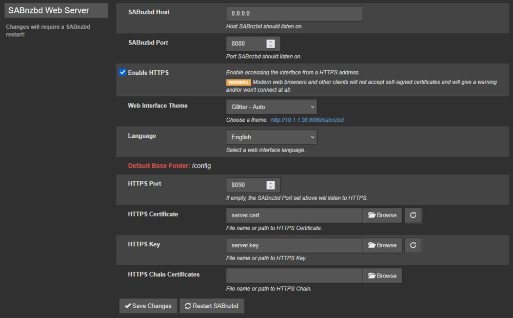

6 hours ago, dnLL said:
like because of the trailing slash? because the paths are identical otherwise
edit: the trailing slash didn't fix it
if you look at this screenshot i think your downloads are actually going to <default base folder> + 'Downloads/incomplete' or to give you the full path: /config/Downloads/incomplete
which is not what you want, so try specifying the full path in the Temporary and Completed Download folder fields i.e. /data/Downloads/incomplete and /data/Downloads/complete you should then have your downloads end up in the right place and sonarr will then be able to pick it up.
Ah, yes, those are artifacts from my old LSIO config I guess. So, I changed it to absolute paths in /data rather that relative paths which were in /config. However, that doesn't help. It's like sonarr doesn't receive the notification from sabnzbd or doesn't know where are the files located?
Just did a new test with a different release and it worked... I'm so confused.
Edit: yeah, seems like I was testing with a bugged release lol, everything else is working. Oh well. Thanks for your help!
