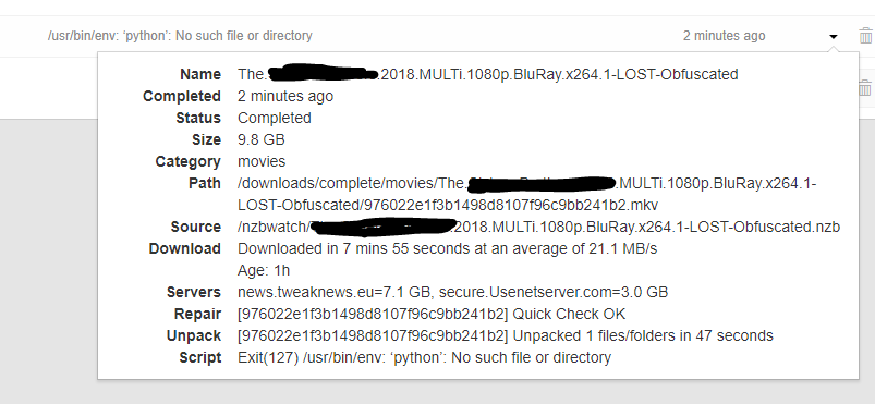

My unraid setup has been solid for months now and I've made no changes at all.  Since 1/3/2019, I now see this error on the main sabnzbz webgui for each download,     /usr/bin/env: ‘python’: No such file or directory
I looked and the file downloads fine and extracts.  The tv show file is in the directory, yet the script errors out with
Exit 127   /usr/bin/env: ‘python’: No such file or directory
I've been working with Clinton Hall to troubleshoot why the nzbtomedia script started failing and we have found that due to recent updates, we now need to link Python to Python2.
To temporary fix this, I had to ssh into a terminal inside the sab docker and run this command;
ln -sf /usr/bin/python2.7 /usr/bin/python
While that resolved the issue and I no longer get any errors, this fix will be reverted with your next update.  To test this part, I did a Forced Update for this docker and it broke the link.  I once again had to ssh in and link python again.

hmm this is going to be an issue, as this container requires python3 for system tooling (such as pacman) and obviously requires python2 for sabnzbd. there is already a symlink in place for /usr/bin/python which softlinks to python3, see here for output from console:-
sh-4.4# cd /usr/bin
sh-4.4# ls -al py*
lrwxrwxrwx 1 root root     6 Oct 22 11:41 pydoc -> pydoc3
-rwxr-xr-x 1 root root    78 Jun 27  2018 pydoc2
lrwxrwxrwx 1 root root     8 Oct 22 11:41 pydoc3 -> pydoc3.7
-rwxr-xr-x 1 root root    78 Oct 22 11:41 pydoc3.7
lrwxrwxrwx 1 root root     7 Oct 22 11:41 python -> python3
lrwxrwxrwx 1 root root     9 Jun 27  2018 python2 -> python2.7
-rwxr-xr-x 1 root root  5920 Jun 27  2018 python2.7
-rwxr-xr-x 1 root root  1681 Jun 27  2018 python2.7-config
lrwxrwxrwx 1 root root    16 Jun 27  2018 python2-config -> python2.7-config
lrwxrwxrwx 1 root root     9 Oct 22 11:41 python3 -> python3.7
-rwxr-xr-x 2 root root 14096 Oct 22 11:41 python3.7
lrwxrwxrwx 1 root root    17 Oct 22 11:41 python3.7-config -> python3.7m-config
-rwxr-xr-x 2 root root 14096 Oct 22 11:41 python3.7m
-rwxr-xr-x 1 root root  3225 Oct 22 11:41 python3.7m-config
lrwxrwxrwx 1 root root    16 Oct 22 11:41 python3-config -> python3.7-config
lrwxrwxrwx 1 root root    14 Oct 22 11:41 python-config -> python3-config
lrwxrwxrwx 1 root root    10 Oct 22 11:41 pyvenv -> pyvenv-3.7
-rwxr-xr-x 1 root root   435 Oct 22 11:41 pyvenv-3.7
so im loathed to change the existing symlink as it could/will break system tooling, and whilst you have got away with it by overwriting the existing symlink this isnt something i really want to do.
instead there are two options for you to consider:-
1. edit the script and point at /usr/bin/python2 (e.g. #!/usr/bin/env python2)  - this then allows you to be more explicit as to what version of python the script uses, as opposed to relying on the premise that the only version of python on the system is python2 and that its symlinked to /usr/bin/python.
or
2. update the script to use python3 - python3 is the future, and at some point the developer of the script will have to support python3 as more people move over to it, if this was re-written (i know its a lot of work) then it would just work with the existing symlink (which currently points at python3).
Edited by binhex

@binhex
Sorry for the confusion created. The nzbToMedia script was recently made python3 compatible, this is why we changed from calling python2 to python.
So there should be no issue if python already exists and point to python3.
The reason for Switchblades request for the symlink is that we thought "python" didn't exist. Initially on update of the script, the script failed to run (I believe the issue is that if failed to run within unraid and NOT within the SABnzbd docker). So if it does we don't have any issue. I took me a longtime to figure out the difference between the SABnzbd Docker environment and the root unraid environment.
@Switchblade
Please test the script after resetting the link to python3
via terminal into docker
ln -sf /usr/bin/python3 /usr/bin/python
Edited by clinton.hall
@clinton.hall
Ok, I went back into the terminal inside the sab docker and ran that command.  I then sent a dl to sab, and it failed - just like it did before we changed the link to python2.  Below is a test dl.  The file dl's and unpacks, then runs the script, but fails when it can't find python.
When I put it back to what we tested,  ln -sf /usr/bin/python2.7 /usr/bin/python    It works again.
I can also repeat this testing by just doing a Forced Update for this docker container, which puts it back to python3.  After the update, I have to go back into the terminal inside the docker and link it to python2.7
Just for the record, my unraid is most stock, very little custom stuff.  I only have a few dockers and all but one are Bin-hex and again with no custom stuff.  I just install and they work.  :)  I also have Nerdpack installed, but again only a few packages are installed.  Both python2.7 and python3 are installed and up to date.
I'm curious what we do next....
in the docker, can you show the output of the following?
cd /usr/bin
ls -al py*
which python
@clinton.hall
Here you go:
root@Tower:~# docker exec -it binhex-sabnzbd bash
[root@Tower /]# cd /usr/bin
[root@Tower bin]# ls -al py*
lrwxrwxrwx 1 root root   18 Jan 18 15:41 python -> /usr/bin/python2.7
[root@Tower bin]# which python
/usr/sbin/python
[root@Tower bin]#
ok, that's the issue... you can't link python3 since it isn't there!
If the docker contains python3, nzbToMedia will work with it, but the version you have is not showing a python3 install.
@clinton.hall  Ok, thank you again for your help.  So I have python3 installed via nerdpack at the unraid server level.  But from what you are saying, the sab docker container should also include python3 - but for some reason it is not?
@binhex  I have already did a Forced Update so I should have the latest version.  Also keep in mind that I  did a fresh install about 10 months back.  How can I fix this issue and do you know why python3 isn't showing up inside the sab docker container?
ok thanks guys, so my bad i was looking at sabnzbdvpn which DOES include both python2 and python3, however the straight sabnzbd (no vpn) only includes python2, so i need to include python3 for your script to work, got it. i just need to do some testing to ensure this isnt going to screw up sabnzbd - which it shouldnt as it works just fine with both for sabnzbdvpn BUT sods law dictates if i dont test it then it will break :-).
Edited by binhex
@binhex  Thank you so much!  I installed and tested the couchpotato script and that worked!  I think we're good to go.
I'm now waiting for a tv show to dl to test the sickbeard script.  I'm all caught up so nothing to dl just yet.  I'll confirm back once the sb script runs.
Thanks again for the speedy response!
Update:  @binhex  - I have confirmed that both sb and cp scripts are now working.  😀
