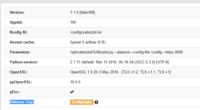

Thank you it works! However 7zip is missing. See attachmet. Can you fix it?

just so you know, this did get released and ive built the image so its now available.
fixed, please pull down the latest image.

Hi, is it possible to update Sabnzbd to version 1.2? :)
