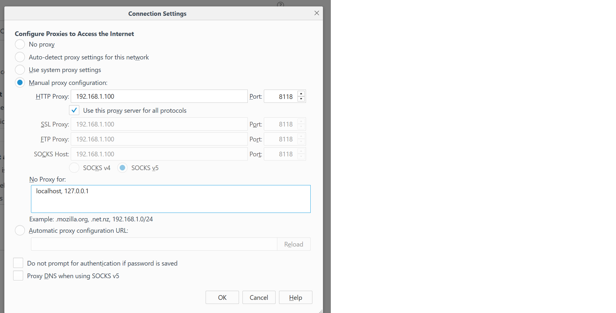

13 hours ago, Greygoose said:
No connection when setting proxy through browser. :/
stupid question, you have set enable_privoxy to 'yes' right? also can you post a screenshot snippet for how you defined the configuration for the proxy in your browser.

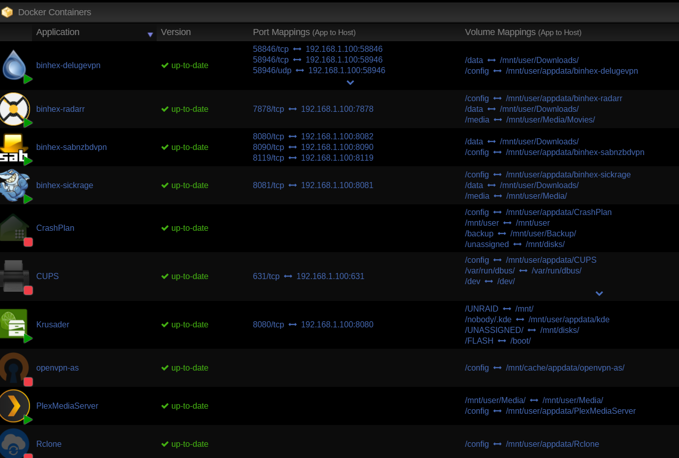

This is in FFox
I have enabled Privoxy in SabVPN.  I have spent hours trying things :/
1 hour ago, Greygoose said:
This is in FFox
ok that looks ok to me, so just to confirm you can now access sabnzbd web ui with the vpn enabled im assuming right?.

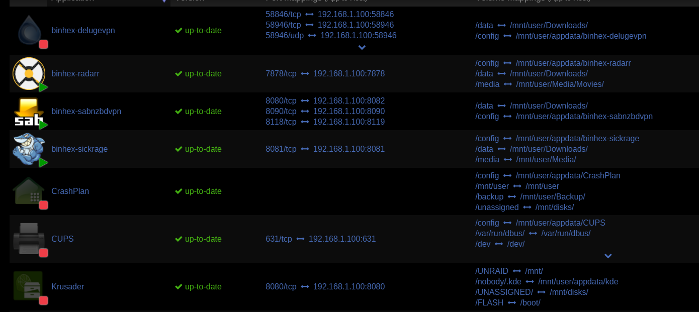

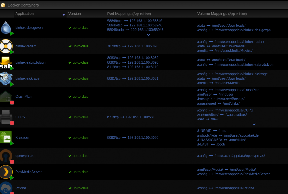

also can you go to unraid/docker tab and enable advanced view and screenshot snippet just the sabnzbdvpn line, im particularly interested in the port mappings.
edit - this bring back any memories? :-) :-) hint hint you changed the port from 8118 to 8119
Edited by binhex
binhex..
Dude,, sorted it. You was right i did change to 8119...
I did a restart of the server and i changed eveything back to their respective ports and it works :D
I think the restart must have helped, as i had changed so many things with the ports it was causing issues somehow. a restart seems to have sorted it, proxy works in the browser :D
Thank you mate, also thank you jonathanm for your time... its most appreciated..
Oh and i am using delugeVPN as the privoxy as opposed to the SabVPN :D
Unless you can see anything that needs changing in the image above, i am happy.

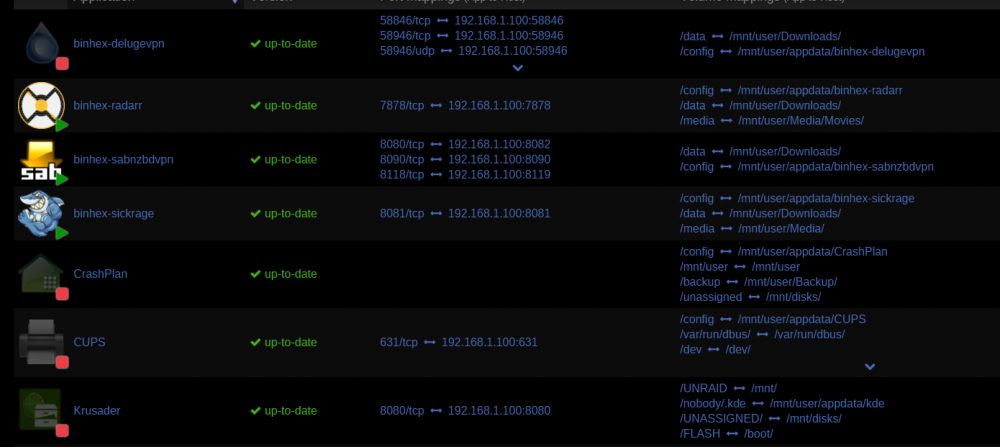

yes i do see one issue, although its not really a problem for you as your using privoxy from delugevpn, but worth mentioning, you shouldnt be changing the port on the container side, this is the golden rule for ALL docker containers, you should always just change the port on the host side only, so from your screenshot for sabnzbdvpn i can see you have set the port for privoxy from 8118 to 8119 on the host side (which is fine) AND the container side (not fine), up to you if you fix it.
When i change the Host Port 3 to 8118 it clashes and fails due to deluge using it,  I thought that was the host side i am allowed to change :/
When i change the Host Port 3 to 8118 it clashes and fails due to deluge using it,  I thought that was the host side i am allowed to change [emoji32]
Read that post again :-)
