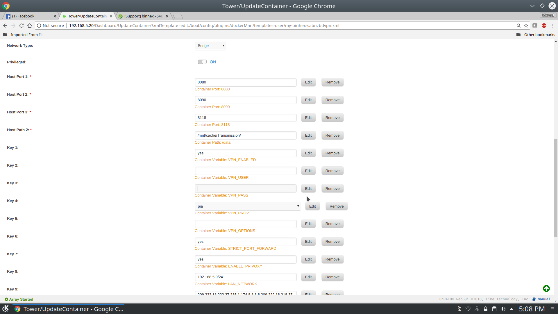

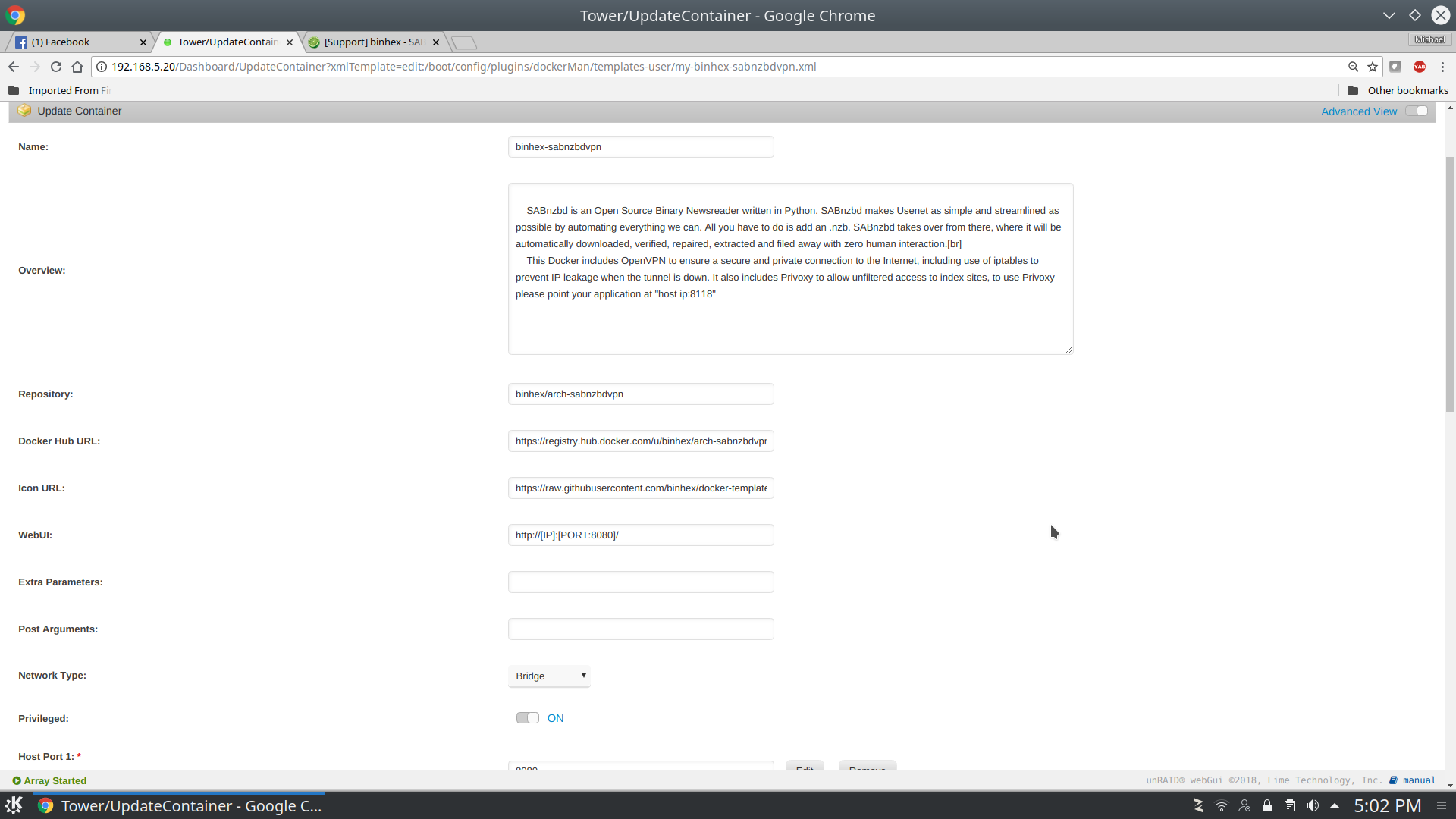

I figured i was probably working from an old template, which is why I just nuked the whole thing, including the previously installed apps in community applications, and tried to start as 'from scratch' as I could.  When i first did this, there was a variable in the template where I could just enter the server I wanted
if you are still seeing a env var for the vpn endpoint then you are still using the old template, so you would need to Add container, select template you want to delete, after selection a red circle with a cross shows up next to the template name click on it to delete the template, once you have done this then re-add it using CA and you will then get the correct template downloaded, just to show you what it should look like, see here for the raw xml:-
https://github.com/binhex/docker-templates/blob/master/binhex/sabnzbdvpn.xml

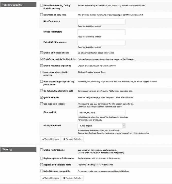

I'm having lots of issues with renaming/moving completed downloads now.
I suspect I've not gotten the new SAB install finished correctly, since I dont' think I've changed Sonarr lately, and this all started after I had to reinstall SAB.
Now, after downloading an nzb, SAB shows it's completed, no errors.  Sonarr shows the show still in the download queue as if it's still downloading.  I can live with this, but I'm also seeing garbage names of files, and they are not being moved to the correct location any longer.  I've gone thru and checked all the settings I can think of related to this, and all seems well.
I'm not sure if anyone else has had similar issues, or has an idea where to try to resolve this, but I'm stuck and frustrated at this point.

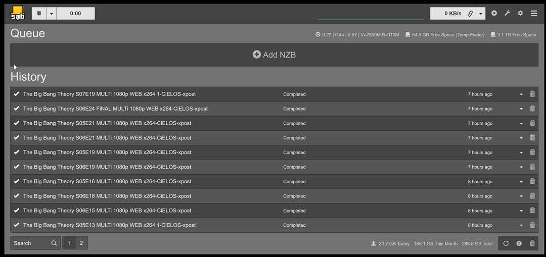

Here is a shot showing the completed downloads in SAB...

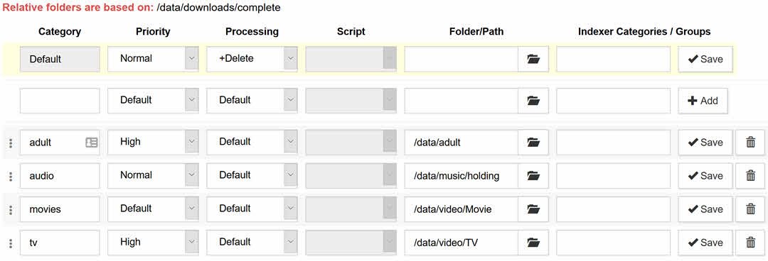

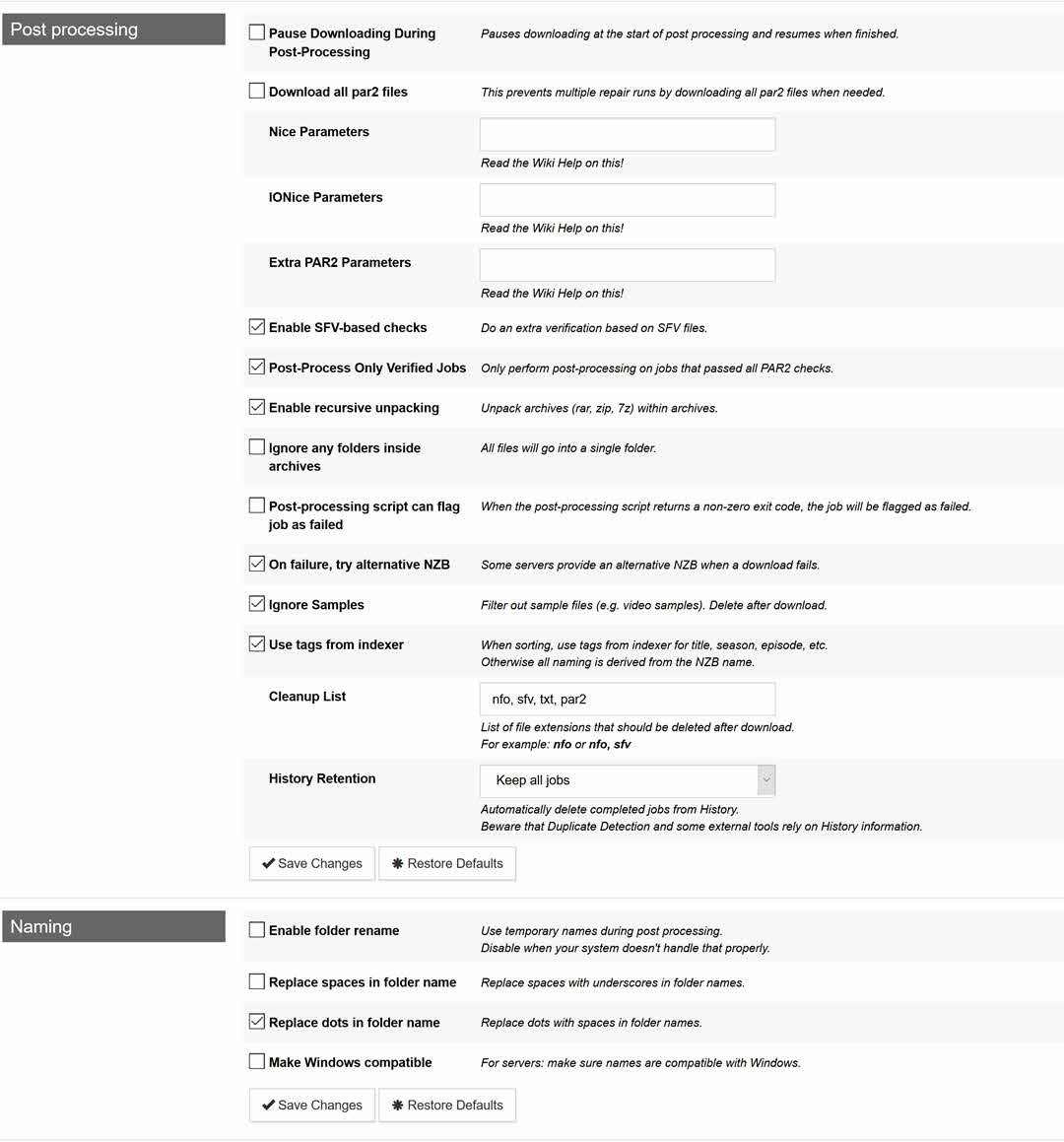

Here are my SAB settings that I think relate to this.  I also have all 3 sorting options unchecked, so SAB should not be touching these.

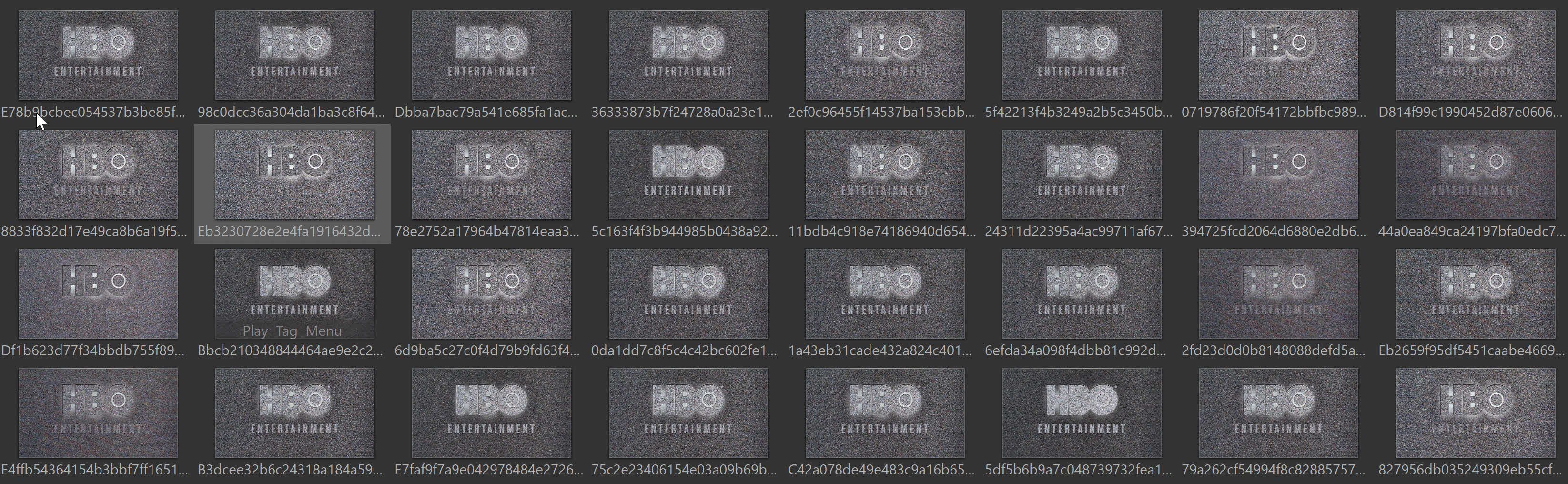

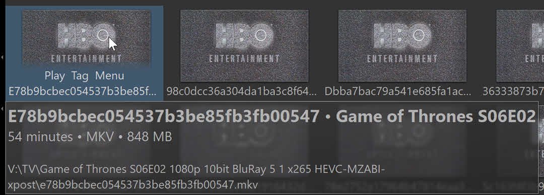

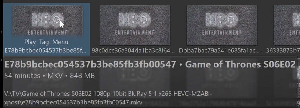

Here is a shot of a bunch of new Game of Thrones downloads that recently finished, notice the names of the files
And another screenshot showing the folder location it was moved to...

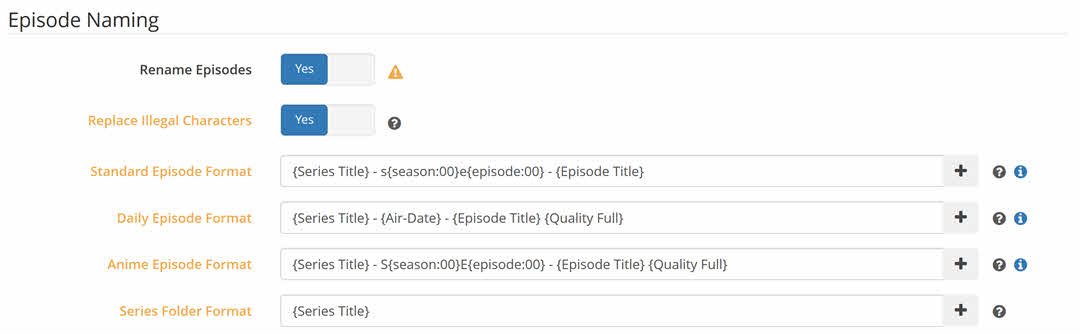

Here are my Sonarr renaming settings (which still seem to work just fine for Deluge)...

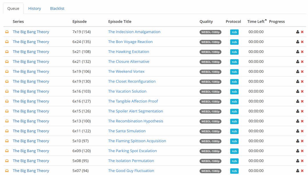

Here are the completed NZB files as they display in Sonarr as unfinished...
