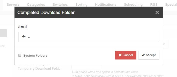

I just started with docker and have a question.
How can I set my DL folder to /mnt/disk7/UsenetDL?
I don't see it in SABnzbd > Config > Folders...
Because I am now downloading to /config/mnt/disk7/Usenet DL/{Nzb name}
And I get this error: "download_dir directory: /mnt error accessing"
Sorry but I am not experienced with docker...
Rikdegraaff, have you mapped the /mnt/disk7/UsenetDL folder in the SABnzbd docker?
106938531_2018-07-0818_37_29-EllisMediaServe_UpdateContainer.png.bb0439b342043657b1bb9e83070de3aa.png
In the example above, you would reference /data to get to the /mnt/user/Downloads folder. By mapping the folders, you don't reference the actual folder path. You can replace the Downloads folder with the path you listed (/mnt/disk7/UsenetDL)
Thank you Stanley for your reply.
I have now altered the /data path to /mnt/disk7/Usenet DL.
And now it comes in /mnt/disk1/docker/appdata/binhex-sabnzbdvpn/\mnt\disk7\Usenet DL\incomplete.
I want it to download in disk7/Usenet DL.
How do I do that?
I get this by searching for a folder.
Edited by rikdegraaff
Typo
In the image you provided, the completed download folder should be /data, not /mnt. If you click on the left arrow, you should go to the parent folder, and see the /data listed in there. Select /data, and you should be good to go.
I understand it now.
/data is "mounted" in the settings to "/mnt/disk7/Usenet DL".
Got it now and it works!!!!
Thank you Stanley!!
