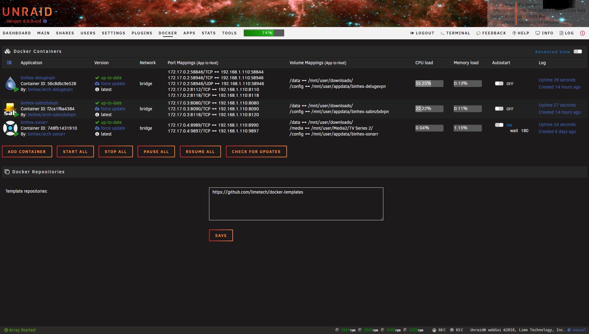

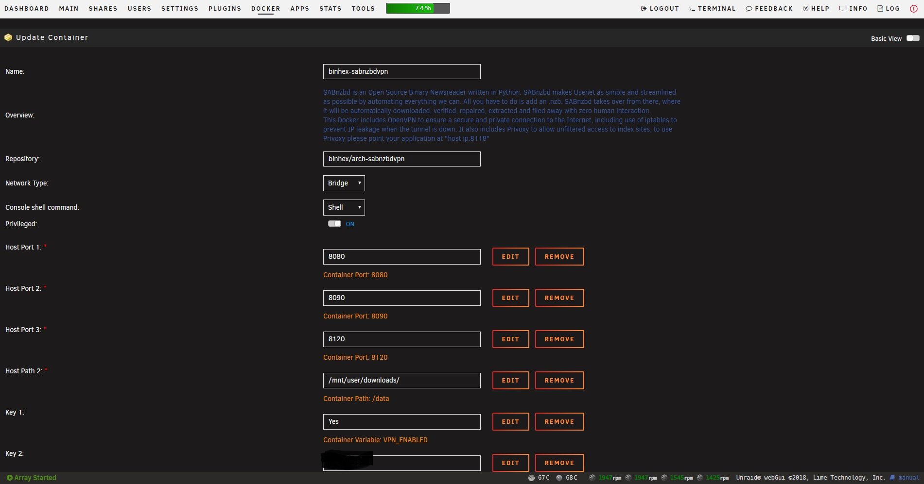

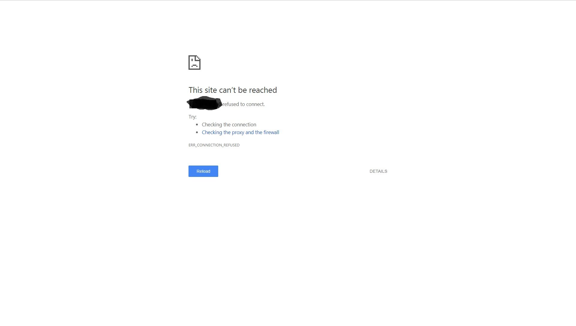

I seem to be having trouble getting binhex-sabnzbdvpn to work in UNRAID v6.6.0....  I have setup my vpn
account with PIA and know it to be working...  When I try to open the docker with the vpn option enabled,
it refuses to connect (unable to open the WebUI), however when I disable the vpn, it connects fine... I had
this all working in the previous release of UNRAID, but with this release candidate, I can't get the docker to
work when I try to enable the vpn connection.  I'm not sure how I can fix this, and would rather not revert
to the previous version of UNRAID, as I like this new version.
Image 1 shows the docker page.
Image 2 shows binhexx-sabnzbdvpn settings.
Image 3 shows the error when i try open the WebUI with the "VPN_ENABLED" set to yes.
rg-server-diagnostics-20180922-0641b.zip
please follow the procedure in the link below:-
https://forums.unraid.net/topic/44108-support-binhex-general/?do=findComment&comment=435831
