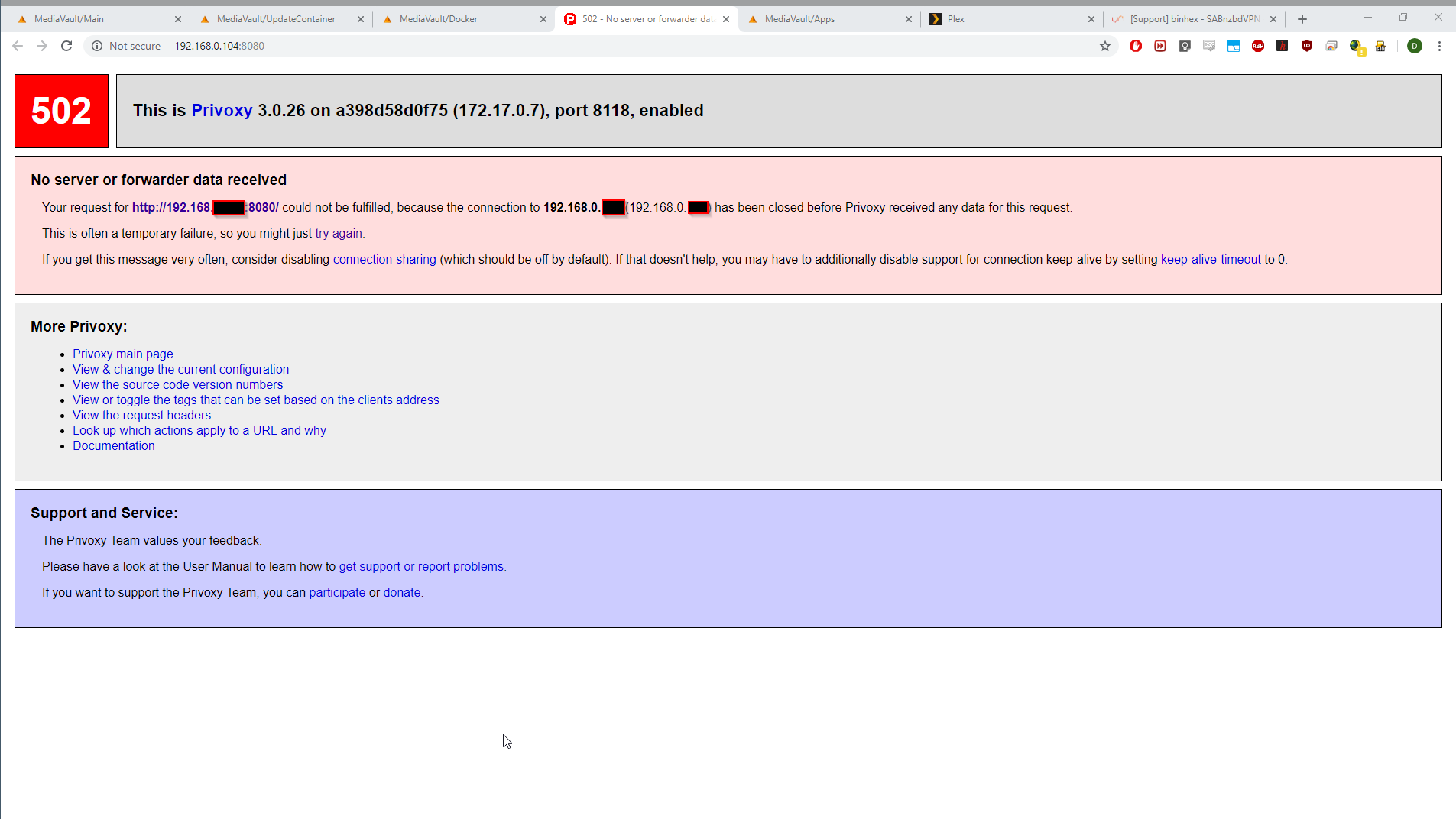

So I was trying to run my SABnzbd traffic through privoxy. I put everything into Sonarr and Radarr fine. I put the same information into SABnzbd under the "Listening Port" section, and now I get this error:
How do I revert back to the previous information, and set it up properly?

hmmm my google wifi is the gateway, hardwired to my AT&T modem, DMZd. Below are my windows and linux ip configs. I did have the gateway in there, what am I missing here? Feeling pretty dense... I am continuing to read that thread, good info in there. But if this lan_network stopping me, I am not getting it.

I can also confirm my is set correctly

5. if it doesnt start then stop the container and delete the newly created config folder and then reverse step 2.
This was a new install as I originally believed it was a issue with the docker as it broke after a unraid reboot.
Let me try again
Let me try again
interesting that it broke after a reboot, potentially this could be the cause of corruption (shouldnt do), what path is /config pointing to on your host?, is it /mnt/user/appdata/... by any chance?
Yes this server does not utilize a Cache. I did as requested here is the log
supervisord.log
supervisord.log
so im guessing re-creating the config folder didnt fix it?
Nope. Want me to delete the docker and config folder see what a new install looks like
