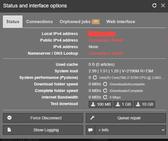

after the last update my SABNZBDVPN stop work, try to go back to an old version, and still the error below:

2022-10-13 22:58:33,480 DEBG 'start-script' stderr output:
Error: error sending query: Could not send or receive, because of network error
Any advise to fix it?
Thank you in advance.
Tested VPN = no working fine. Something with the VPN. Do you know if the certificates need to be in a separate files?
14/10 - 11:45 - Changed the DNS address to location connecting in the file to IP and works. I'm using ExpressVPN, anyone with the same issue? Do you know how i can go back the the DNS address instead of IP?

Was getting random 'unable to resolve server.newshostserver.domain' and downloads would randomly stop.
just changed DNS to cloudflare to see if this resolves it, but now i just keep getting in a loop of trying to connect to VPN then times out then tries again and again.....?
Even tried replacing PIA server with another, same issue with multiple?
Debug log attached.... also checked firewall for the PIA ip, no matches blocked.
FIxed: Downloaded new openvpn config files reference a IP (91.90.121.230) rather than the older config that references uk-manchester.privacy.network (domain).
Restored old PIA config files from 4 months back. works fine with DNS changed to cloudflare, new config files do not. very weird? not sure as to why? as i downloaded them from PIA site.
