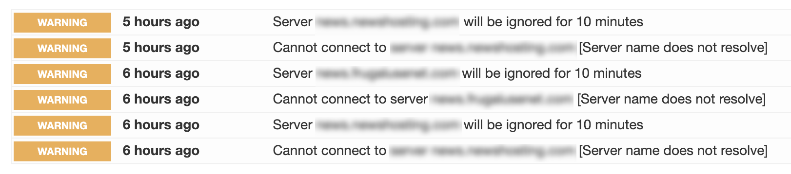

For what it's worth I've been having the same issues. Newshosting will usually resolve after 10 minutes but my alternate one continuously fails to resolve.
Did you change dns to cloudflare or opendns? Seems to have sorted my dns issue.

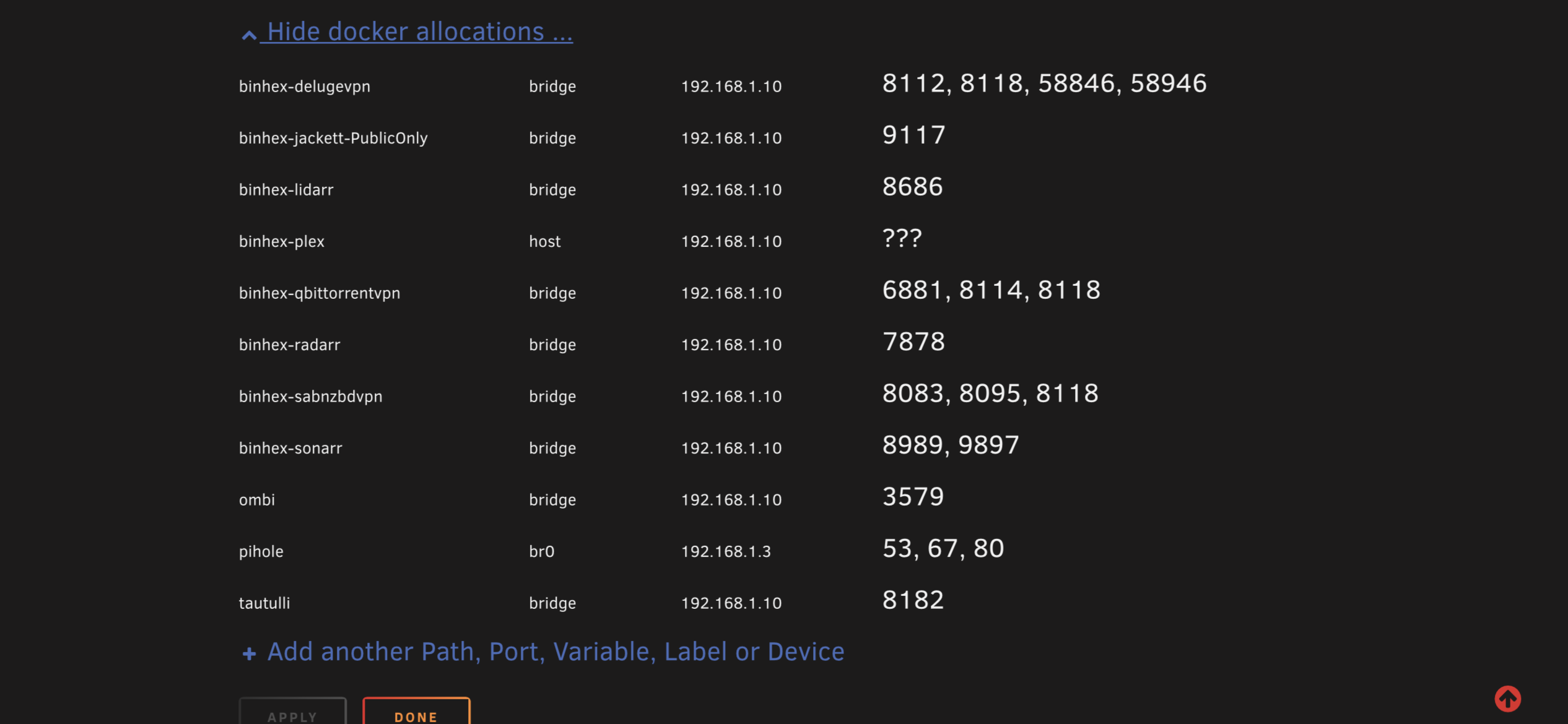

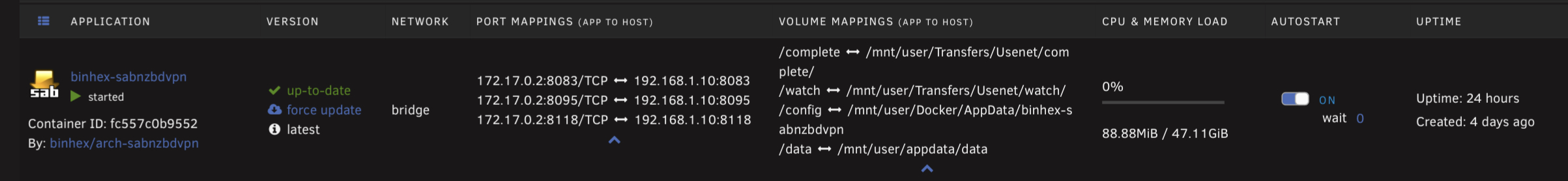

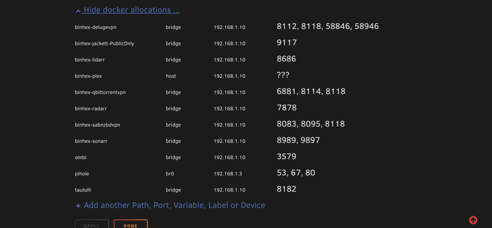

normally I navigate to 192.168.1.10 to get to UnRAID > docker tab > SAB icon > WebUI
this opens a new tab to 192.168.1.10:8080
i also tried just manually specifying 192.168.1.10:8080
all I can think is if something else is fighting for port 8080?
maybe I’m looking in the wrong place but when I look at docker allocations I don’t see anything using 8080
Or maybe I need to add a new port from container port 8080 to host port 8080?
Added some screenshots
5 hours ago, Roudy said:
You change them in the Docker settings under the NAME_SERVERS variable.
Thanks! Sorry, one more dumb question...in this scenario would I replace all of the IPs in the NAME_SERVERS variable with the new DNS servers or just add in the additional IPs?
well looking at your screenshot i see no sign of port 8080 either!, so either those screenshots are trimmed or you have switched the port or even deleted the port from the container. can you do the following:-

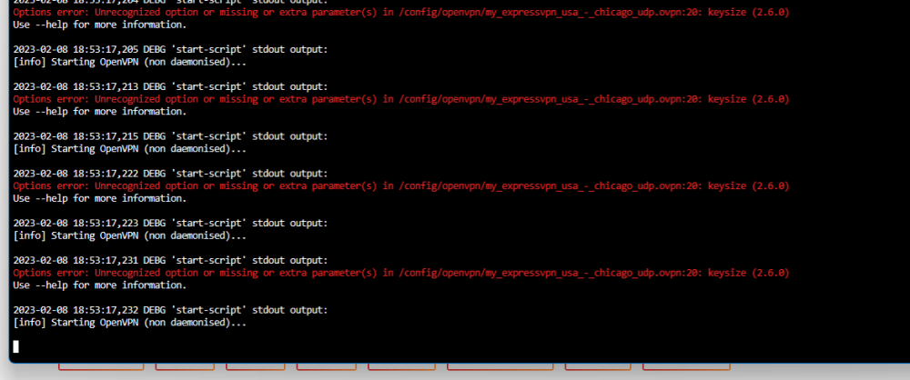

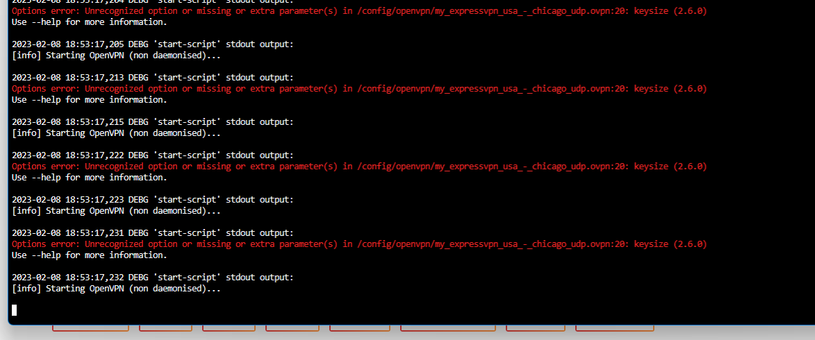

Hi, I have this docker enabled with PIA VPN. Over the last few weeks I've noticed I've been getting ignored/connection warnings pop up every now and then. One time I tried disabling the VPN and obviously started up right away. After that I turned it back on and it kept going as well. Anything I can do to get these warnings to stop?
Today my server upgraded to SABnzbd.py-3.7.2 and now sabnzbd is unreachable. Log is just full of the attached image.
I went to ExpressVPN site, downloaded new .ovpn file just to see if related, no change.
Set VPN to No on sabnzbd container and it booted no issue.
Seems there might be an issue with SABnzbd.py-3.7.2 ?

its nothing to do with sabnzbd, openvpn has deprecated some of the options a while ago, it has now ended the deprecation and will now return an error if the option exists in your openvpn config file.
not sure if you have the EXACT same issue as there was a ton of options removed, but for you @Sanborn look at your openvpn config file for 'keysize' and remove that line, it looks to be on line 20 i think.
This fixed it, thanks!
