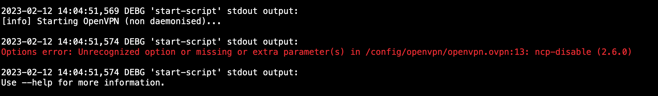

I have a similar problem since the last update.
Do I just delete line 13?
What does ncp-disable means?
1056365004_Bildschirmfoto2023-02-12um14_10_08.thumb.png.989ebac3788f168ab9660846a3879ba7.png
Yes
ncp-disable was mainly a debug option that allowed disabling ncp if there were problem with dynamic cipher negotiation. With the current status of NCP, this option is no longer necessary.
Sent from my 22021211RG using Tapatalk
thanks

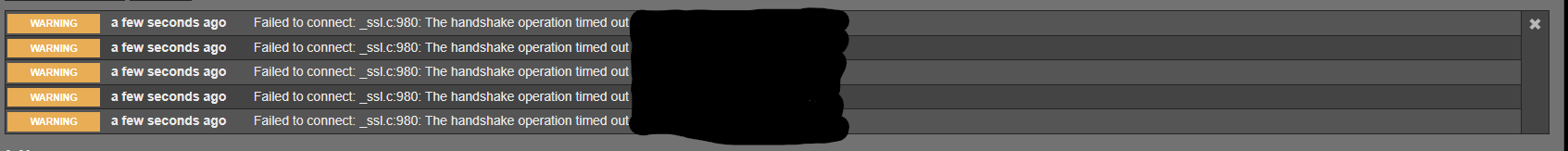

I use docker with PIA VPN but for a the last 2 weeks I constantly get this error.2070658307_Screenshot2023-02-23173353.thumb.png.4efe61f57abdad7af13d5b486432ae65.png
I don't have a keysize line in my config and I tried other PIA servers.
Is there anything I can do?

On 2/23/2023 at 11:49 AM, Tnoriel said:
Hi.
I have been seeing this for weeks also.  I currently use wireguard, but originally set this up prior to wireguard existing.  Are there any 'stale' settings I need to change/remove, or is this something I can edit to rectify?

On 2/23/2023 at 5:49 PM, Tnoriel said:
Hi.
I switched to Wireguard and it fixed it.

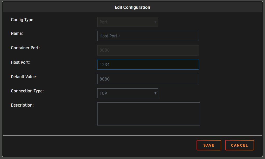

Would it be possible to add the variables "WEBUI_PORT_HTTPS/WEBUI_PORT_HTTP" so I can change the port when using a macvlan docker network? In you qbittorrentvpn docker this is implemented.
Thx

never mind. only needed to change the host port and not the container port.
Hello @binhex
chimp with a keyboard again and you guessed it, new docker, same(ish) problem.
i cant use 8080 and thought after our last adventure I was modifying ports like a boss, alas, on this container, despite me changing ports the log says listening on 8080 and i cant hit the webgui... any faq on this topic?
Edited by klippertyk
solved it myself.
Hello @binhex
OK so qbittorrent is a special case, for that docker image you need to specify the WEBUI_PORT and re-create the port you want, this is all due to enhanced security built into qBittorrent (CSRF protection).
For all other docker images i produce you do NOT change the container port, you simply change the host port side, which you can do through the unraid web ui without the need to re-create the port, for example say you wanted to access SABnbd on port 1234, you would change it to the following, note the host port number and note the container port is greyed out to prevent you from changing it (what we want):-
