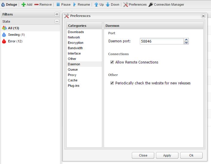

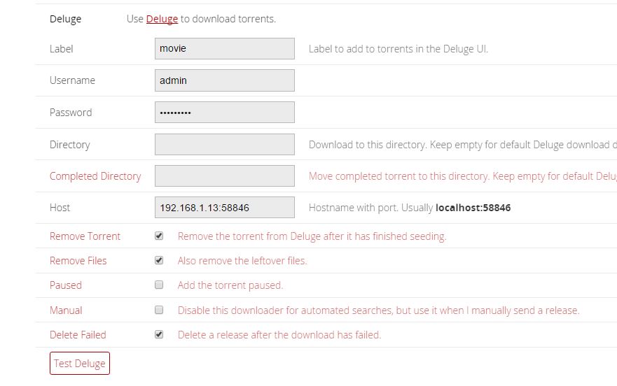

Love your dockers binhex. I have your delugevpn up and running great with sonarr, but I am having a hard time connecting couchpotato to delugevpn. I keep getting the cannot connect error when I test the connection under settings, and I can't find the problem in the log. I have tried to add a user to the auth file in delugevpn and adding the user to CP settings, but that doesn't work either. Any idea what I am doing wrong?
Did you restart deluge after adding the username/password to auth?
Shutdown deluge.
edit auth file.
restart deluge.
Shutdown deluge.
edit auth file.
restart deluge.
I restarted the server, installed the delugevpn update and tried again last night without any luck. After reading your comment this morning, i decided to give it another go and stopped both services and it worked! Wow I feel like an idiot, this has been bugging me for 2 days and it was something so simple. Thanks!
My guess is the auth file is read and loaded into memory at boot up only.

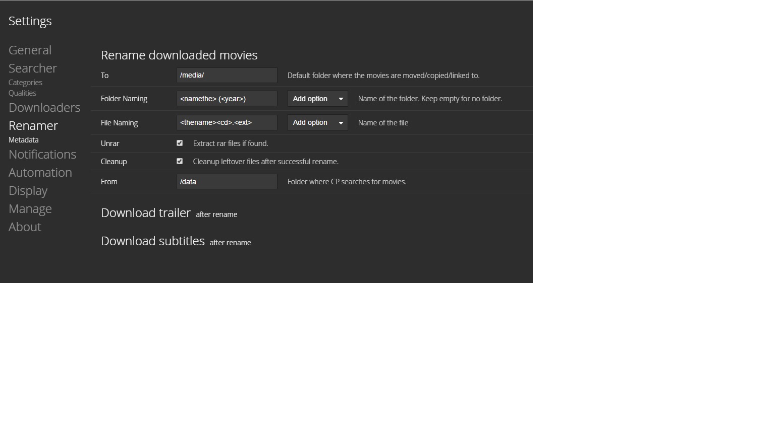

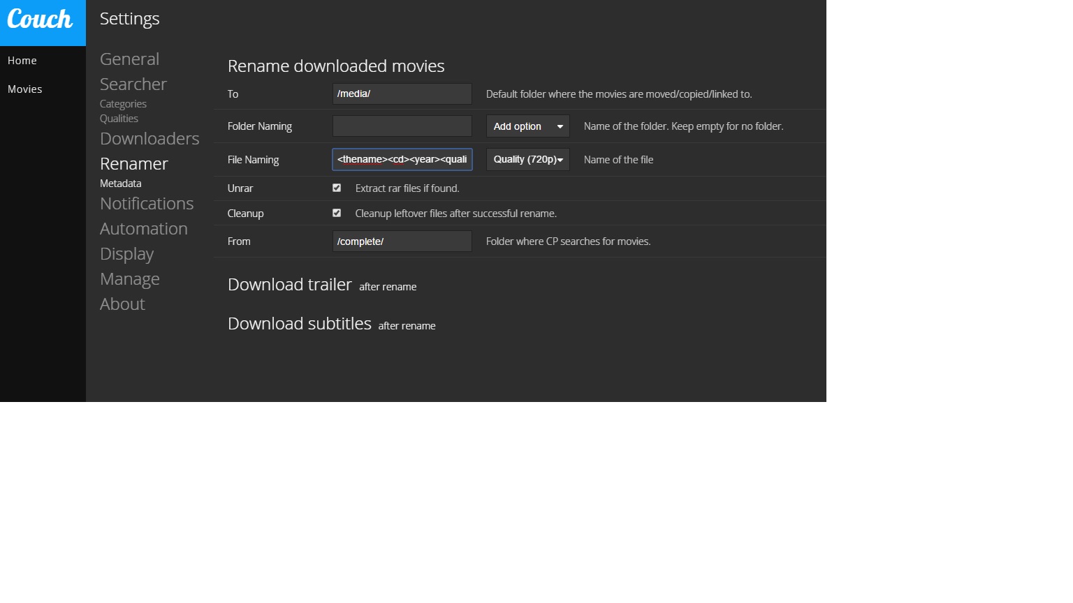

Just looking for a little advice really.
I have couch potato setup as I would like it in terms of its links to delugeVPN and its downloading exactly as I would like.
My question is in relation to the Renamer. Currently delugeVPN downloads to a downloads folder. I want my renamer to get the downloaded video file only, rename it, then put it into my movies folder and finally clean up the excess files that get downloaded with a torrent. I have included a picture of my current renamer settings and im curious as to weather this should work as I want it to or do I need to change something? Also how often does this renamer run?

Ok i'm getting closer to getting this working exactly as i want it.
I'm in a position where as you said I have my Downloads going to my downloads folder and then within that folder I have a complete folder which is linked to my renamer in couchpotato. Now.... My renamer seems to like to move a few other files with it. Is there anyway to stop any other files getting moved? I'll post my mover setup
EDIT***
Just unticked the unzip option!
And I am still having the issue with the mover not moving the full files. Its only partially moving the files and leaving them unplayable.... really annoying. And I am only allowing it to move the completed files.
