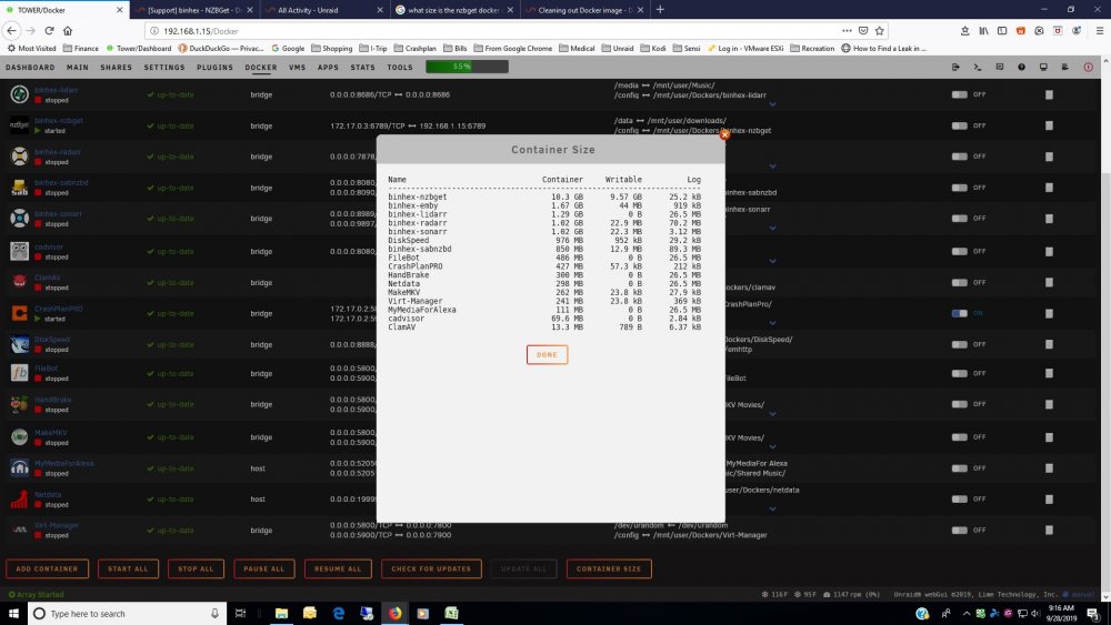

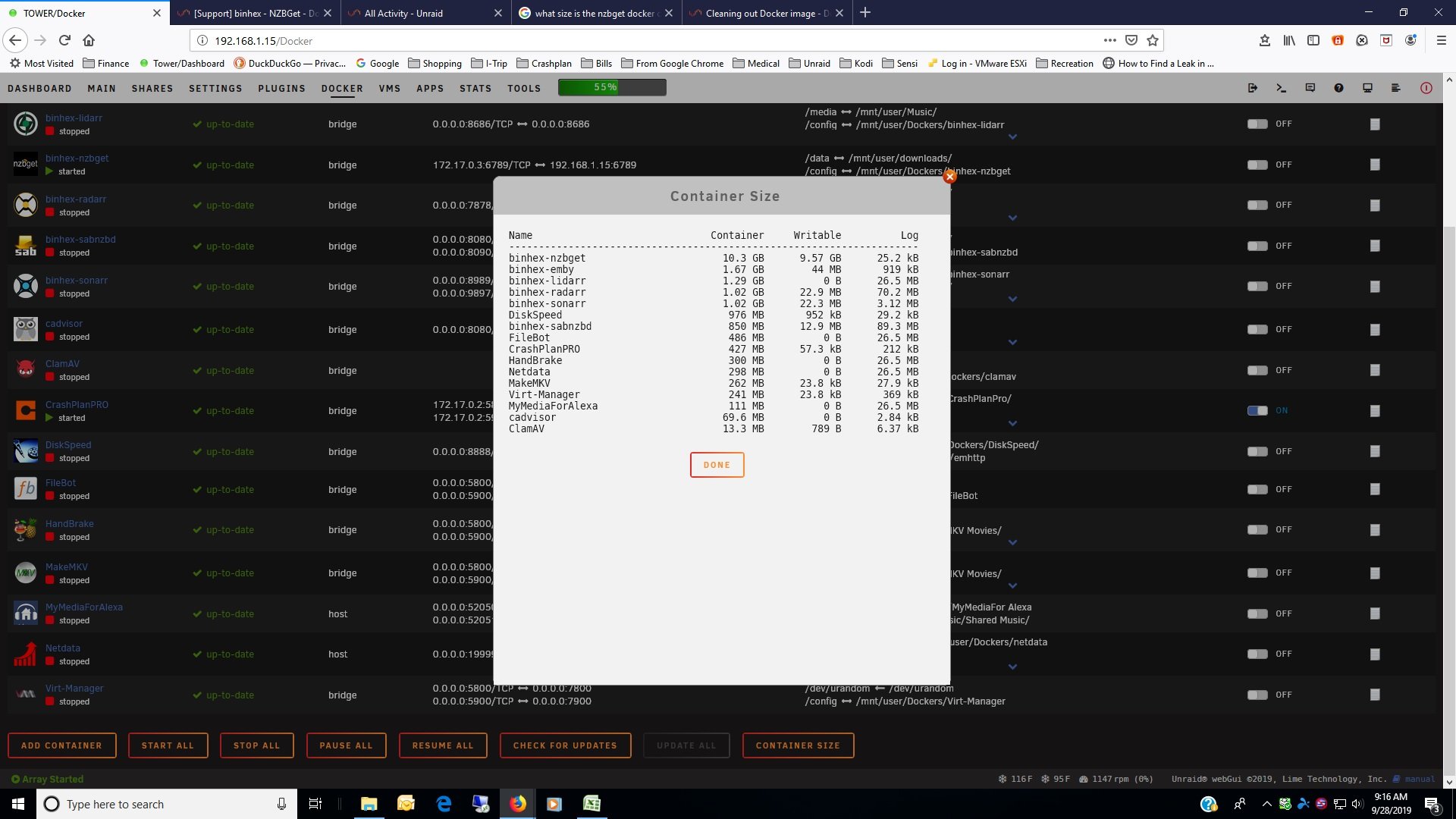

I recently installed the container, and started getting notices that my docker.img file was very full. Original file size was 20G, so I increased it to 30G and all notices stopped. Looking at the Docker Container Size shows the binhex-nzbget container size to be 10.3GB.
My Question: Is this the normal size for this container? Next Largest container is binhex-emby, considerably smaller. No other container is close to this size.

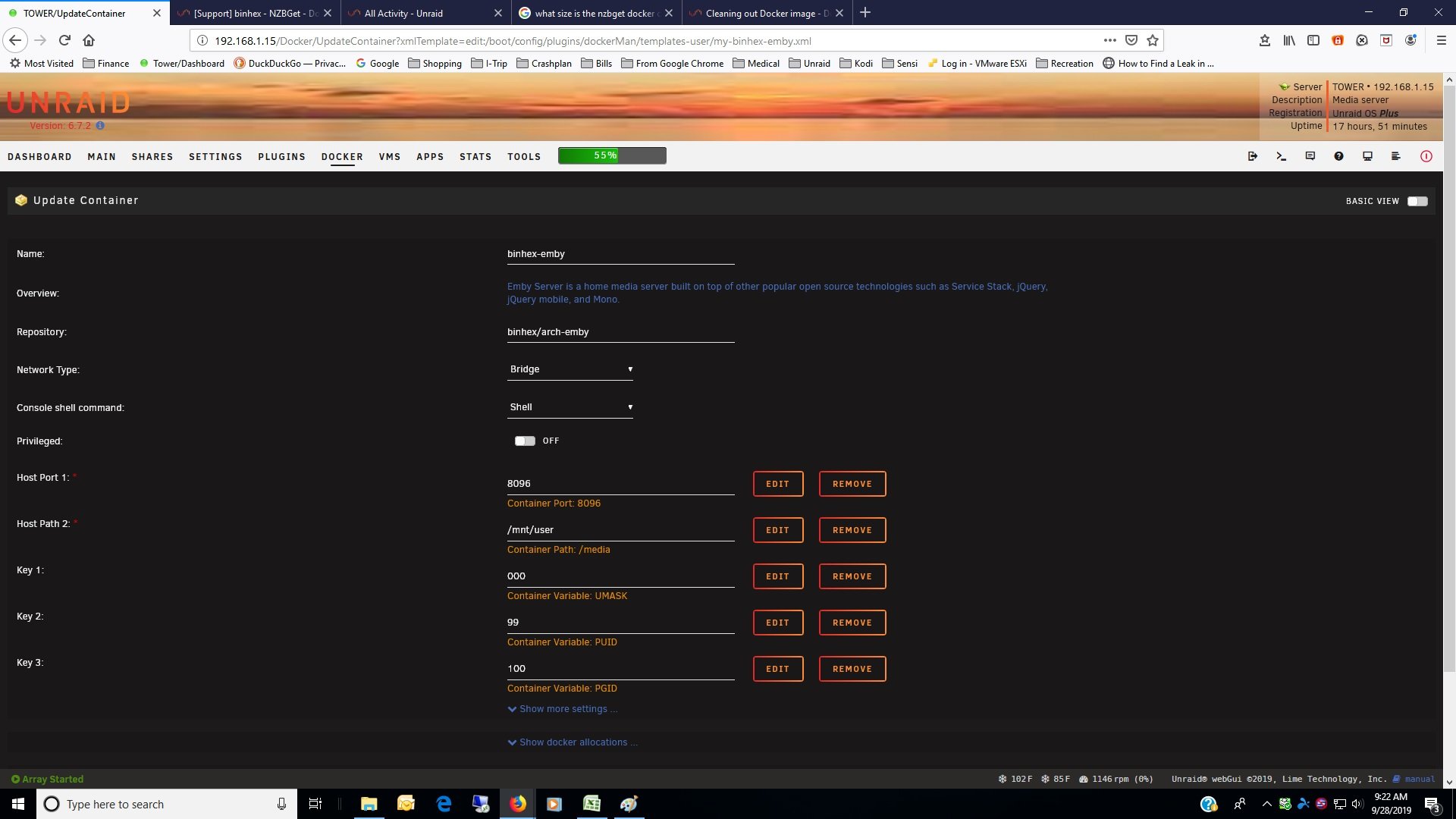

I am attaching the Container size and device mappings screenshots for reference.

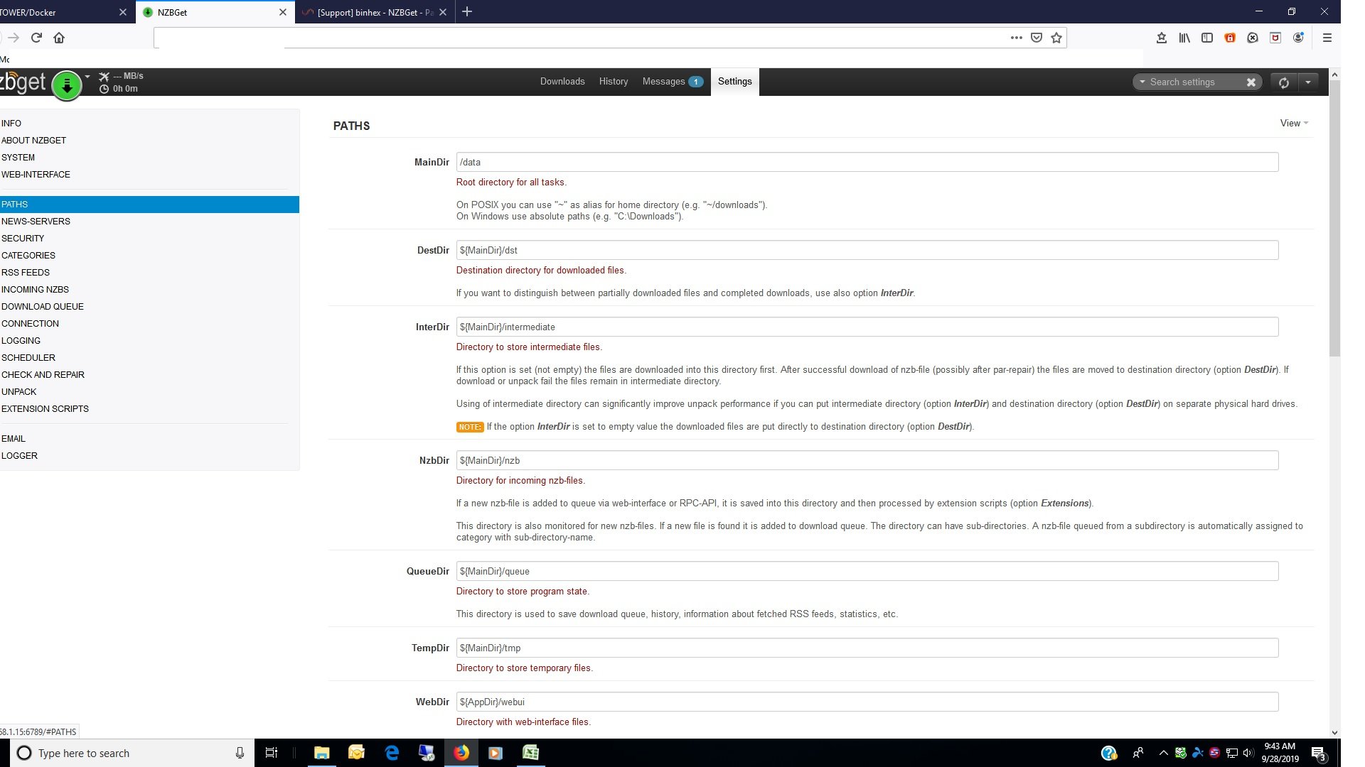

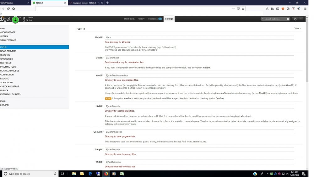

The "writeable" column for NzbGet shows 9.7GB.  You've misconfigured nzbget in its UI and you are downloading the files into the docker.img instead of telling it to download to /data
Squid, Thanks for the quick response. I have tried to see what is misconfigured, but do not see it. I have compared this container mappings to my sabnzb container, which appears to be mapped correctly, and cannot identify the problem. I am attaching the paths page of the container. Can you identify which setting is incorrect? Thanks in advance.1511936340_nzbgetpaths.thumb.jpg.e8b6ebd05066df0d32588592ab11d3e3.jpg

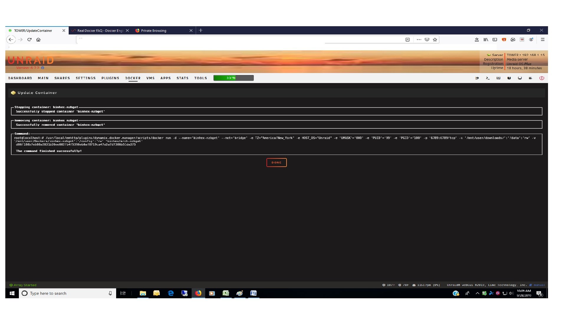

Run Command Attached
Looks like it should work.  Only guess is that MainDir has a space or something after /data
Failing that, remove the app, reinstall it and then monitor the situation

Update: Just checked Docker Container Size again before trying your suggested changes, and it appears that all is OK now.
binhex-nzbget 738 MB 13.8 MB 7.51 kB
The only thing I did was change the port mapping & change it back to create the run command, so not sure but it appears that corrected the issue.
I can now reduce docker image size.
