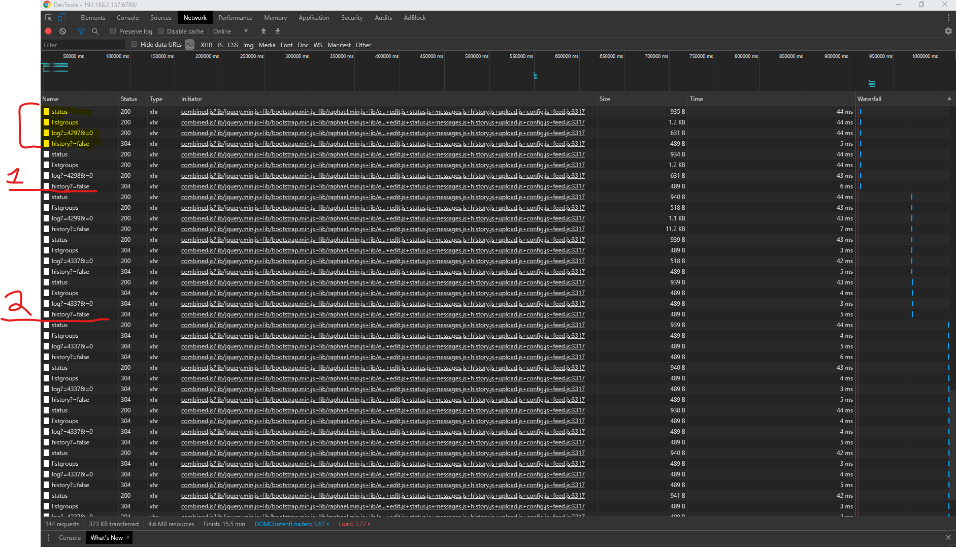

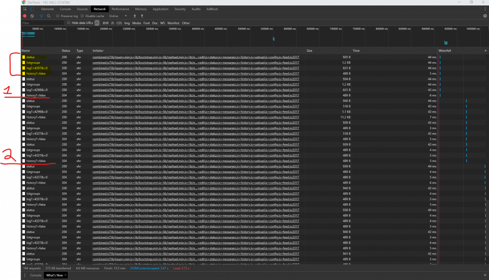

I was hoping it wouldn't be only on my side that makes it work. It's been unpacking successfully since last post.
I've been tracking it since and noticed a few more things. First I noticed that the page underneath the modal doesn't refresh, or update while it's up. And I know it's been working because the episodes are showing up in Plex. Once I click the close button, then the History page updates with all the successful downloads it's had since I last opened it.
I opened up dev tools and noticed a few things in the network panel.
The highlighted items will continuously loop every second until (#1) I click a modal. At which point they stop.
A few minutes later I closed the modal, saw episode download update, started looping and then I clicked an item to open modal again. (#2)
The loops stopped and then a few minutes later I closed modal again and it started looping.
I noticed that the calls changed from 1/4 being a 304, to 3/4 being a 304.
Let me know if any of this is helpful or not. I've attached image. Let me know if there's anything else I can test/help with.
