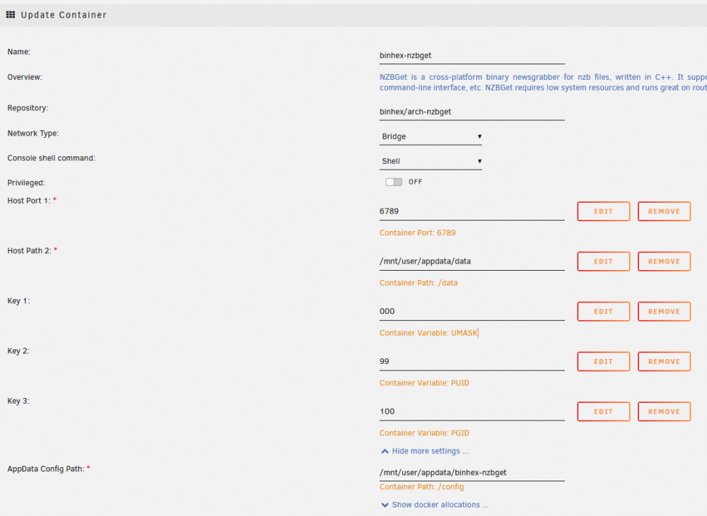

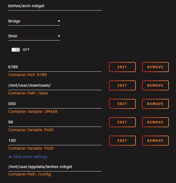

On 4/25/2020 at 11:11 AM, jonathanm said:
Set MainDir to /data
Have followed this advice, yet my downloads still seem to still be pointed to inside of the container. This is driving me crazy as i dont know what im doing wrong here and my mappings are similar to this they seem to point to /usr/local/bin/nzbget/data/completed/Movies/name of file. I also have radarr reporting "You are using docker; download client nzbget places downloads in /usr/local/bin/nzbget/data/completed/Movies but this directory does not appear to exist inside the container. Review your remote path mappings and container volume settings." can anyone shed light on what ive messed up here ?

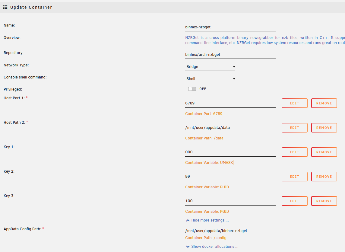

On 4/25/2020 at 11:08 AM, EvilTiger said:
attached

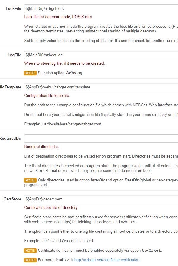

From your screenshots, it doesn't look like it.  Your very first field above should be

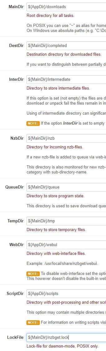

Thank you for responding. So should every tag like ${AppDir} or ${MainDir} be removed ?

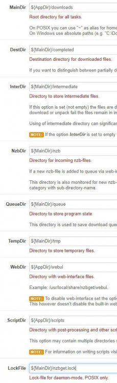

NO!
6 minutes ago, jonathanm said:
NO!
Just the one that was recommended ?
yes
Thank you all, everything is now working as intended

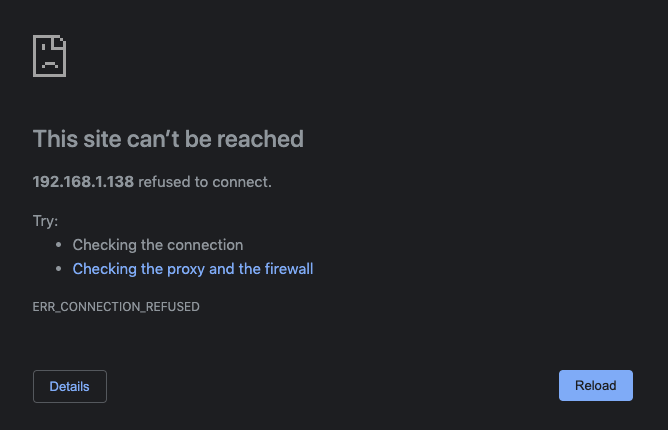

Hi all,
i tried to install the binhex nzbget container but can not access it right after installing. The ui just does not load (192.168.2.138:6789)
The log looks good!?

20 hours ago, dehein2 said:
Hi all,

 Solved: it was a firefox issue (keepass plugin was blocking the popup)
