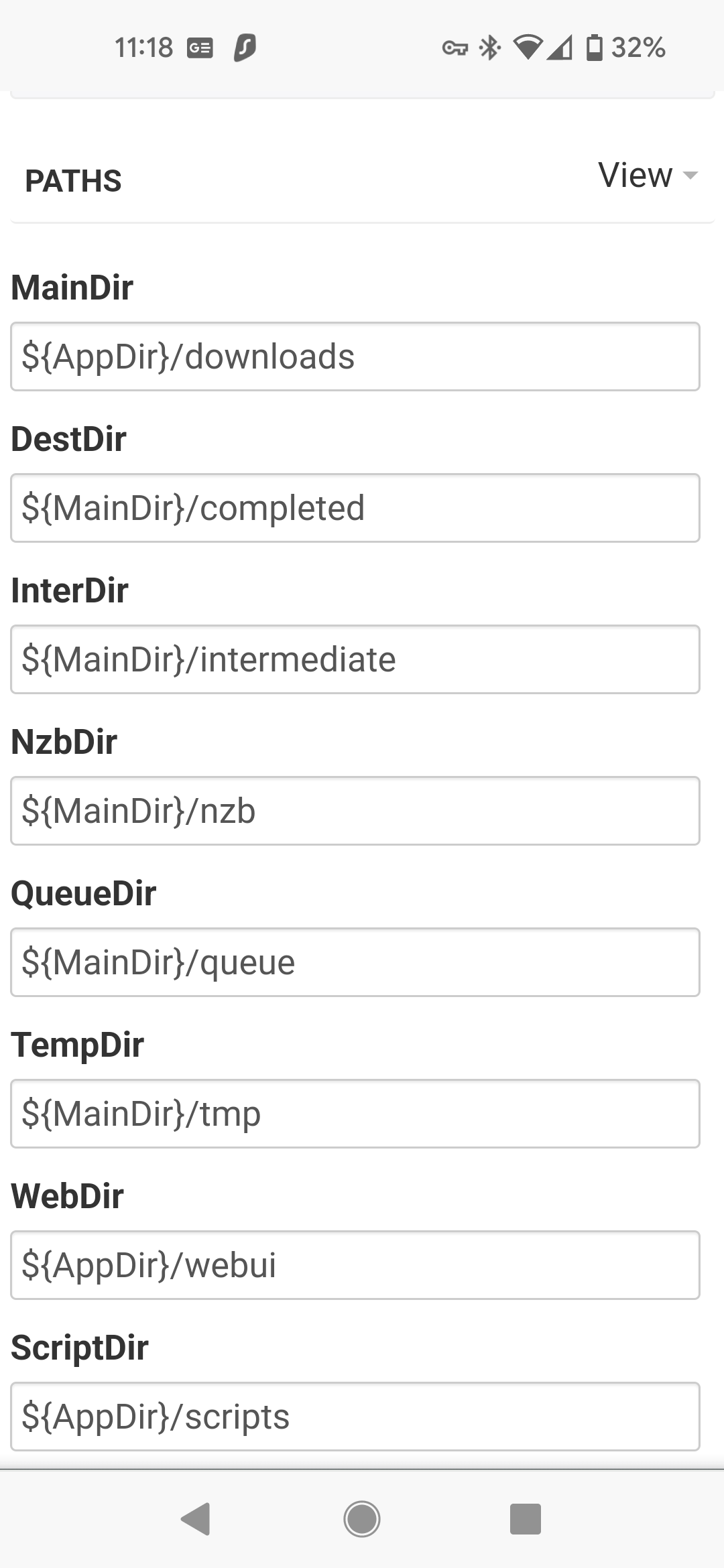

Im struggling here, this worked great for quite a while and then I rebuilt all my dockers.
Now all the downloads are going into the docker.img file and not into the defined directory. I am not sure how to fix this.
Host Path 2 is set to my download location in the docker setup file.
/mnt/user/Tower_Downloads/
My NZBGet settings are set to :
MainDir: ${AppDir}/downloads
DestDir: ${MainDir}/completed
I hope I am missing something stupid simple, if other info is needed please let me know.
Thanks
Thanks
Your problem is using {AppDir} in the NZBGet settings. {AppDir} is the directory where the nzbget executables/binaries are stored, which in this case is inside the docker image.
Host Path 2 maps to /data inside the container, so the simplest fix would be to set MainDir = /data
This will make NZBGet store files that are being downloaded in /mnt/user/Tower_Downloads (from Unraid's perspective) and completed downloads will be moved to /mnt/user/Tower_Downloads/completed
Probably better though to set MainDir = /config (which is normally the appdata share in unraid), and:
DestDir: /data/completed
InterDir: /data/inter
This has the benefit of storing everything else that is using {MainDir} (i.e. nzb's, the queue, temp files etc.) in your appdata share, which should be on a fast cache share.
In-progress downloads would be stored in /mnt/user/Tower_Downloads/inter and then moved to /mnt/user/Tower_Downloads/completed

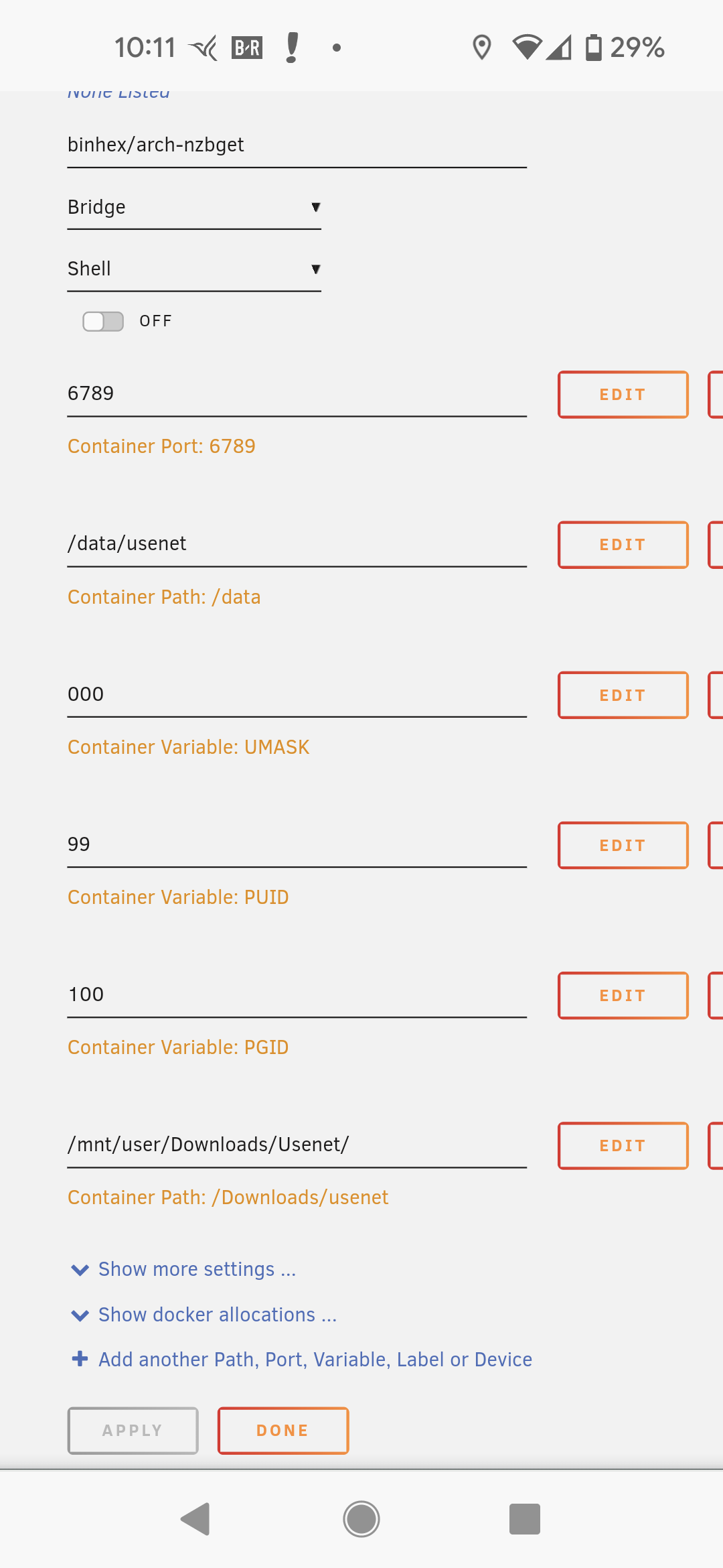

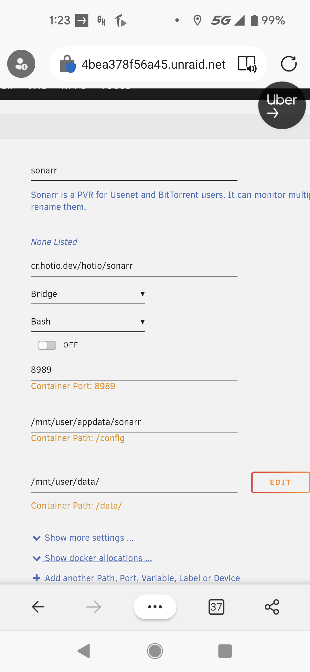

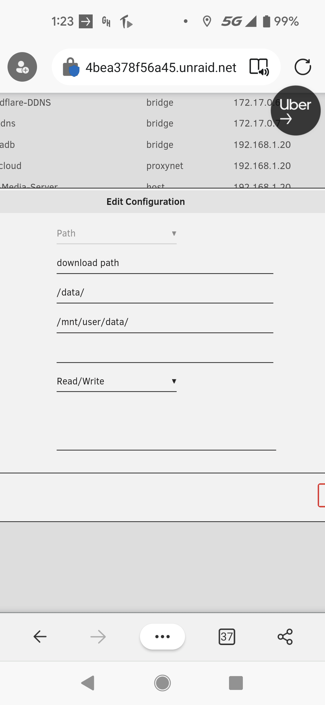

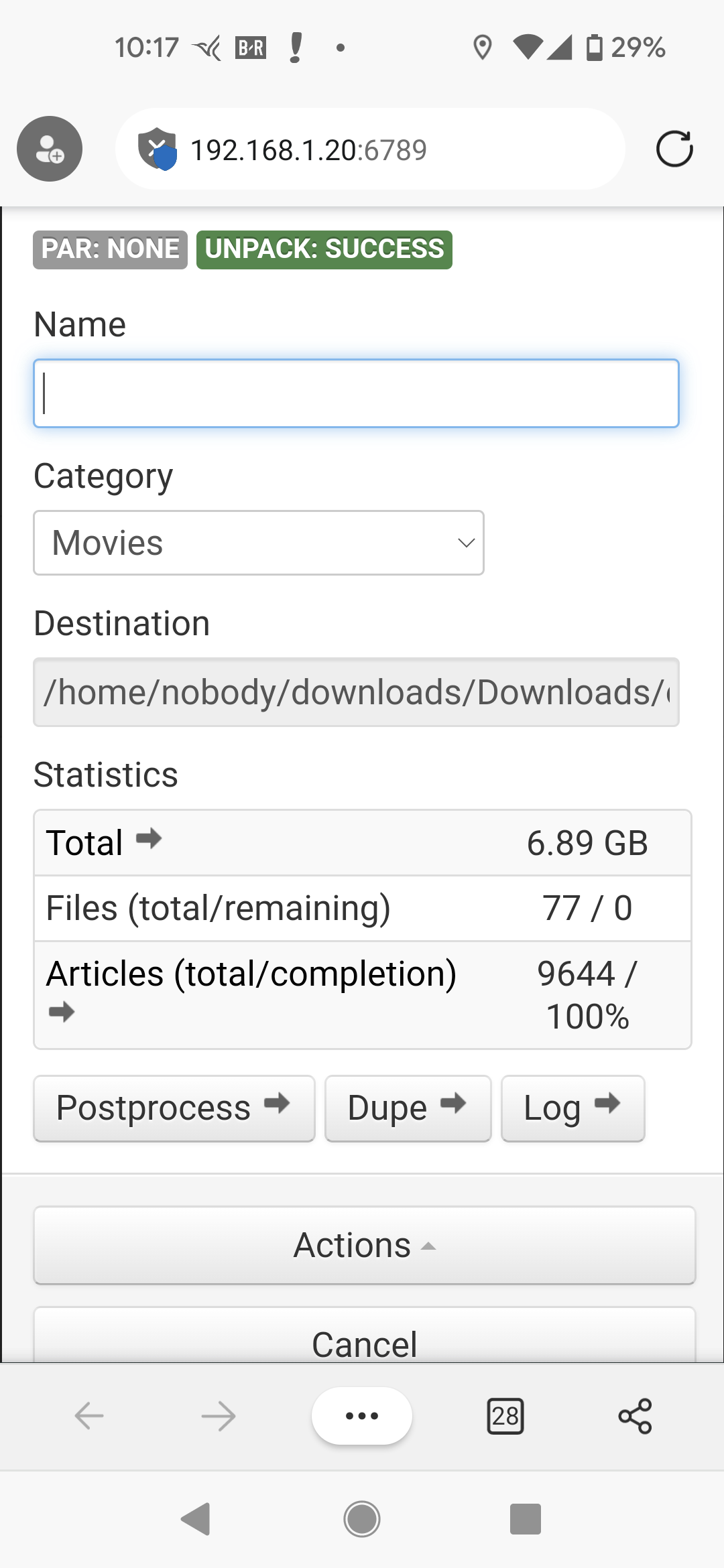

I'm having issues downloading.
I guess I'm not sure where NZBGET is downloading my files.
My Docker container keeps filling up and I can't locate the download files.
I created a share downloads/usenet
Also I found that it downloaded a file to path below in the screenshot
Edited by Networx2002
Change /data/usenet in the container template to the array share location you want to download to, like /mnt/user/downloads or similar, then change the NZBGet MainDir to /data
2 hours ago, JonathanM said:
Thank you!

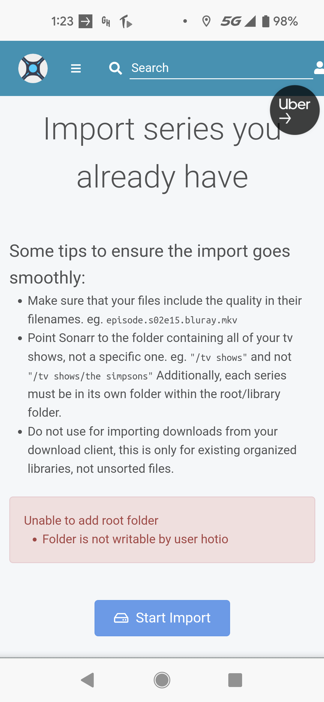

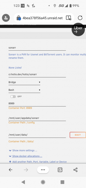

Now I'm having an issue with sonarr.
I made a directory
Data
Media
Tv
But when I try and add it to sonarr I get the error on the screenshot.
Thanks for your assistance

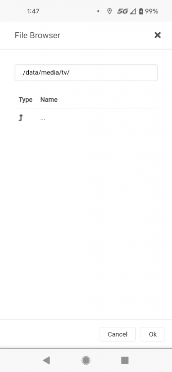

What path are you entering in sonarr?
Data/media/tv
6 minutes ago, Networx2002 said:
Data/media/tv
Is there a media folder in the data share?
Sorry I don't understand.
There isn't anything in the TV folder if that's what your asking

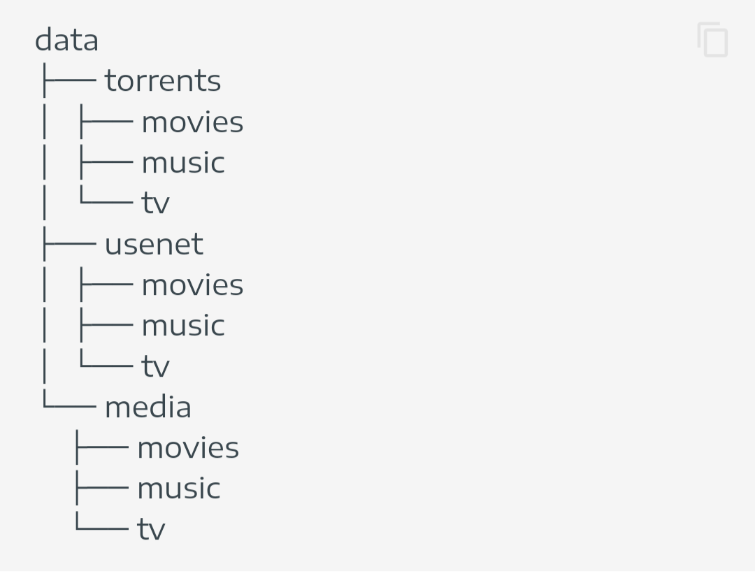

File structure
data is the main share
Ok so this wired. I can add folders under data that was created by NZBGET, but not the folders I created in unRAID...
So I was able to figure it out.
I had to delete the folders I created in unRAID and create them from windows explorer.  now I'm able to map the folders...
Thanks for your assistance!
