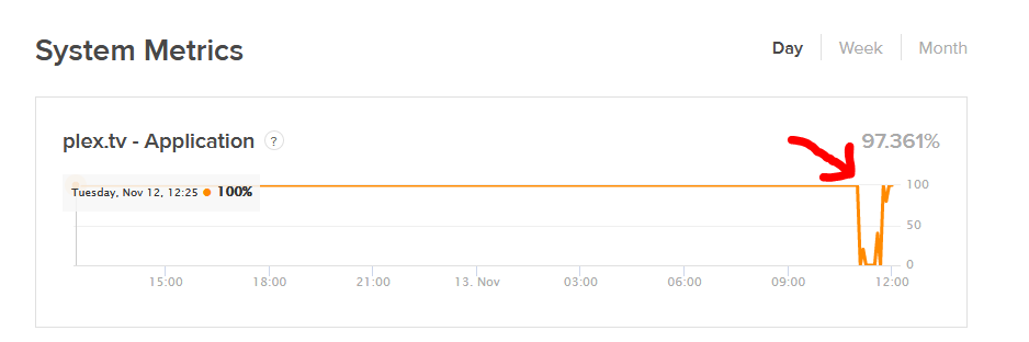

I had same issue by coincidence. I think there was a major outage in the authentication API at their end.
When I checked their status page I saw a big spike around 11:00 today (13th November 2019) which was resolved by 12pm.
(plex.tv - Authentication and API server - red)
Edited by manfat
Update after service restored

Thanks @manfat I can now get in to plex
