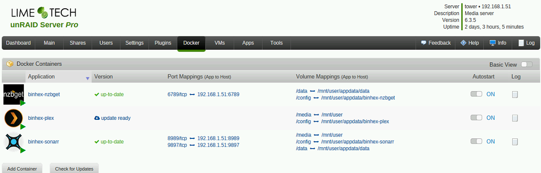

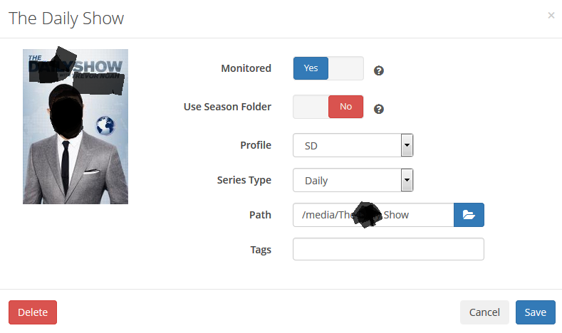

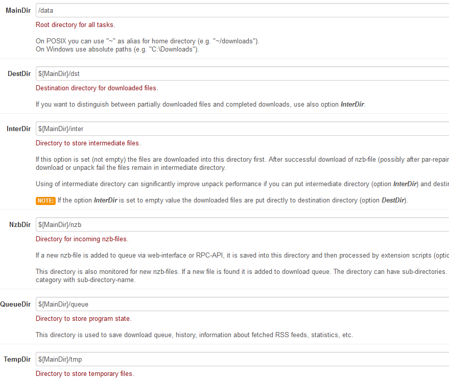

14 hours ago, johnny121b said:
I'll take some screenshots later today.  I'm about to head to work.  I understand your frustration.  The added layer of abstraction when dealing with dockers absolutely drove me crazy.. so-much-so, that when I finally got it running, I squirreled away screenshots of everything- because despite the fact that I had it running, I still didn't fully UNDERSTAND why it worked..so I knew I couldn't fix it when it broke.  (unfortunately for you, I'm not sure where those screenshots are at-the-moment, because it's been so long ago.)
What are you working with besides PLEX?  NZBGet/Sabnzbd/? Sonarr/Sickbeard/?
At my age, my head doesn't wrap around abstraction as well as it once did.  Hard to believe I could once write code in assembly.  Adding to BinHex's response, here's a shot of an example show in Sonarr.  If you're like me, you're overthinking the paths.  Even now, i look at BinHex's reply, and I struggle with the logic in USING abstract paths- IF everything has to be the same anyways.  I -SO- want to specify absolutes....complete absolutes...from every application.  But times change, and we all have to adapt.  I blurred out some details on the page, but I think you'll get the idea. (I was once scolded for including too much detail, but now I only record public domain shows.)
The second shot, is the path configuration for NZBGet.  Its paths are unchanged from the docker defaults.  Not sure if this all helps, but hopefully it might.
Share this post

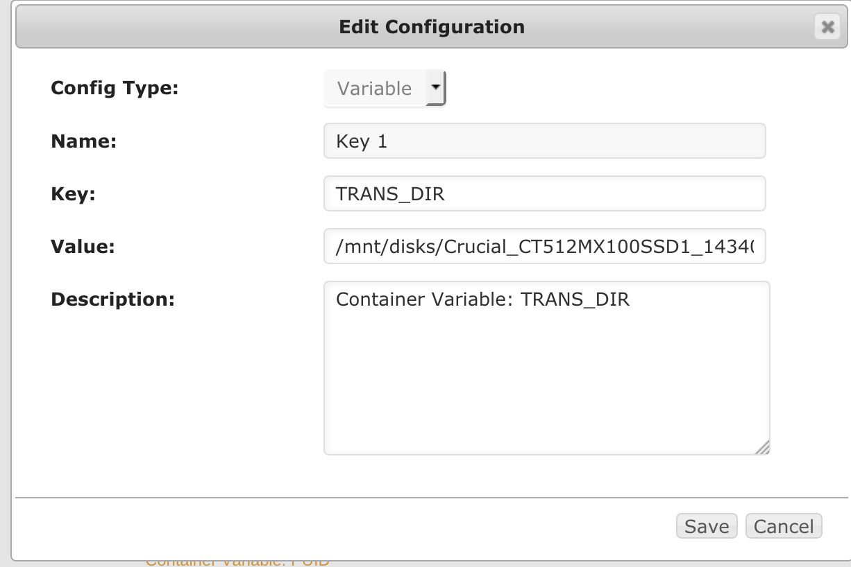

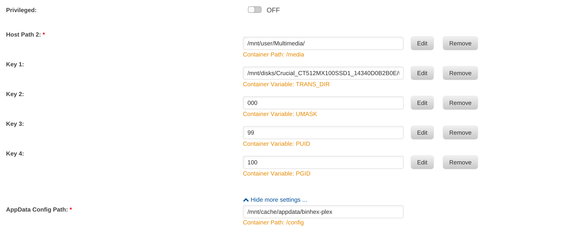

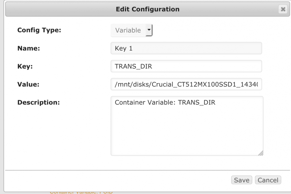

i grabbed the latest update, and now the cache drive that i had before working, is not, and causes the docker to crash. Tried mounting transcode to both cache, and now as you can see to an unassigned SSD, with same results.

5 minutes ago, JohnnyBlaze99 said:
Not a directory: "/mnt/disks/Crucial_CT512MX100SSD1_14340D0B2B0E/transcode"'
Are you mapping /mnt to /mnt in the template?

Admittedly I don't use Plex, but the way that I see it is that you've got an environment variable (TRANS_DIR) with a setting of /mnt/disks/.....
Plex returns an error  saying that /mnt/disks/... doesn't exist.  Because it doesn't as far as the container is concerned.  The only paths you've mapped are /config mapped to /mnt/cache/appdata/... and /media mapped to /mnt/user/Multimedia
Doesn't matter about the variable setting or not.  Plex can only see folders on the host if you have them mapped.  Adding another path of /mnt mapped to /mnt should get rid of that error (assuming you typed in the path correctly in the environment variable)
Shouldn't it be "/mnt/cache/transcode" ?
If your "/config" is mapped to "/mnt/cache/appdata/binhex-plex", then your 'TRANS-DIR' should be mapped to "/config/transcode" and this will point to this real folder "/mnt/cache/appdata/binhex-plex/transcode"
edit the line "/mnt/disks/Crucial_CT512MX100SSD1_14340D0B2B0E/transcode"' to "/config/transcode" and restart your plex docker.
Edited by SoAvenger
better answer
Share this post
Link to post
This worked. not sure what changed between the updates that caused this, but /config/transcode corrected the issue. Wondering where it will point though now? Will it still use the cache drive as a transcode, by using /mnt/cache/appdata/binhex-plex/transcode ?
