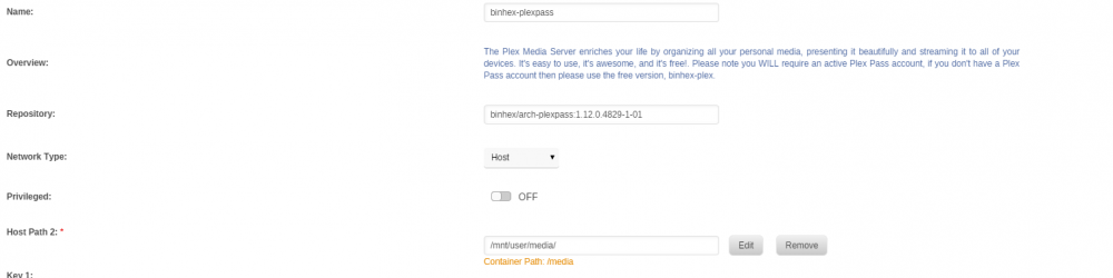

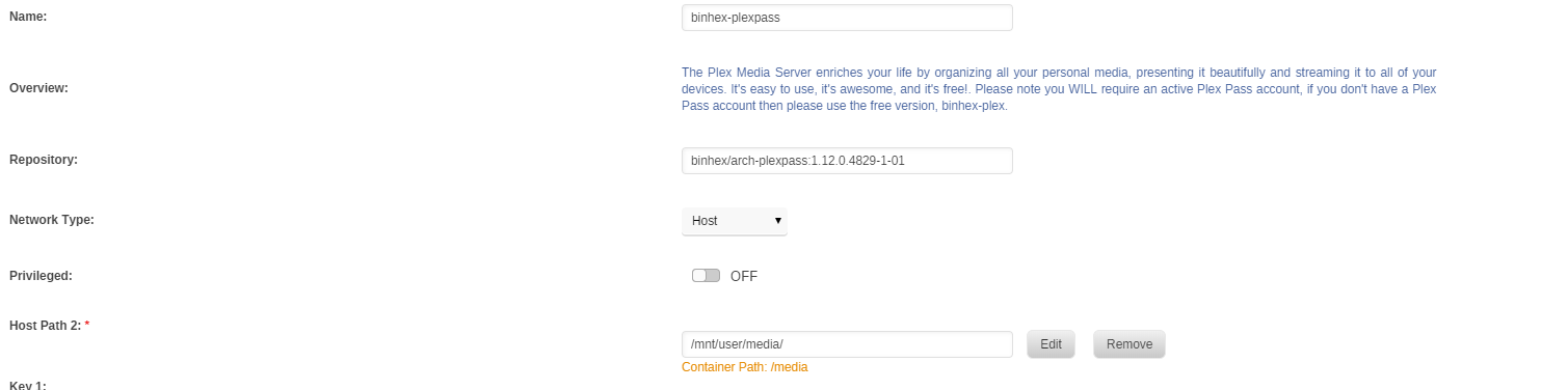

1 hour ago, Droidem said:
just change your repository to "binhex/arch-plexpass:1.12.0.4829-1-01" without the quotes. you can do this with any repositories, just add a colon and then the specific tag you want to use.
thanks worked for me too...but i see the latest build is "building" docker hub so thats what im going to load now
***EDIT
doh that didnt work it went to current broken one...the final portion is building....should be long now
Edited by Can0nfan
@binhex  dockerhub sucks for being so slow but thank you again its done an im updated and its working
