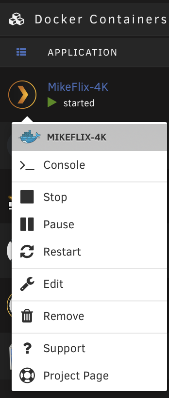

Hello @binhex
I noticed on unRaid 6.7.0 both rc1 and rc2 i no longer see a webgui option for plexpass version of your docker when clicking on the icon you only get console and the reset below...manually entering the url (ip:32400) works though so the docker itself is loading up

I also escalated there is no contextual link to the web-gui when you click the docker icon under unraid 6.7.0 (rc 1, 2 and 3) wondering if you could look into that too
