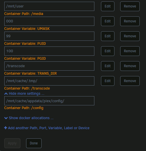

So I recently decided to move my plex metadata to its own SSD which isn't in the array since its getting huge. Fix Common Problems started giving me an error:
Event: Fix Common Problems - UNRAID
Subject: Errors have been found with your server (UNRAID).
Description: Investigate at Settings / User Utilities / Fix Common Problems
Importance: alert
**** Docker application binhex-plexpass has volumes being passed that are mounted by Unassigned Devices, but they are not mounted with the slave option ****
Now I've done some searching and seems I need to change the access mode for the dir. Unfortunately I can't do that for this dir as there is no edit/options. Any ideas?
Importance: alert
toggle "advanced view" top right
Wow.. I feel dumb now. Thanks again!

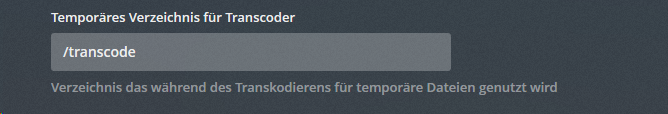

19 hours ago, chrissi5120 said:
'/tmp/pms-130a3668-5040-431d-b66a-de6554188549/EasyAudioEncoder/Convert to WAV (to 8ch or less)/3cczi7tbenbteicmmnzdvm5x_624-0-49.wav'
it looks like you are transcoding to RAM, is that the case?, if so check you arent running out of ram, as a test try switching transcoding back to ssd/hd.

I was transcoding to RAM all the time, no issues
the last update broke everything..
i tried to set transcoding dir back to SSD with no success, same log output
Edited by chrissi5120

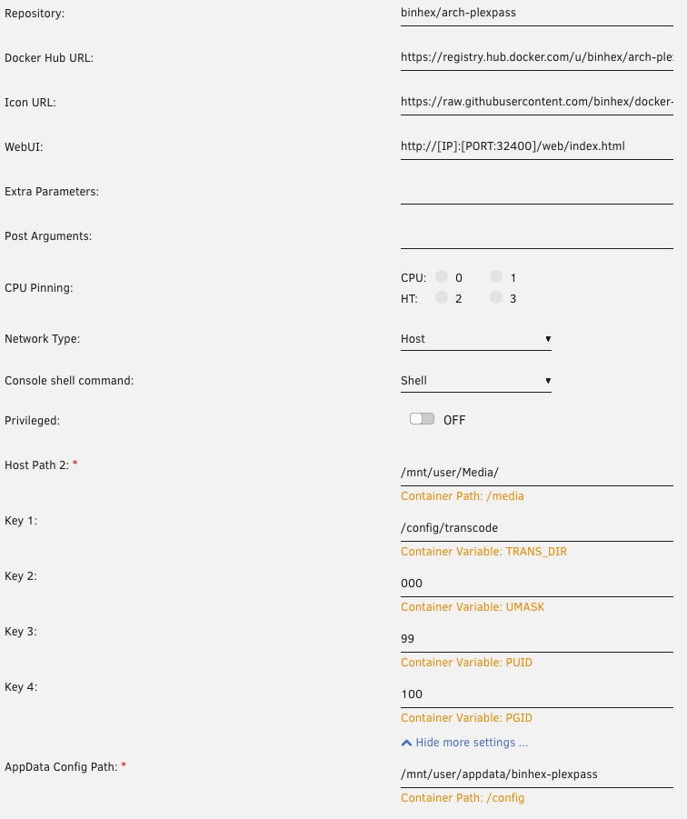

Hi guys, I've been running unraid for the past 3 months, and so far I've been loving it.
Yesterday I ran into my first issue.
I can't connect to my plex server.
My Logs say the following:
2019-02-22 08:14:50.091360 [info] System information Linux UnRaidServer 4.18.20-unRAID #1 SMP Fri Nov 23 11:38:16 PST 2018 x86_64 GNU/Linux
2019-02-22 08:14:50.122694 [info] PUID defined as '99'
2019-02-22 08:14:50.267939 [info] PGID defined as '100'
2019-02-22 08:14:50.408576 [info] UMASK defined as '000'
2019-02-22 08:14:50.441054 [info] Permissions already set for volume mappings
2019-02-22 08:14:50.471165 [info] TRANS_DIR defined as '/config/transcode'
2019-02-22 08:14:50.561746 [info] Starting Supervisor...
2019-02-22 08:14:51,011 INFO Included extra file "/etc/supervisor/conf.d/plexmediaserver.conf" during parsing
2019-02-22 08:14:51,012 INFO Set uid to user 0 succeeded
2019-02-22 08:14:51,014 INFO supervisord started with pid 8
2019-02-22 08:14:52,016 INFO spawned: 'plexmediaserver' with pid 54
2019-02-22 08:14:52,017 INFO reaped unknown pid 9
2019-02-22 08:14:52,119 DEBG fd 8 closed, stopped monitoring <POutputDispatcher at 23029063375328 for <Subprocess at 23029063375256 with name plexmediaserver in state STARTING> (stdout)>
2019-02-22 08:14:52,119 DEBG fd 10 closed, stopped monitoring <POutputDispatcher at 23029063375616 for <Subprocess at 23029063375256 with name plexmediaserver in state STARTING> (stderr)>
2019-02-22 08:14:52,119 INFO exited: plexmediaserver (exit status 255; not expected)
2019-02-22 08:14:52,119 DEBG received SIGCLD indicating a child quit
2019-02-22 08:14:53,122 INFO spawned: 'plexmediaserver' with pid 59
2019-02-22 08:14:53,159 DEBG fd 8 closed, stopped monitoring <POutputDispatcher at 23029063375832 for <Subprocess at 23029063375256 with name plexmediaserver in state STARTING> (stdout)>
2019-02-22 08:14:53,159 DEBG fd 10 closed, stopped monitoring <POutputDispatcher at 23029063375904 for <Subprocess at 23029063375256 with name plexmediaserver in state STARTING> (stderr)>
2019-02-22 08:14:53,159 INFO exited: plexmediaserver (exit status 255; not expected)
2019-02-22 08:14:53,159 DEBG received SIGCLD indicating a child quit
2019-02-22 08:14:55,162 INFO spawned: 'plexmediaserver' with pid 64
2019-02-22 08:14:55,199 DEBG fd 8 closed, stopped monitoring <POutputDispatcher at 23029063376120 for <Subprocess at 23029063375256 with name plexmediaserver in state STARTING> (stdout)>
2019-02-22 08:14:55,199 DEBG fd 10 closed, stopped monitoring <POutputDispatcher at 23029063375616 for <Subprocess at 23029063375256 with name plexmediaserver in state STARTING> (stderr)>
2019-02-22 08:14:55,199 INFO exited: plexmediaserver (exit status 255; not expected)
2019-02-22 08:14:55,199 DEBG received SIGCLD indicating a child quit
2019-02-22 08:14:58,203 INFO spawned: 'plexmediaserver' with pid 69
2019-02-22 08:14:58,240 DEBG fd 8 closed, stopped monitoring <POutputDispatcher at 23029063376192 for <Subprocess at 23029063375256 with name plexmediaserver in state STARTING> (stdout)>
2019-02-22 08:14:58,240 DEBG fd 10 closed, stopped monitoring <POutputDispatcher at 23029063375904 for <Subprocess at 23029063375256 with name plexmediaserver in state STARTING> (stderr)>
2019-02-22 08:14:58,240 INFO exited: plexmediaserver (exit status 255; not expected)
2019-02-22 08:14:58,240 DEBG received SIGCLD indicating a child quit
2019-02-22 08:14:59,241 INFO gave up: plexmediaserver entered FATAL state, too many start retries too quickly
Here are my configs:
The only change I did that's related was I installed Tautuli, which installed correctly.
any help would be greatly appreciated!
Dan
