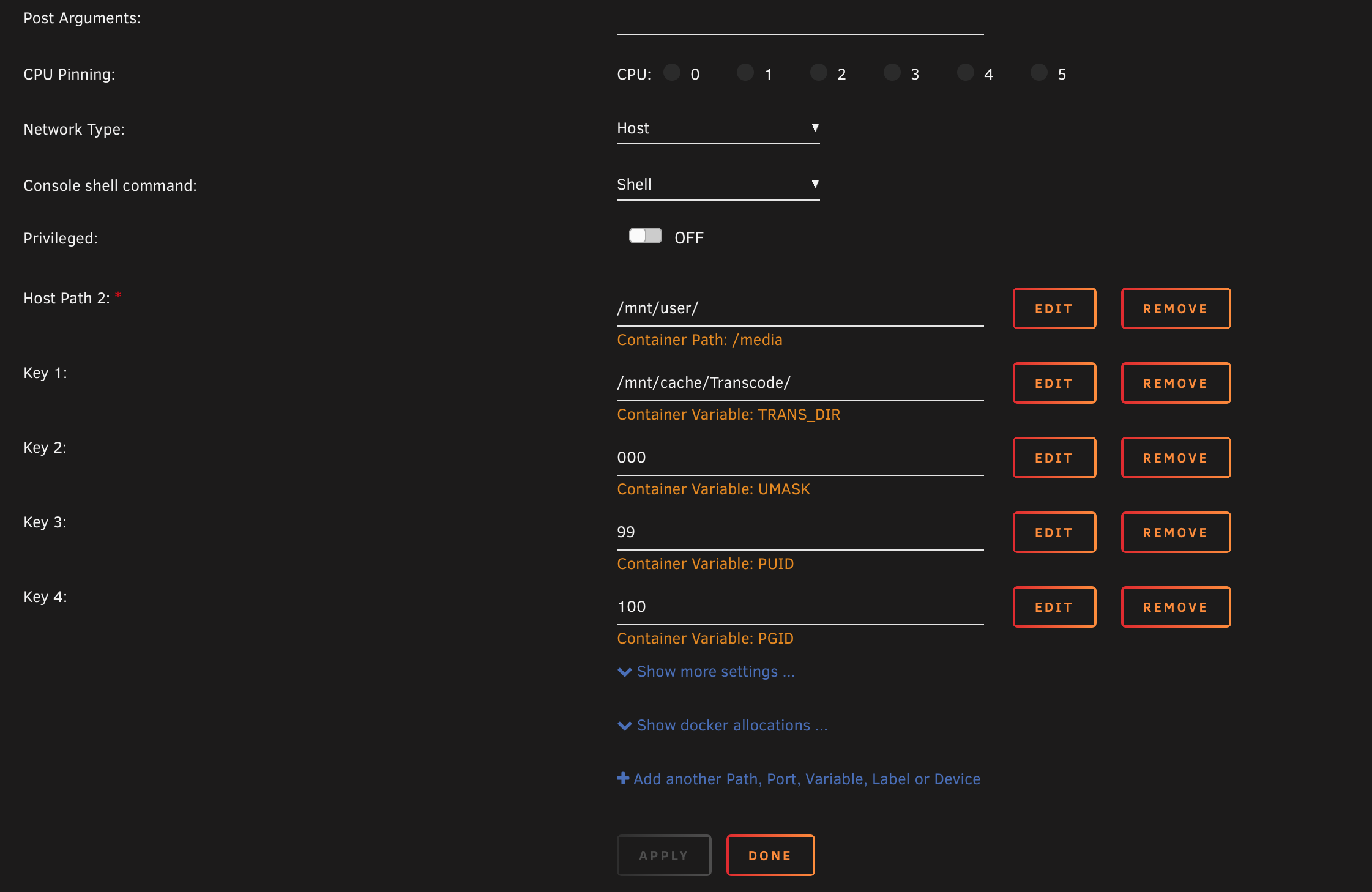

1 minute ago, zbron said:
Thanks so much for replying back - I just read over the attached link (thanks for providing the resource), and can't figure out exactly how I've messed with the volume mapping up. Below I've attached screenshots of everything I see in the advanced view.
1.thumb.png.7f960d79e38ea202e02d7b58deaaed46.png2.thumb.png.59bb3c2fd40bbe083d3fc078a2fc5f60.png3.png.80f0e956167061737ec88cf5fb450b29.png
ahh yep i see the issue, so TRANS_DIR is NOT a volume mapping, its an environment variable, this is used to define what the path is to your transcode folder INSIDE of the container, its not supposed to be a mapping to your hosts file system (as in unraid).
so what should it be i hear you say, well looking at what you are trying to achieve you could simply set TRANS_DIR to /config/Transcode that will then map via /config share to host path of /mnt/user/appdata/binhex-plexpass/Transcode (or something similar, depends if you customised the path for /config).
Thank you! The docker container appears to be working correctly now, really appreciate the help.

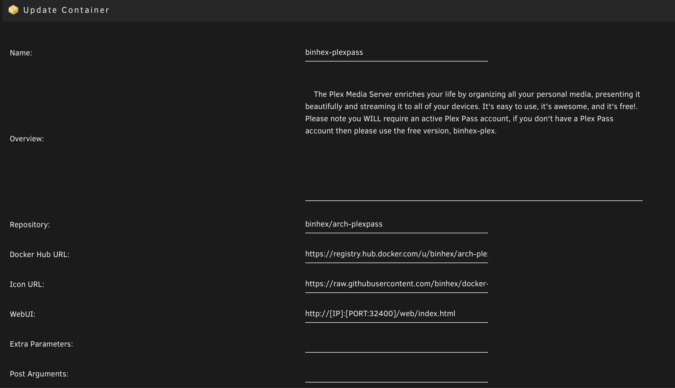

Hey there, sorry to jump on a thread - i just updated my unraid docker of binhex-plexpass and it seemed to update ok - but now its saying execution error and wont start the docker.
Not sure what to do?
only installed week ago or so from fresh - and now this is the first docker update.
Thanks
Ric
Thanks
Ric
Execution Errors when Starting an app means that there is a problem with the docker "run" command for whatever reason (probably conflicting port or something).  Post the docker run command as per
https://forums.unraid.net/topic/57181-real-docker-faq/#comment-564345
