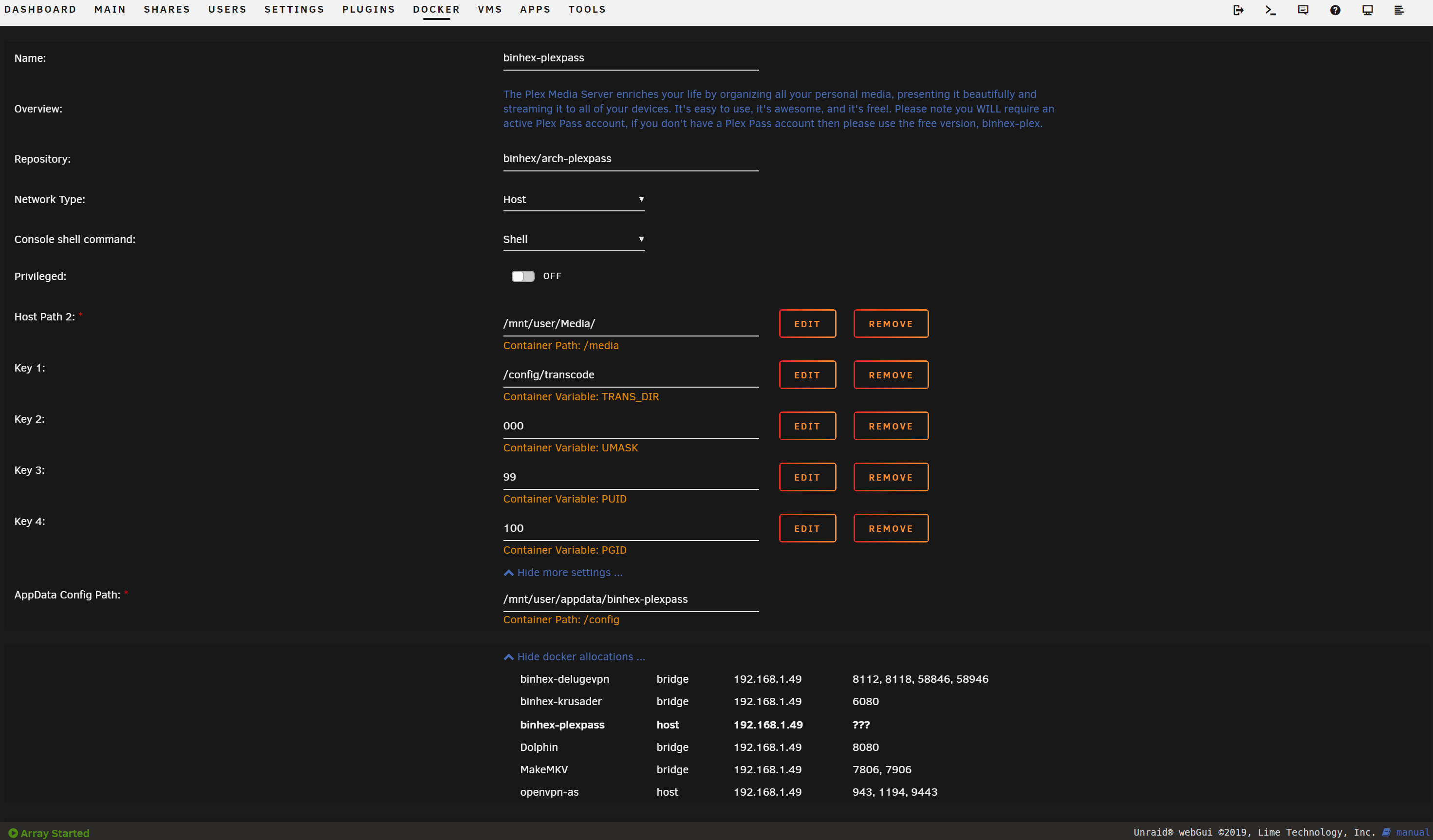

Rebuilt my libraries and still cannot access from my media players. Here are my docker settings. I'm banging my head on the wall again... Wish I never updated to 6.7.0. Nothing but problems since.
I see from your screenshots that you are still referencing /mnt/user... for /config probably worth changing that over just to rule out the fuse bug.

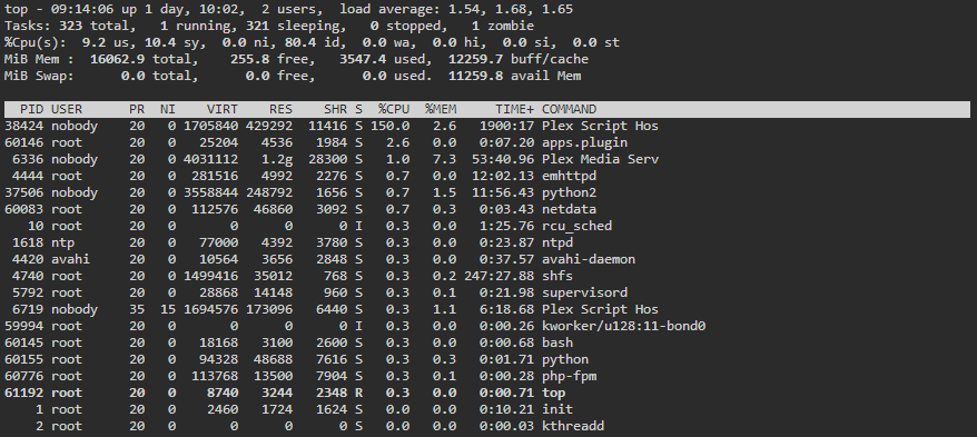

My Unraid server is using circa 20% CPU when idle (array is all spun down)
Seems to be Plex - any idea how to fix this?
EDIT: looking at logs I realised that Debug was on. Switched it off and restarted the docker. CPU is now 1-2% - will see how it goes.

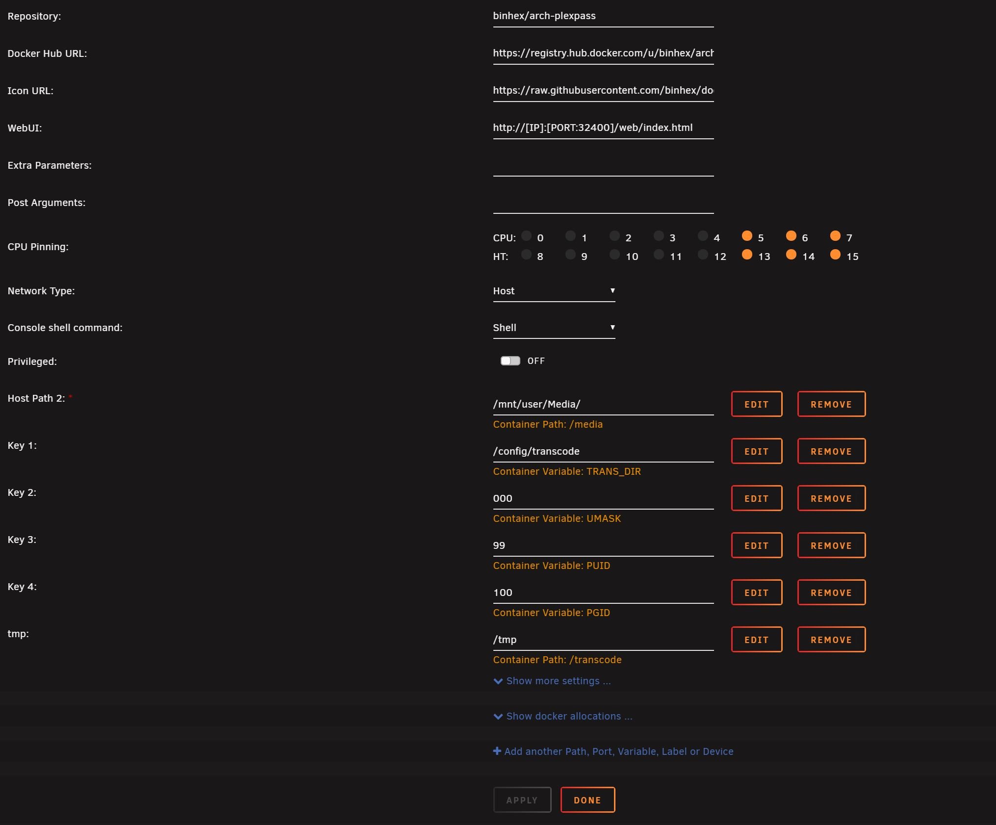

I'm relatively new to unraid and dockers.  But am using all of binhex's great containers to test things out.  Once I finally decide unraid is for me and purchase a pro license, I will definitely be gifting a beer or two your way @binhex!
I do have a question - I would like to set plex to transcode to RAM vs my SSD.  This article below directs you to add a new volume mapping /transcode to /tmp and then configure plex to use /transcode.
However, I'm unsure if I should do that, or if using binhex's template, I should utilize the Container Variable: TRANS_DIR that is currently pointing to /config/transcode and change  TRANS_DIR to point to /tmp ?
Thoughts?
I'm relatively new to unraid and dockers.  But am using all of binhex's great containers to test things out.  Once I finally decide unraid is for me and purchase a pro license, I will definitely be gifting a beer or two your way [mention=11148]binhex[/mention]!
Thoughts?
I have a faq for that [emoji16] see op link to documentation then go to the Plex faq its in there

i am getting "There was not enough free disk space to start the recording" any person know how to fix.  or should i go back to the regular plex.
We would have to know where you have plex configured to store recordings, and whether or not that path is mapped to Unraid storage with enough free space.
Post a screenshot showing where you have Plex storing recordings, and also post your docker run command as explained in the first link in the Docker FAQ:
https://forums.unraid.net/topic/57181-real-docker-faq/
it is pointing to the right place if i delete a file it will delete it the directory
Can't quite parse that but in any case, you haven't told us where plex is saving recordings. Is it within /media?
