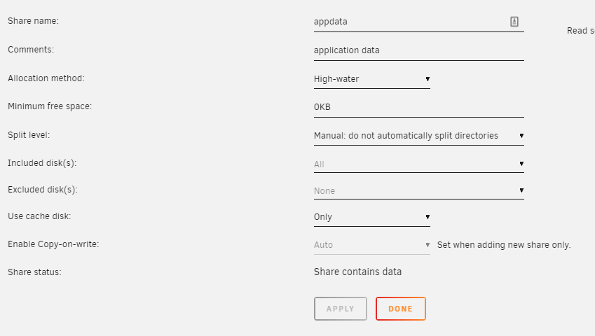

Ok so I deleted my binhex-plexpass and set everything (I think) to /mnt/cache/appdata however it looks like it created it back in mnt/user instead of mnt/cache...
But it's also in the cache, is that normal?
Edited by LumberJackGeek
Each array data disk plus the cache pool are part of the user shares. So any folder on any disk is ALSO in /mnt/user. If you created the folder on cache then if you look in /mnt/cache you will see it, but you will also see it in /mnt/user. The user shares are simply the aggregate of all top level folders on all disks. That is how Unraid allows folders to span disks.
Ahh ok, that makes sense now that I think about it. Thanks for the prompt reply, trurl! Still trying to learn all the oddities of unRAID, and it's been about a decade since I've used Linux so I am just drinking from the fire hose right now..

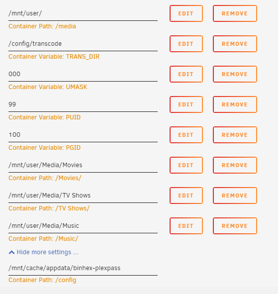

Hello. I love your dockers! Thanks for your time in creating and maintaining them.
I want to add my photos and my music to my PMS, however these files are currently stored in completely different folder structures on my server. SHort of moving those files to a common media folder, is there a way I can add additional media paths to the docker so I can add these libraries to Plex?
Of course. At the bottom of the Update Container page, click the '+'.
I tired that, but did not find the new path available. But it turns out this is me being dumb....I never restarted the docker!! SMH at myself. Thanks trurl.

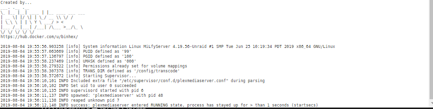

can anyone explain whats going on here
its effecting the watch status of this show in particular, and i'm not sure why
My server plex dissapear :S
The docker start fine
But i cant see my server, what log i need to see?
