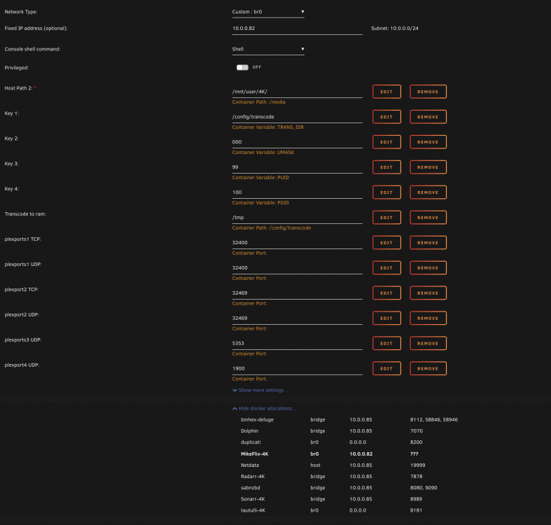

4 minutes ago, binhex said:
correct
hmmm i added them and still a no go unless i did something wrong here is the docker config, i see the docker config section doesnt understand what ports displaying "???"
you havent defined the container port, you need to set the host and container port for each port i listed above

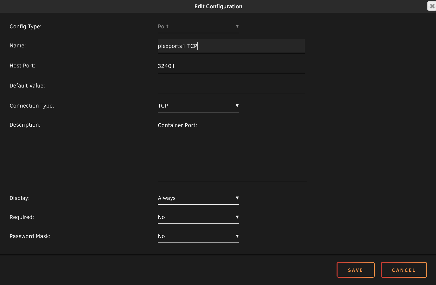

hmmm i went to add port and container port is the only option, host is not
***doh my bad add to description
Edited by Can0nfan

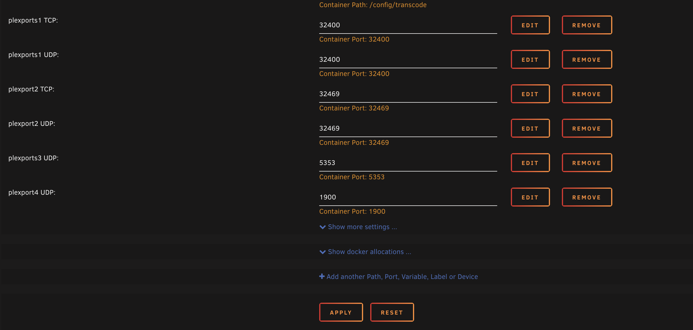

your screenshot looks a bit wacky!, it should look like this:-
note you will need to switch to bridge or custom bridge first, then apply, then edit again and then add the ports, defining both container AND host port.

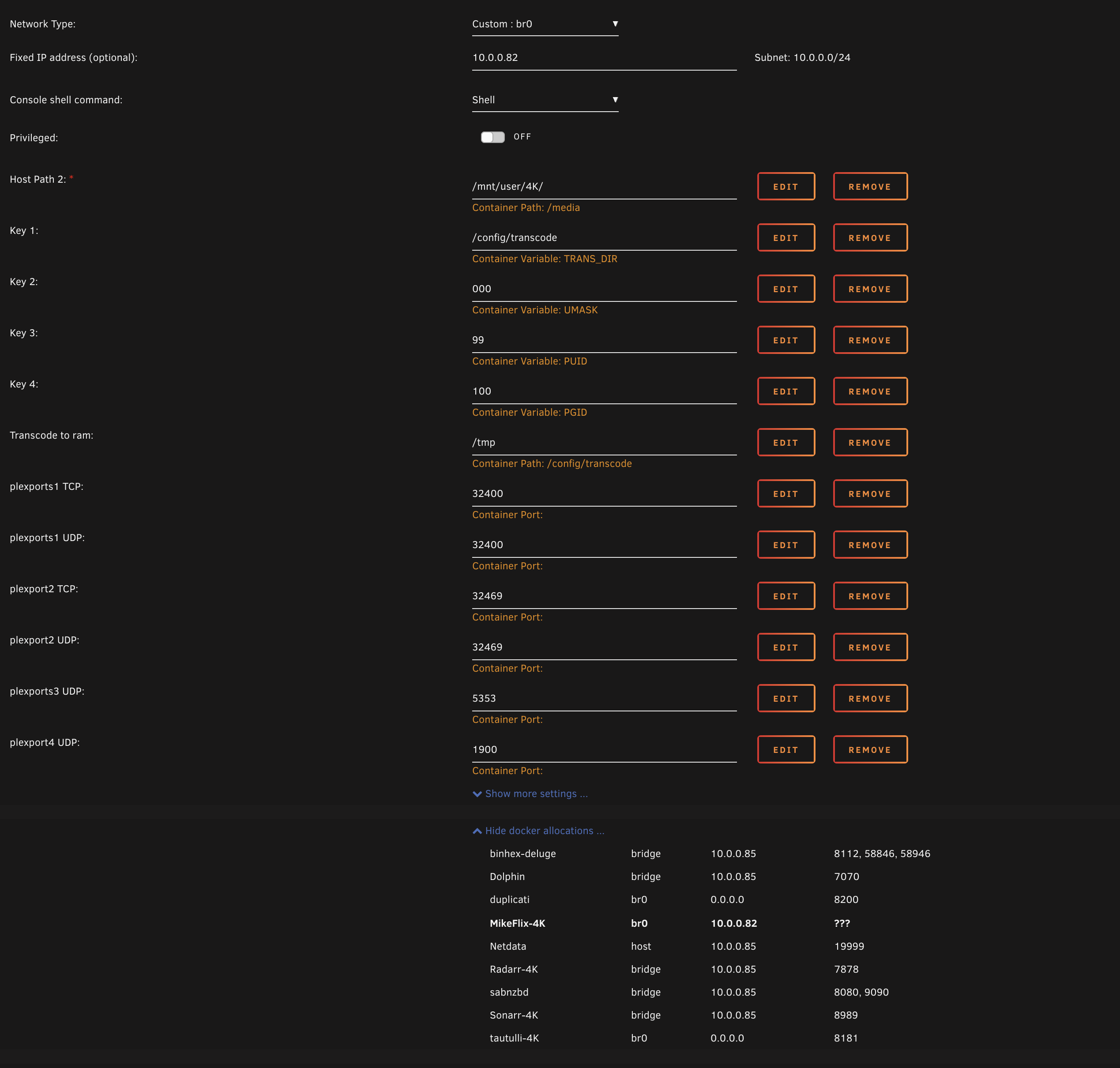

ok not sure if im really doing this correctly... still no gui option

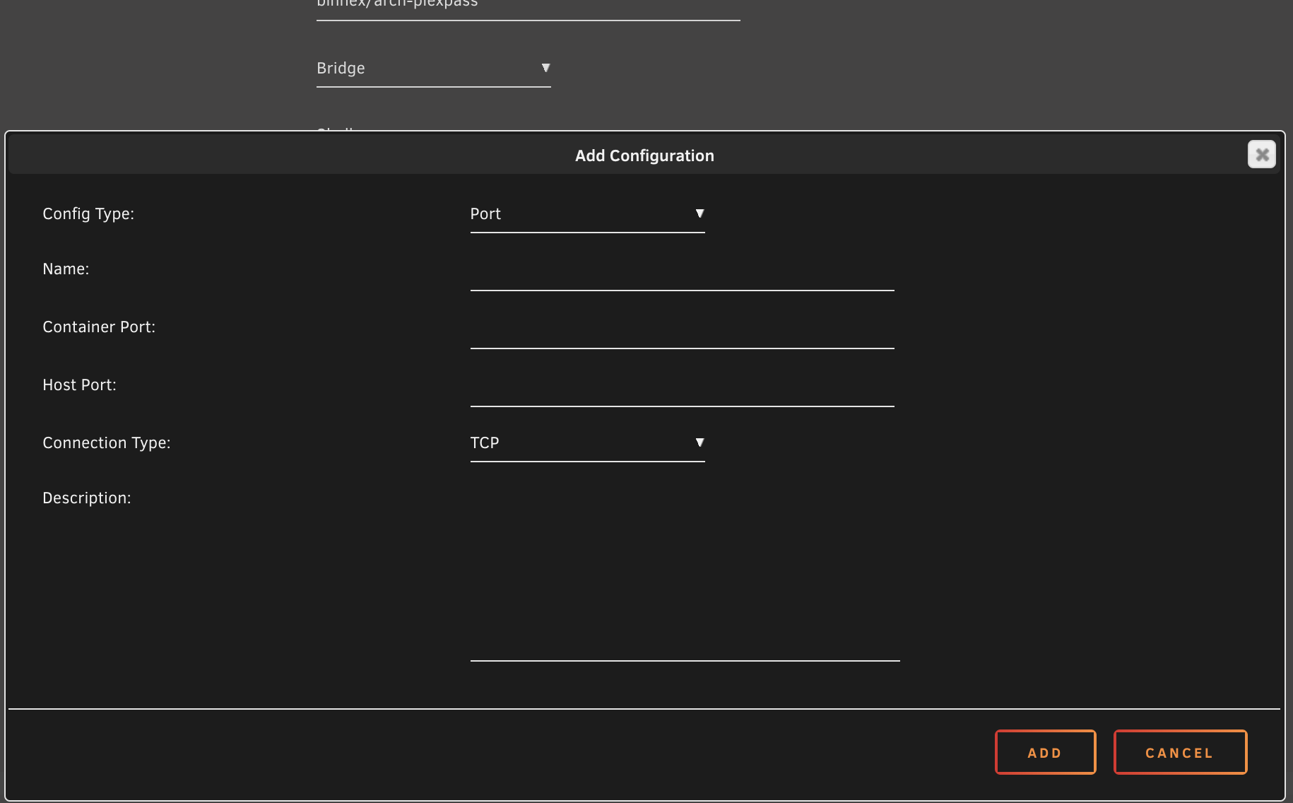

ahh ok that makes sense ill do that and report back thanks. got to get ready for work
yeah my unraid 6.7.2 isnt giving me the same options you have
host and bridge show the same window
man im blind today sorry about that
Edited by Can0nfan
im blind apparently
i dunno its still not working i went to host, defined both container and host applied it then edited back to custom br0 and webgui option went
wondering if unraid is blocking those ports from a defined linux firewall ill check into it tonight when i get home
hmm so custom bridge seems to have a limitation/bug, if you choose custom bridge then it looks like you cannot define both host and container port, so yor only option is default bridge (or host of course).
