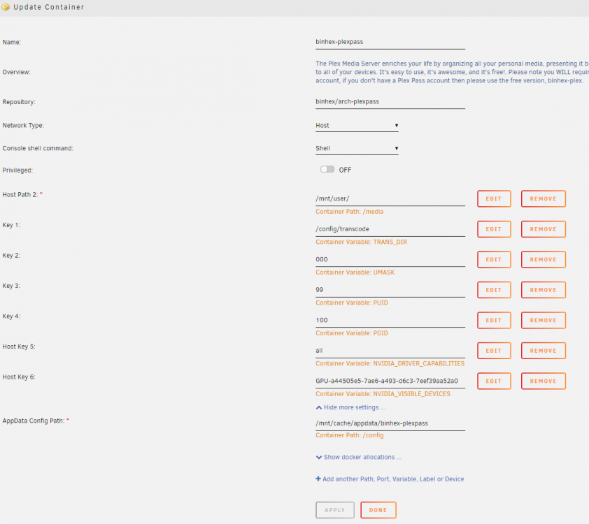

Hello,
I just updated to the most recent docker version: Container ID 04de605cabe4 and am getting errors:
Plex Plug-in [com.plexapp.system]: error while loading shared libraries: libpython2.7.so.1.0: cannot open shared object file: No such file or directory
2019-08-26 11:15:29,351 DEBG 'plexmediaserver' stderr output:
2019-08-26 11:15:29,357 DEBG 'plexmediaserver' stderr output:
Plex Plug-in [com.plexapp.agents.htbackdrops]: error while loading shared libraries: libpython2.7.so.1.0: cannot open shared object file: No such file or directory
I've researched the error online and most common fix was to export LD_LIBRARY_PATH=/usr/lib/plexmediaserver. I added that to the docker config but the errors still persist. Any thoughts on what might be the issue?
2 minutes ago, brianbrifri said:
Hello,
