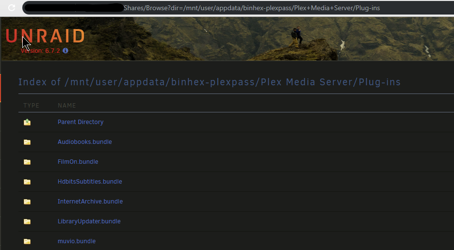

Not sure is this is where this should go if not let me know.
I had some custom search plugins in my old server but unsure how to get them installed and working in this docker.  Can someone help me out with this?  I have the files downloaded but not sure where to put them and cant remember if they need to be zip or unzipped.
My super lazy way to do it, is add the appdata directory as a share for a moment:
Then I can just copy the files over from whatever machine is convenient (While the plex container is stopped). You could run into some permissions issues, but those can be resolved from a shell without to much difficulty.
Edit: Just remember to remove the appdata share when you are done...you don't want that shared/public most likely.
Edited by paperblankets
More detail
That worked thanks.   I just copied the stuff over in the console using the /media share that was already there.
