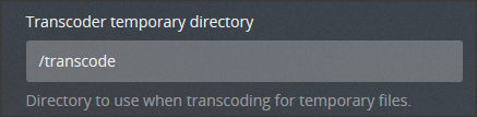

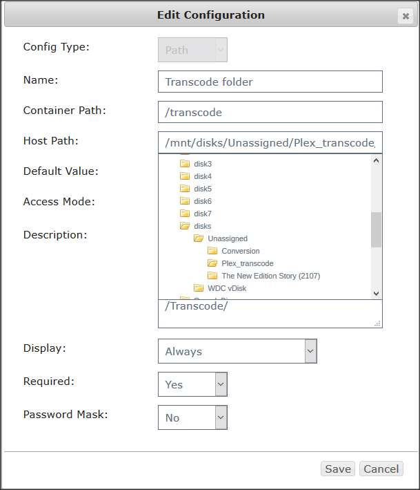

Just a question in relation to the transcode drive. I had a spare 120gb ssd lying around and im looking to use it specifically for transcoding. I'm trying to lighten the writes on my cache drives as much as i can... I have it mounted with unassigned devices and I'd like to now use it for the transcodes.... I created a container path pointing to it and put the corresponding path into plex but when monitoring it it doesnt appear to be using it at all. I also tried changing the TRANS_DIR container variable but that just broke it which i kinda expected.
Any body know how I go about getting this working??
Here is an example…. I don’t use binhex container right now, but it shouldn’t be to much different.
I have configured Plex to use the folder /transcode (this is what the Plex app in the container can see).
Then I have a folder mapping for the Plex container that maps /transcode inside the container (Container Path:) to a location outside the container (Host Path:)
In this case I have mounted an unassigned disk (not belonging to the array and not a cash disk). When browsing unassigned disks will show up at /mnt/disks
I have labelled my unassigned disk to Unassigned (otherwise I think it will show up with its s/n). I have also created a folder Plex_transcode on that disk that I will use.
The Access Mode: should also be set to RW/Slave
/Leif
Edited by Leifgg
im an idiot.... simple typo was causing the issue... sorted it out just going to check and make sure its writing to that disk now. fingers crossed thats it
Yup thats exactly the issue. writing to the UD ssd now. Thanks
