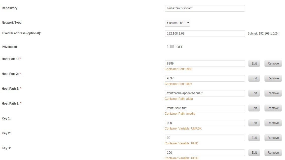

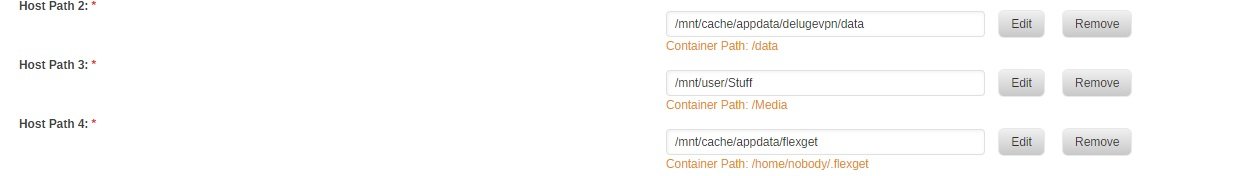

Getting
Import failed, path does not exist or is not accessible by Sonarr:
on all downloads from Deluge.
I got the mappings to both Deluge and Sonar to the same path on Unraid for Media and Data respectively.
I can log into Sonarr container and move the file as nobody fine so not a permission issue.
Any pointers?

4 minutes ago, Squid said:
You should post the entire error message and the mappings for both deluge and sonarr
Sent via Tapatalk because I'm either at work or enjoying the summer
sure
Import failed, path does not exist or is not accessible by Sonarr: /Media/Downloads/Colony.S03E11.Disposable.Heroes.1080p.WEBRip.6CH.x265.HEVC-PSA.mkv

8 minutes ago, nekromantik said:
sure
deluge
sonarr
What happened to the container path /config ? It's missing from both your screenshots.
Your paths are all messed up, perhaps it would be easier to delete those templates and start from scratch, follow gridrunner's videos.

Your passing through /Media on one app and /media on the other. Linux is case sensitive, so those are two different paths
Additionally, once you fix this it might not take effect until new downloads happen. Old ones may still reference the incorrect mappings.
