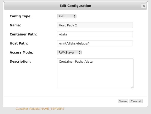

9 minutes ago, TechMed said:
The 'how to' on path editing is what has me confused.
It’s fairly easy. Go to Dockers tab and select the docker you want to edit. This is what the /data path in my Deluge docker looks like-
This is an example of a standalone UD path. If you click the edit button you'll get this popup window-
You just need to replace the host path with your new one and be sure access mode is set to RW/slave. You'll need to do this with Sonarr, Radarr and any other torrent dockers you use.

I have the binhex delugevpn, sonarr and radarr Dockers installed.  When I turn the proxy on in sonarr and/or radarr and point it to the privoxy that is installed as part of the delugevpn docker...the indexers test successful then 15 minutes or so later they fail and the the indexer gets disabled until I test it again.     In sonarr proxy is on and using http(s) with unraid ip and privoxy port.
Any suggestions?
