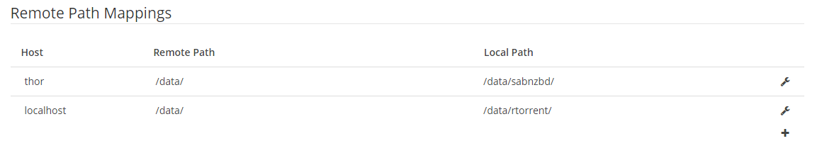

Please forgive me, im still new to servers and network. So im not sure if its Sonarr related or due to my download clients run though VPN aswell.
Anyway, I have an issue with Sonarr not connecting to rTorrentNPN or SABnbdVPN in br0 mode. Sonarr cant find my downloaders then.
The reason I want to do this, is because I have several downloaders and I run with remote path mapping to make sure Sonarr grabs files from the correct folder (my downloaders are mapped directly to the subfolders)
My optimal solution was to keep the containers in bridge mode and connect to the downloaders with hostname :) ( have added a hostname parameter to containers)
I have made a workarround, but imo not a viable solution if I get more downloaders.

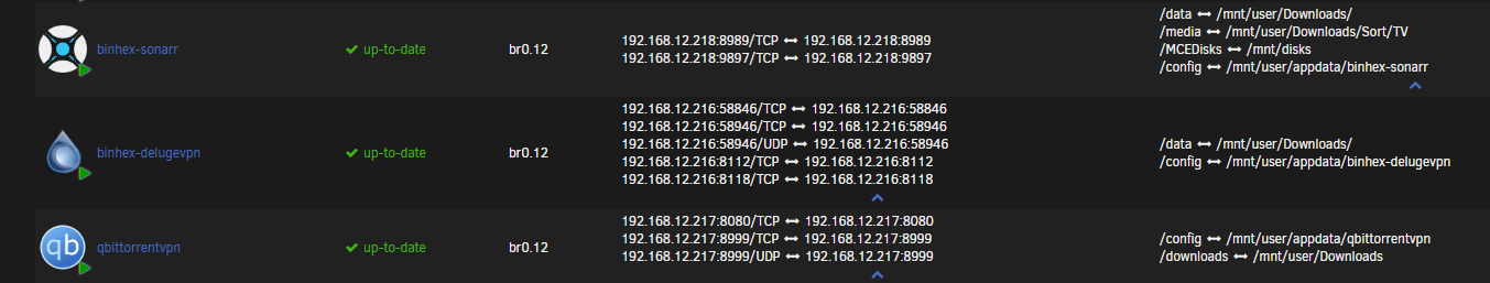

It's me again!!
I'm getting this message in the sonarr log:
Import failed, path does not exist or is not accessible by Sonarr: /downloads/Sort/TV/The.Circus.S03E12.HDTV.x264-aAF[rarbg]
My docker paths look like this:
This is how qbit is setup.
Thanks

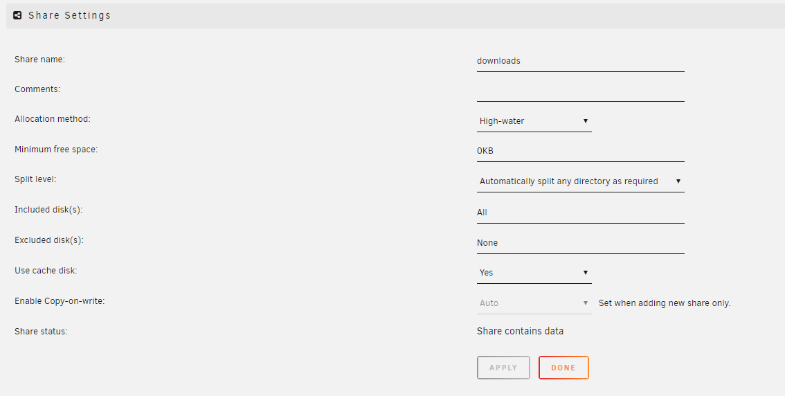

EDIT:
I changed my share from "Downloads" to "downloads" remapped everything in sonarr, and in qbit, and changed the /media to /downloads in the sonarr container and my media is being sorted now, i do now see this in sonarr though.
Edited by karldonteljames
Because the host path mappings don't match between containers. The other two are using /data and qbit is using /downloads. Edit qbit accordingly then change its settings to store into /data

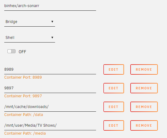

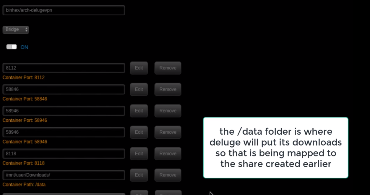

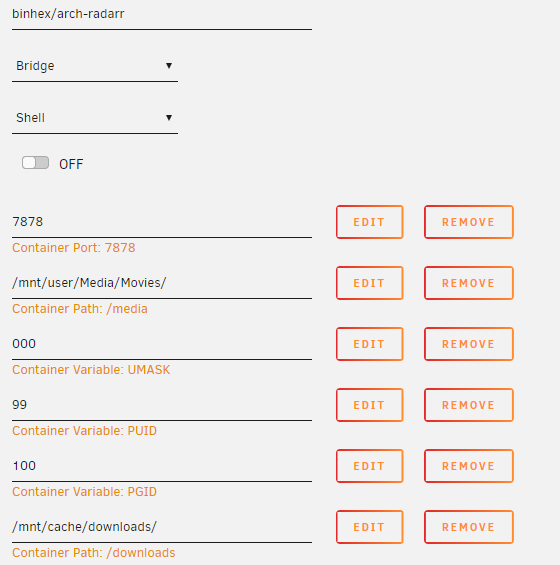

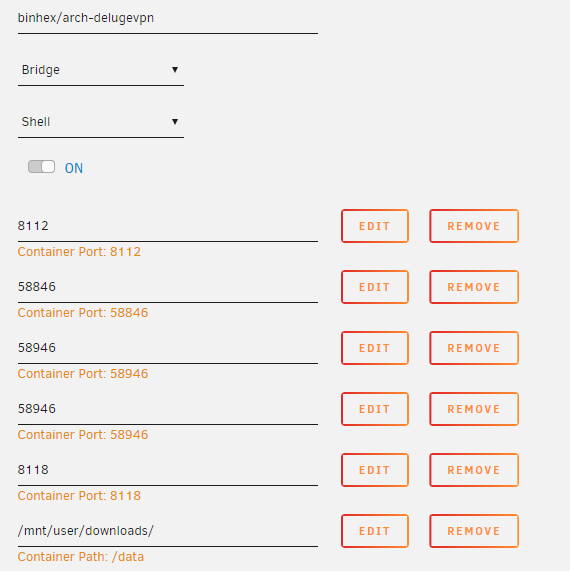

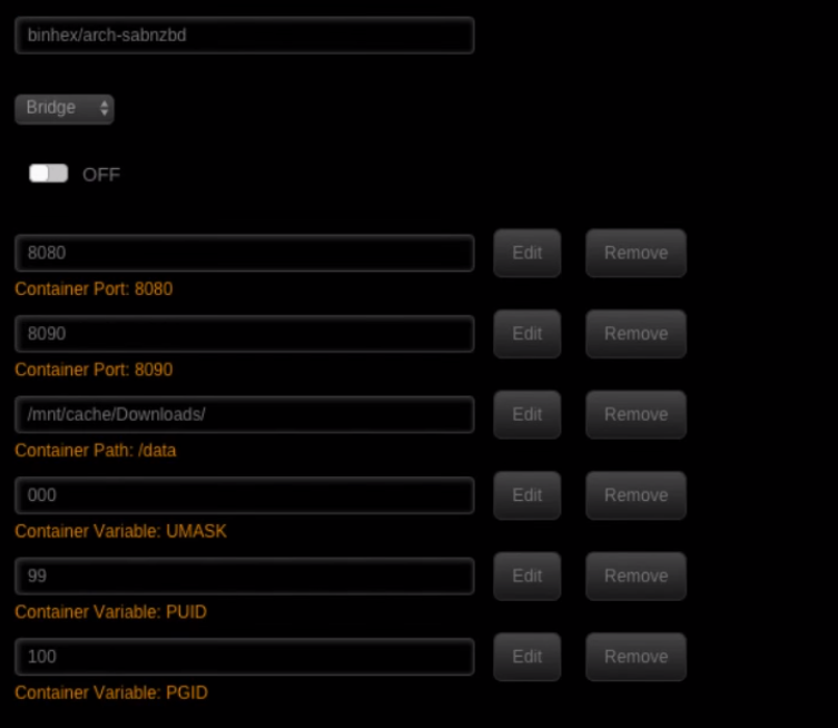

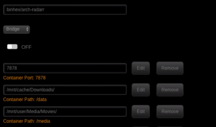

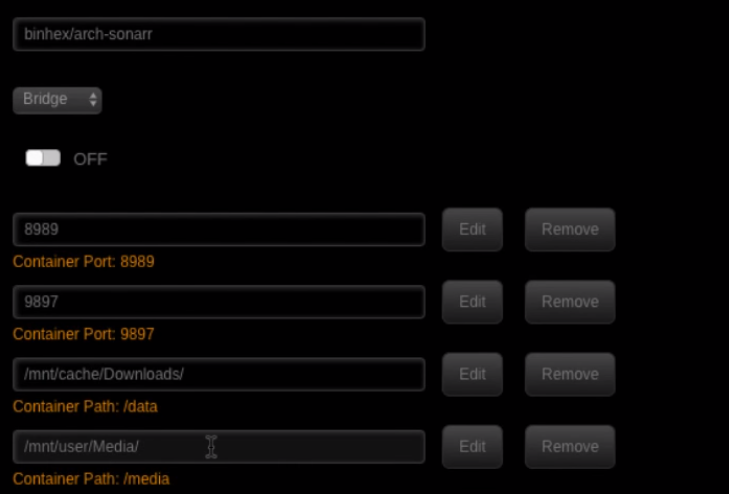

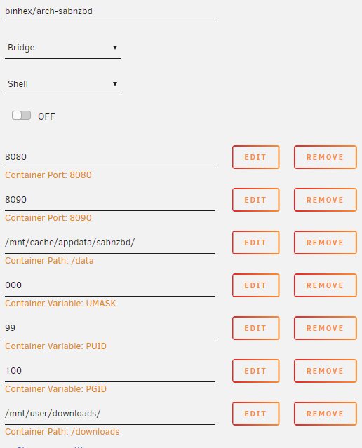

Ok that worked so thankyou for that tip, now I am having issues with TV shows not being renamed correctly or moved, again this is not an issue for Radarr only Sonarr. I followed the setup guide in the video below when it came to setting up the downloads folder, I then set it up the same in Sab and Sonarr and Radarr as per the video. I noticed while watching the video that the Downloads folder location appears to be different depending on the Docker install, I added a couple of screenshots below showing all the points in the videos where SpaceinvaderOne sets up a share, docker etc.
Post YOUR screenshots of the mappings, not ones from the video.
Here they are.
Your path mappings don't match between the containers
Some of the containers are using /data for /mnt/user/downloads, and others are using /downloads.  You've got to keep it consistent between all of them.
Ok that makes sense, I guess I should have figured it out myself as this seems to be a common issues for many users.
Just make sure that if you adjust the mappings on the DL clients that you also adjust their settings as where the downloads are actually going.
