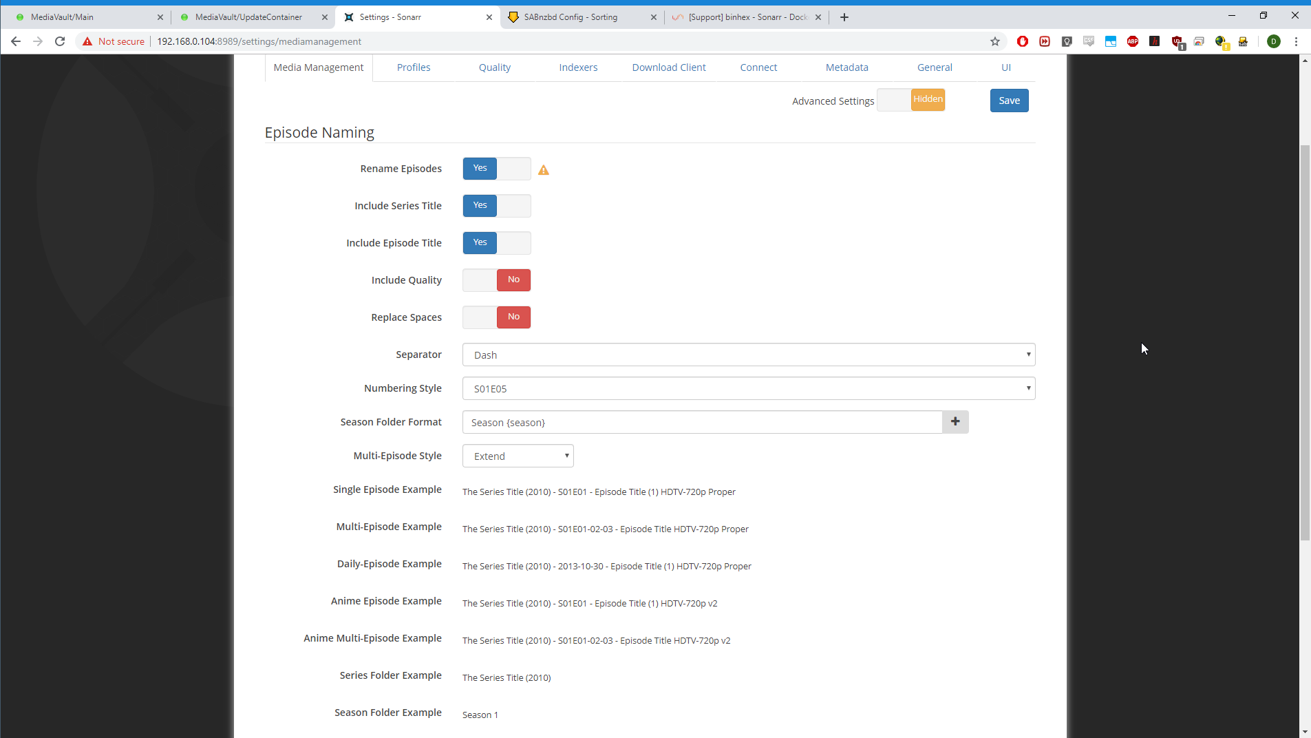

So I'm having an issue where my episodes are downloading, but Sonarr is not renaming and organizing them properly. SABnzbd seems to be downloading them fine, but then they just sit in my completed folder instead of being moved to the TV Shows directory so Plex can see them.
I have the Media Management settings turned on here:
But when I look in my completed folder, see this:
And Sonarr should be able to move them to the correct directory (rather than copy) so I don't end up with duplicate files, correct?
Check your mapping correctly and everything is in the same case. I had similar issue few post back. You want your Data folder to all point to same location for all your containers.

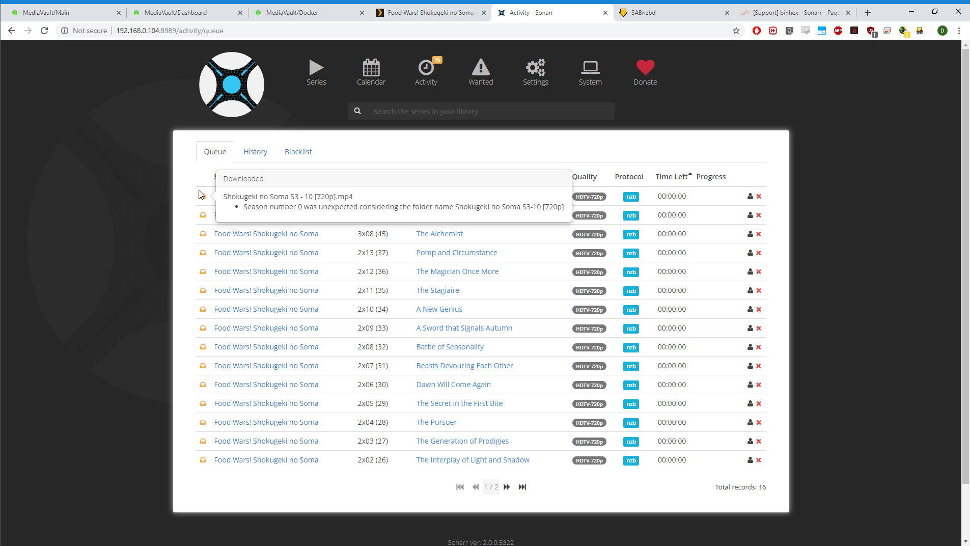

So I checked that and it seems to be ok because I see files coming through:
The problem is, there are only some files that it is renaming and moving. If I look at my usenet_complete folder, I see this:
What would cause only some files to be renamed and moved? And is there a way for Sonarr to scan for completed files to rename and move?
After looking in the folders, it almost seems like it's erroring out before it can complete everything as there are little files left over:
@trurl Bumping this to see if you may know why it's doing this. I just downloaded Season 1 of a show, and that downloaded, renamed, and moved the files no problem. Clicked to download the second season, which it downloaded but the files are just sitting in the completed folder.
What does the “Activity” window in Sonarr show? This should give some sort of indication why the app was unable to move/copy the files along with an option to manually import.
