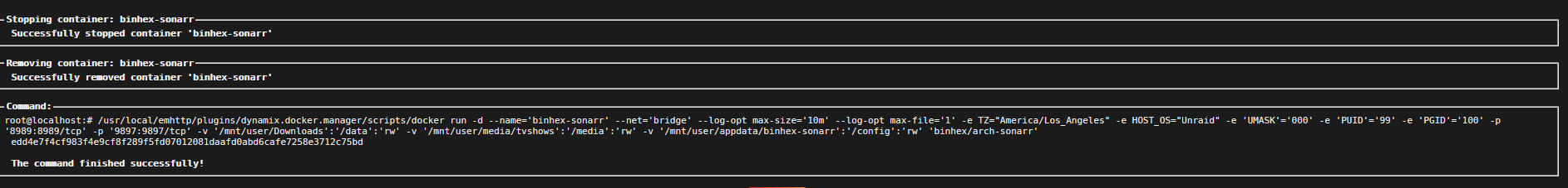

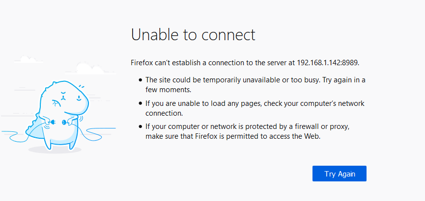

Went to go add a new show to my Sonarr today and I can't seem to access the WebUI....I have tried restarting the docker, stopping other dockers, reinstalling the docker, as well as rebooting the server.  All to no avail.
Any help would be greatly appreciated.
