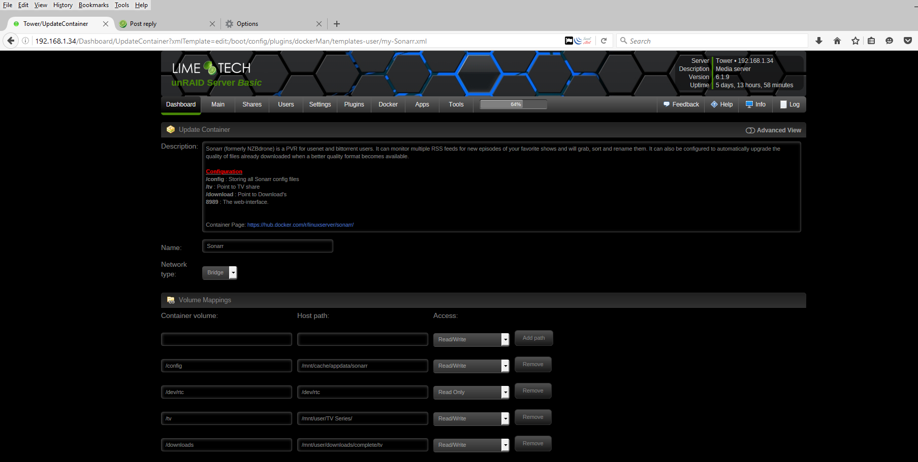

Hey Binhex,
Kudos for the Sonarr docker.
I've just transitioned from Sickbeard to Sickrage and now to Sonarr.
Not sure if I've set Sonarr up correctly but I think it's looking for downloaded files in my /config directory not my /data directory.
Here's my config setup for the docker file:
y3mIDPcERXHdgXsnODSulBv-lX77fVEu3bJ9vu6MkxHy61f76y-NMYUzA9nerDf8AkCSUUNkICkrbjUQucXy3hUiCf_TGEjY7PMqMGBp0X1vvhkD0uFwkvuE93T2P0TGOvfB0DFGruRASFQezCWXnD-ag?width=1280&height=62&cropmode=none
As you can see, I've specified my docker as per the instructions:
Configuration
/config This is where sonarr will store it's configuration file, database and logs.
/data This path is used retrieve the downloaded files by your downloader application.
/media This is where sonarr will scan for media files.
Unfortunately, the docker appears to be looking in the /config directory for downloaded files:
y3mAExY3J3nrxCWF-edFj_I99L4AY0WvrH_HpFTELl2E2IGb5tqmDqdcUeAdIGmej0g3UU_kpiYgkK10mBPaWvDOSzjz_-_rkpWYW_CSEqf8QPt0p86vYXYaRZeATpp3EhAnue3koUy33uS2a6RvVIaLA?width=1154&height=395&cropmode=none
Here's a screenshot of the System Page on the Sonarr GUI:
y3m87XMkU0KjHXO93BB4pE3U2vXuV2V05Uhk58V0eeMqk6RngPllBM3xjHhGJoO3kBR31XRgfnybljs9B0qBJH2mLUMpgMy8T62uVdEAb4gIcWRkys5Z3Qbx2IkYba5Nli6G7JH_CG3fVay8inK8ghKJg?width=1168&height=522&cropmode=none
I have to carry out a manual import after each show completes its download, not ideal.
Here's a screenshot of my log file:
y3mMSz1Q2PybspQwzF9QlybmrvOimD7Q2jEWXJcM54REMnV_GQ6Ljv8UvLSFwKxYjUPKe32T2-Ye3OL4QGHoUFfuCoQ6kErzZog66gJTyqnM9mNmc44zLENtxwzyE9oDcdNYPagNPX3IoRy3I73i5ZYVA?width=1272&height=1088&cropmode=none
Any help would be appreciated.
Cheers

Because your download client is storing the completed download within ITS /config folder and then passing that path name to sonarr.
Move completed downloads to (in this case /data) a separate download folder that is mapped to all apps that require access to it.

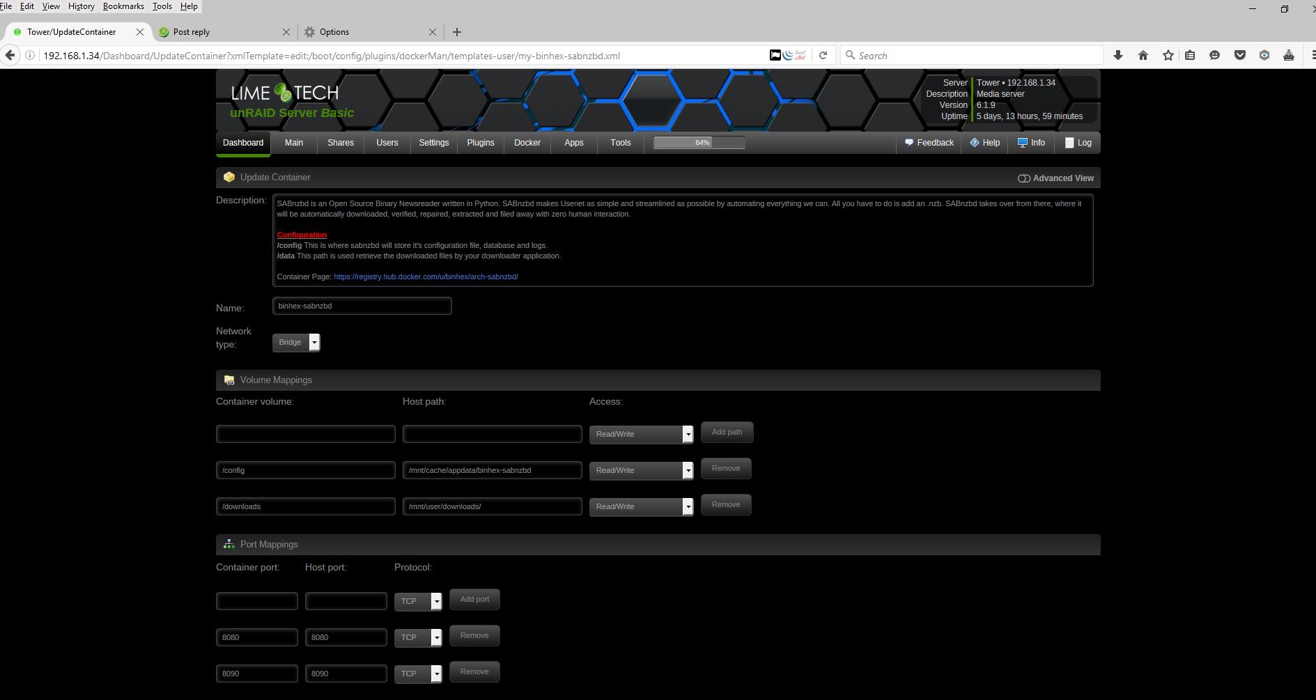

Hey Squid,
Thanks for the reply.
I'm not so sure that is my problem. I use SabNZBD as my download client and specify the downloads to go to it's /data location...
y3mmlLZsgEhit2zYJ9OV93_33oIeRxToH_DdvbQQ1CkFm2kWlHka-319QfAu19Y-q0eY39sDUiYUXsgeS6iSDu_2ambizaN-y3XSLBu3fYkovoeKnUZPDkrvopgE1KCZPifEsw752RMB7Z_RixPyE1NNw?width=1302&height=60&cropmode=none
That's the same /data location I map for sonarr, so I effectively have in place already what you suggest (unless I'm missing something)
Kev
Are you sure.  The answer lies in sab settings
Sent from my LG-D852 using Tapatalk
Hey Squid,
At the risk of hijacking this thread...
Thank you, you are correct. The problem was within Sabnzbd settings. However, I still can't seem to get sonarr to automatically import the downloaded file.

the key here is that on all the docker apps which are required to talk to each other (in this case, sonarr, sab, and probably cp) the mappings (host and container) on the template (edit screen) for the download location (in your case the /data) have to match EXACTLY.  If you've mapped /data to /mnt/cache/downloads/completed on one app, and mapped /data to /mnt/cache/downloads on another the imports are going to fail
This solved my problem!!!
Thanks Squid.

Hi
I am really sorry I am total newbie to UNRAID although long time user of SAB, CP and Sonarr for NZB, in windows server. I installed UNRAID, Plex, SAB, CP and Sonarr and paid for UNRAID service to check it all over(and correct some errors).
  I used all Binhex plugins as was told they were well supported and good (will make beer donation when sorted). Now everything is perfect and I am now happy with server with one big exception. My downloads all download fine, unpack and repair then I dont know where they go, they dont appear anywhere in my media folders, please help as I don't want to go back to Winblows.
Many thanks

Hi
Here is my other settings

You probably have to specify in both SAB and sonarr that you need to save the downloads to /downloads.
Also you should map /downloads to /mnt/user/downloads for sonarr too, and instead use /downloads/completed/tv inside sonarr.
Hi
Thanks for teply, unfortunatly didnt work.
K
