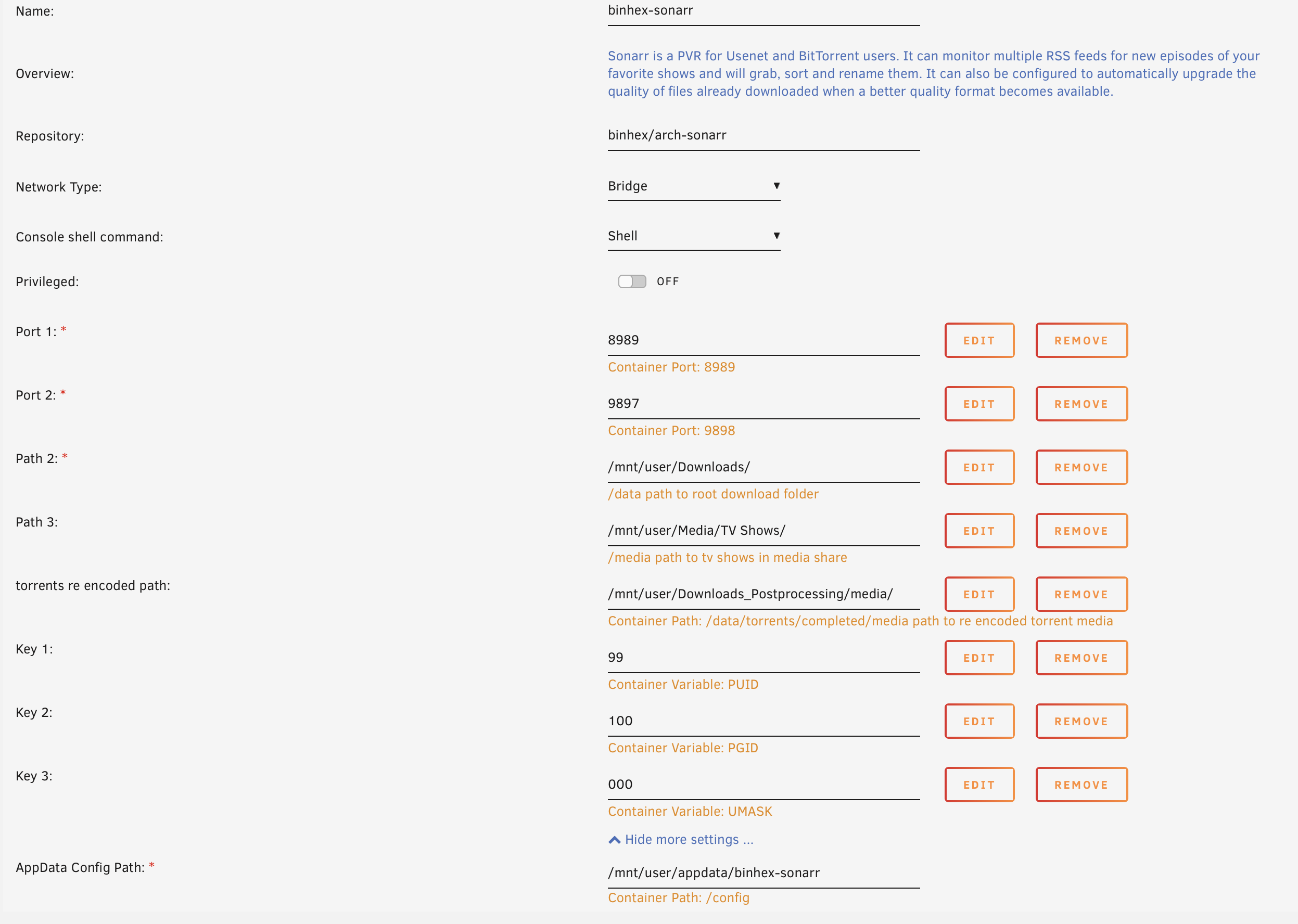

Hey guys trying to figure out a file path issue. I’m trying to get sonarr to automatically download shows and out then in a folder for tv shows. Below are my configurations for deluge jacket nzbget and sonarr. Sonarr will start the download in deluge just fine but the files are never moved (I think by sonarr) to the final media location such that my Plex server will pick them up. Any advice you guys have would be greatly appreciated as I’ve been watching countless videos and reading and obviously I’m still missing something....
2c1fb003cd97de228d90be2f0494fe9e.jpg&key=8b0cc0097614fdd6d2c8be13f3421ad6be0a5c189346094af292e2ecd81e767cbf0496b56c6dd6f254eeef38ce76220e.jpg&key=3ad4298664bbfa8c349d972cec2fdc4c57e32336fceca6c6eeae1095ef39611cfbd6713c36b0e54eefc61885fa824228.jpg&key=9d1035a5357f891e5a4d2498bf5afde7301b647819b0e4f12ed3af1bd0feb8e652ed440d0fae96dc9c8768643a5fb5e4.jpg&key=2287b5c393b7ed994af3d48abb0f4f2dcdb669b62c0b6ccea689ead6a3dcab915083a8e63650e8d734e96d19a99a61c3.jpg&key=de8fe9226c1e4d3601c375773df80d09c27bb65b17864537c1f21e9a5ac6f2ee
Just to be sure, do you have media handling enabled in the Sonarr settings?
