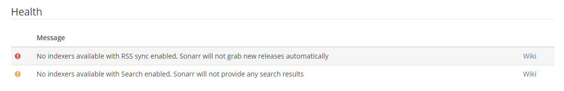

Under Health these 2 have just shown up - RSS is ticked in the Indexer so could it be the site i am using? Which is limiting my RSS access?
Edited by IKWeb

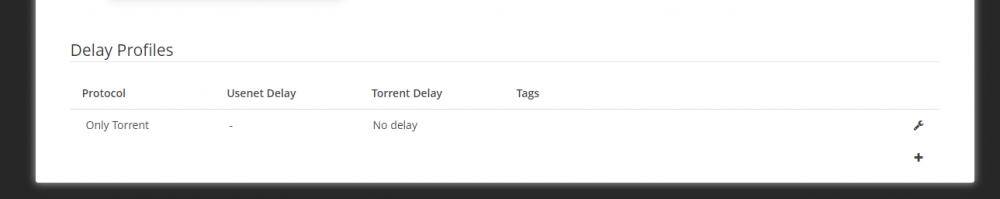

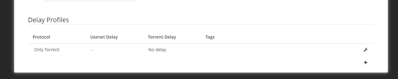

What do you have set in settings>profiles>delay profiles? I’m not sure but it looks like if that is set to “usenet only” it might not search torrents.
I think it could be an issue with the website itself I am using as an Indexer - Looking though there forums now. Maybe time to find a new one 😞 shame most of them are invite only these days.
OK - So the above is with the service I use. I have had to install and setup Jackett - Which is now allowing Sonarr to download a file via the site.
I am now waiting on that downlaod to finish to make sure it moves it and puts it in the correct location once its downloaded
fingers crossed
I think you need Jackett for all the torrent indexers.

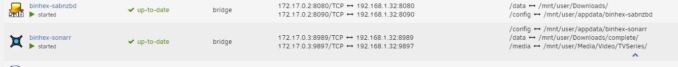

So the only part that still not working is the moving of the downloaded file. My setup is below - incase I have done something stupid. - But that said I cant see anything within Sonarr about the import of the file once its downloaded.
So I have Sonnar which searches the torrent site and adds the torrent to a hosted SeedBox
File is downloaded from hosted seedbox via Resilio-Sync to a share on the UNRAID server - called Downloads
Once the file is on this share I cant figure out how to tell Sonarr its there, so it can pick it up and move it to the correct folder within the TV shows share.
From the one I have just tested - its trying to import the file from the folder structure on the remote seedbox and not from the downloads share on the UNRAID server as I can see this error in the logs
Import failed, path does not exist or is not accessible by Sonarr: /home/psb21620/files/.AMZN.WEB-DL.DDP5.1.H.264-NTb
Correct. Sonarr will import the file from the download folder used by your download client.
