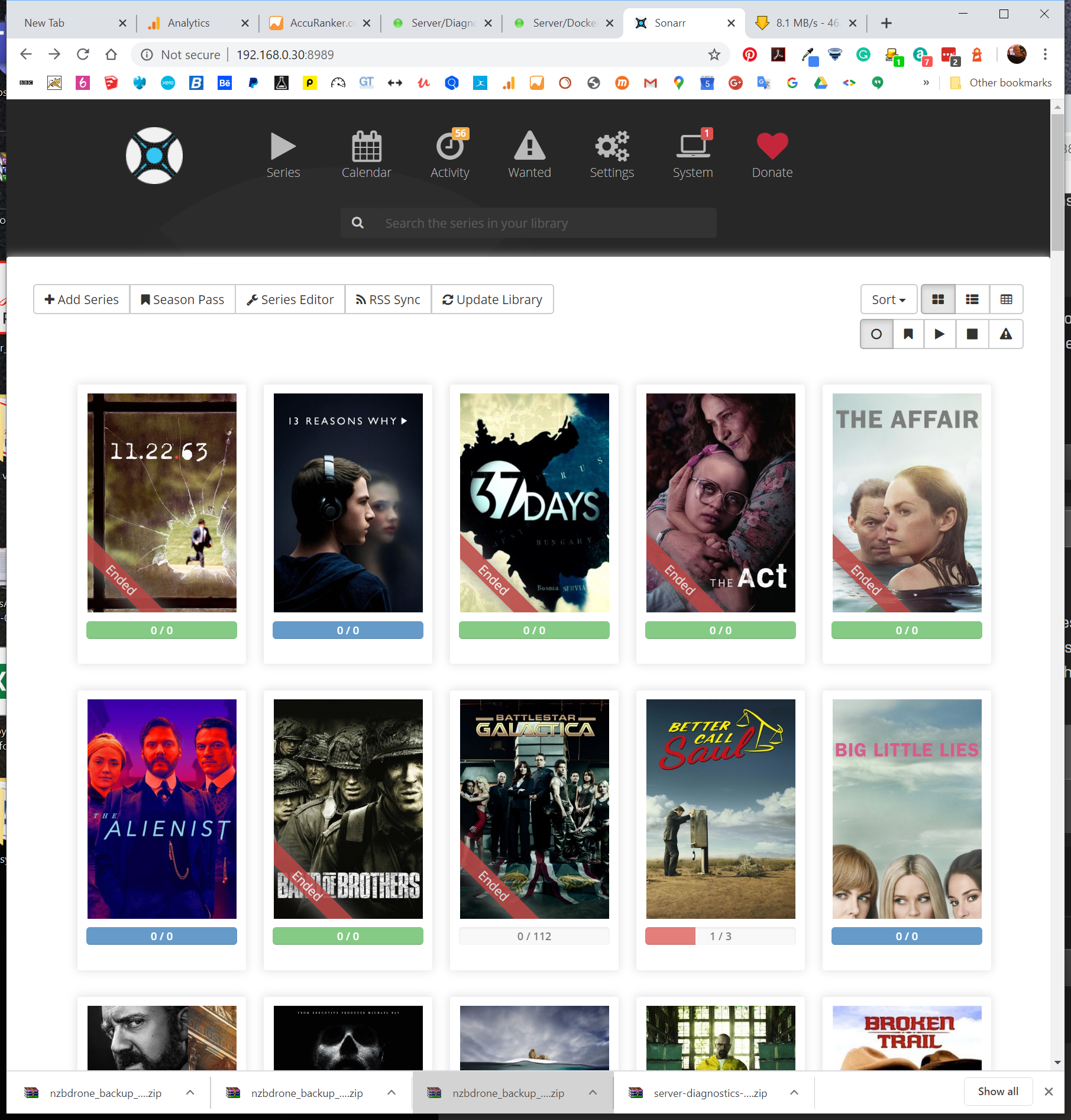

I hope you can help, Sonarr seems to have decided all my series (3000+ episodes) never aired and has thus deleted all my TV media from my server. I have not been using the server much recently and powering down most evenings. Recently I noticed some media was not loading and when i checked, all of the TV media was gone bar a few recently downloaded episodes. It isn't a disc issue as all the content was spread over 12 disks. If you look at the screenshot you can see some series have a blue colour meaning 'not aired' when they clearly have been. Obviously I am gutted and had loads of UHD and BD rips on there too but I'd rather find out what happened before I start thinking about starting my collection again.
Thank you.

Yesterday i had to move my hba card that a pairty drive i was adding and my cache drive attached to it to a different pci port (maybe this is coincidence).
Now i cant get sonarr (or radarr, but my official plex docker and binhex sabnzbd seems to work fine) to get to the webgui.

1 hour ago, AngelEyes said:
I hope the is the right place to post?
Seems unlikely the application would have done that, but if it did then the application website might be a good place to ask. This is just the support thread for setting up the application in docker.
