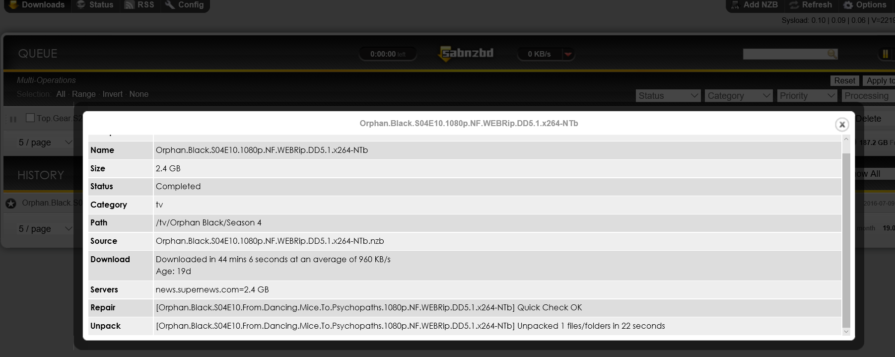

Hi
Thank you for reply, I posted some already. do you mean pic of SAB after download finish and not appear in tv folder?
K

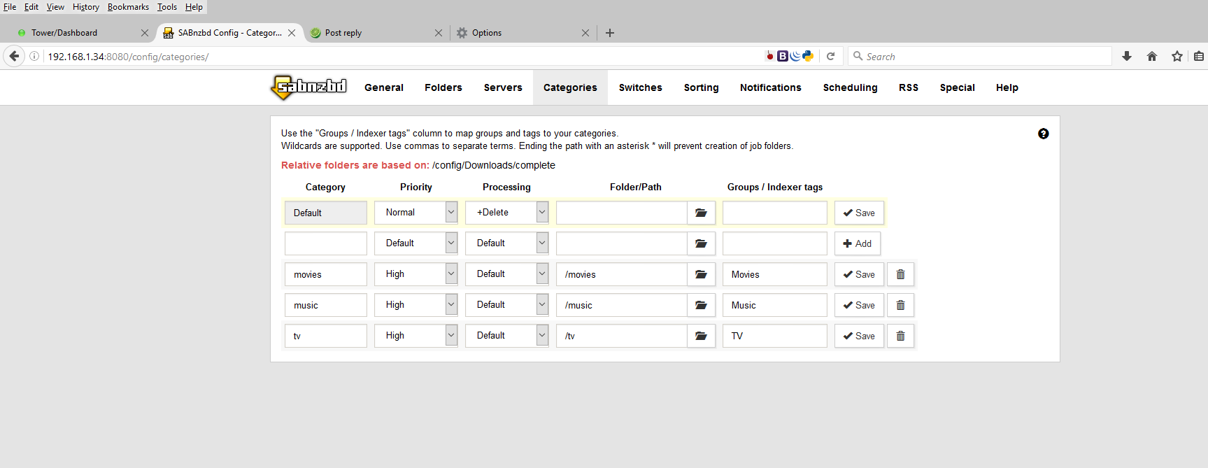

/movies isn't mapped in sabnzbd, so it'll be created in your docker container where you have no access to it.
Neither is /tv or /music for that matter..

You need to add a container volume path of /movies mapped to /mnt/user/movies (or whatever your share is actually called
Docker containers only have access to folders which you explicitly allow them access to.  And this is done via the container & host mappings on the edit container screen.
The host volume is the path to the share.  The container volume is where the actual app looks at.  IE: When you tell the container to look at /movies, it will translate that to look at /mnt/user/movies as an example
Check out the Docker FAQ for some more attempts at explaining all of this.  Host / Container volume mappings is one of those things that's a bitch to explain, but once you understand it, you'll be amazed at actually how simple it is to understand.

You're downloading into /downloads and then setting it to move it into /tv or /movies problem is neither /tv or /movies exist in the nzbget container so it creates the folders INSIDE the docker.img image.  Any folder you want any container to have access to MUST be mapped in the container config.

Edit sorry I see the screenshot, OK you need to define the folders something like this (watch the case as Linux is case sensitive):-
/downloads/movies
/downloads/tv
/downloads/music
Sent from my SM-G900F using Tapatalk
