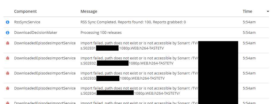

Not looking good.  I manually imported - that went well.  I cleared out the /Downloads (/data). folder  Then I downloaded a specific Season of an already downloaded series.  It all downloaded as expected to the /Downloads (/data) folder.
Been waiting for any of it to import by itself.   Been about 40 minutes total - but only 2 minutes since the last episode fully completed.
I guess I'll just see what happens by morning, but somewhat deflated.
Looks like it isn't working.  It is definitely looking in the wrong place for files.  It is looking in the /media directory (/TV) and not finding the files there - of course, they are in /data (/Downloads).
Not even sure where Sonarr is getting that information - except for the Container settings for /media.  But why?  Wouldn't /data be used for the location of the downloads?
Sorry to continually post.. But it seems to be working now.  I had to remove that specific series from /Downloads and from SONARR series list.  Then I had to remove all of my other downloaded content (or manually import).  After that - it seems to be working.  I will have to re-try that series after the one I have downloading now.
FYI - that particular series was Originally in there when the mappings were messed up.  I did remove it and try re-adding it later after the settings were as they are now. But that still caused log issues.
And to finish this off... I believe it is all resolved.  I had to purge the history in SABnzbd.  That is where SONARR was getting its information and what was causing the problems.  SONARR kept looking way back in history - seeing those files were downloaded to /TV (apparently), and tried to import them from that location.
This is why only new shows would properly import. Anything I imported prior to settings being fixed were still tagged to /TV.
I feel both smarter and more ignorant after all of this :)  Appreciate the help!

Hi all, seeing "database is locked" errors in SQLite for Sonarr on downloads.  Sometimes Sonarr imports fine, sometimes I get the error and while the file is moved, Sonarr never recognizes this because of the database locked error.  While attempting to resolve this I have confirmed/tried a few things:
  • Check all my paths between SAB and Sonarr (both have exactly the same path set in docker, i.e., /data -> /mnt/cache/Downloads/)
  • Ensured all docker containers /config maps to /mnt/cache/appdata
  • Looked at permissions for my /mnt/cache/Downloads files and folders, which were all set to 777
Log file attached as an example.  Any ideas of what else I can try short of just blowing Sonarr away and starting over?
