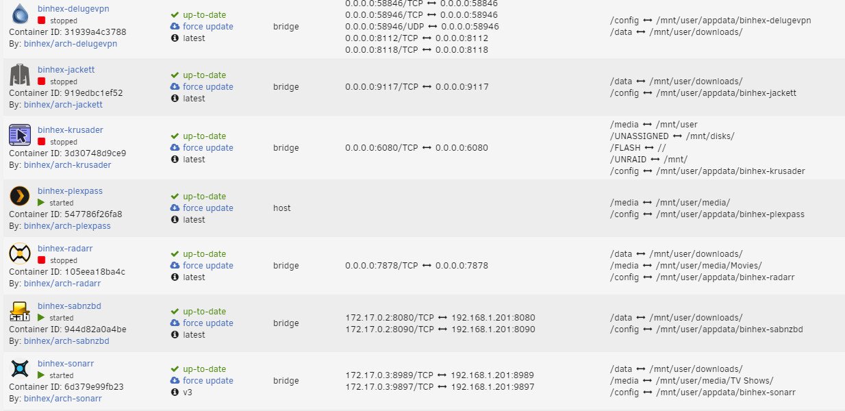

I appreciate the suggestion but it didn't seem to help.  Here are my changes:
Sonarr.thumb.jpg.12033b6425f7dd681c1a08719f00134b.jpgMap.jpg.5c126ffa41eb8fa0f5599d16e7ab8c01.jpg
I failed to mention that binhex-delugevpn is configured the same as binhex-sabnzbd and sonarr has no problems accessing the downloads from it and adding them to my media.

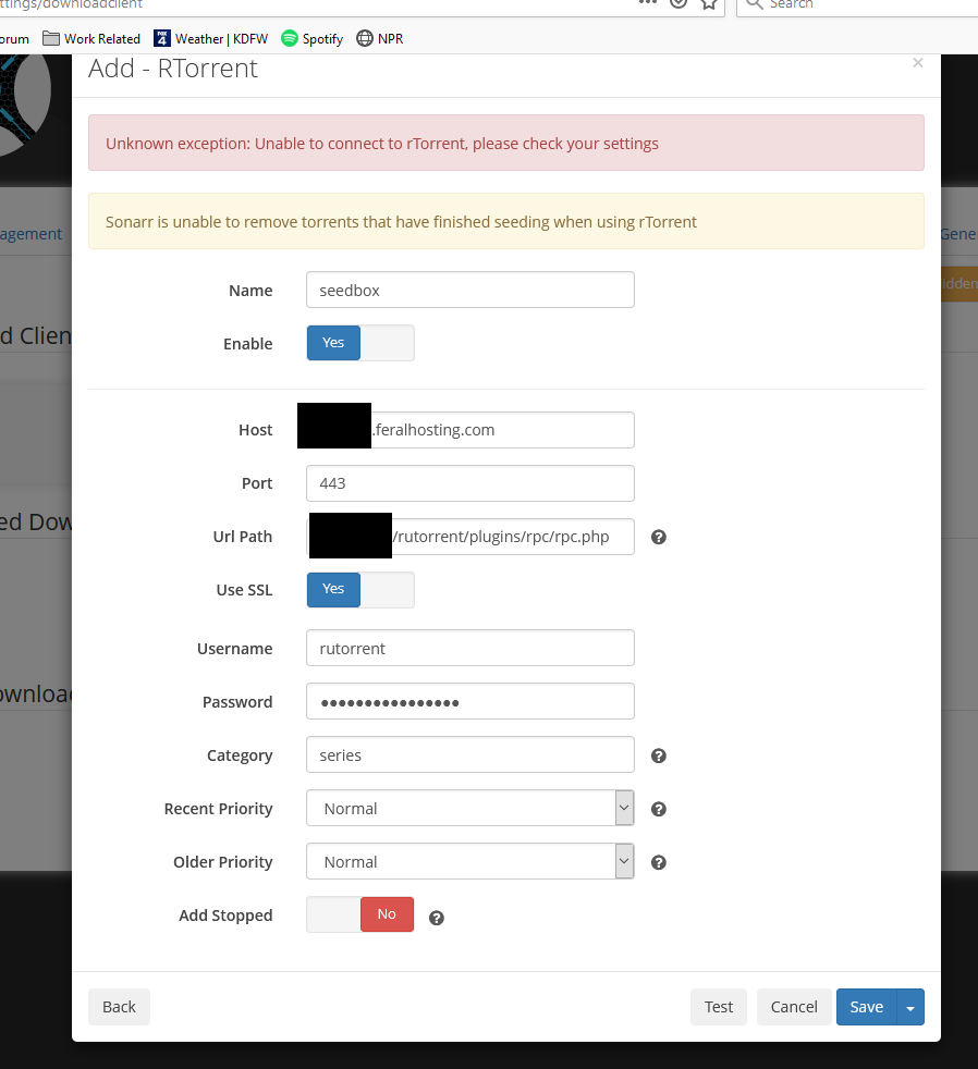

Not sure if this is the right place, but I'm running out of ideas.  setup unraid server. trying to setup sonarr (never used it before). following spaceinvader on video and get to point of pointing sonarr at the seedbox. I'm using feral hosting. I follow the instructions between the video and and feral wiki and wind up here with a failed test. Any help you can provide would be great. I've tried using both my username and "rutorrent" in the username box.
Solved it, not sure what I did, just kept trying the same things in different ways.  Might have been a spelling error somewhere

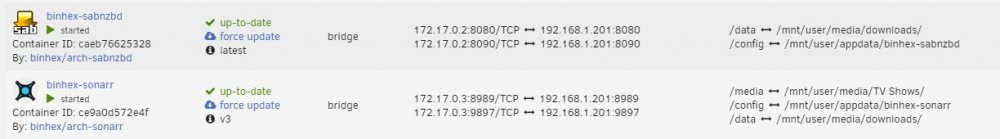

I'm trying to understand the difference between the sonarr and radarr Docker compose when it comes to port mapping.
Sonarr port host 1: 7878 (I understand this)
Radarr port host 1: 8989
Port host 2: 9897
This is where I get confused. Why is there a need for 2? The webui opens to port 8989 so where does 9897 come into play? Why does sonarr not have two ports?

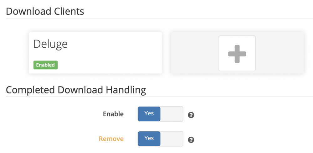

Hi, a few months ago my qbittorrentvpn stopped working with this docker. I eventually removed the docker image, then deleted the app folder. Reinstalled qbittorrentvpn and got that going again, but for some reason it won't connect when adding it as a download client. Not that big of a deal, because I also setup binhex-delugevpn, which after finally configuring it right do I have it working again and connected to this Sonarr docker. Not sure why qbittorrentvpn won't connect, but at least deluge is working again (for the most part) with it.
My only issue now is I have Completed Download Handling Enabled and Removed both checked. But when I download something from Sonarr, after it finishes moving it won't delete the torrent. Is there something else I need to do in deluge that I'm missing? This option worked great before, so would like to have it set so it'd delete Torrents setup with Sonarr. Not sure where to go from here. Any suggestions? Any help would be much appreciated!
Try setting the torrent to a paused state when it finished in the download client (deluge or qbittorrent) as opposed to having the download client delete it. Sonarr should then move the file and remove it from the client. Try restarting both containers after changing the settings. Let us know if you still have an issue and if so send us some screenshots of your settings.
Deluge does move the torrent after it finishes, just doesn't delete it. It's moved out of the Sonarr client Activity section, but doesn't delete it from Deluge. Tried Pausing the torrent after it finished, stopped and restarted both dockers and still having the issue. Attached a couple screenshots, and my logs. If you need something specific, please let me know. Thanks for the help!

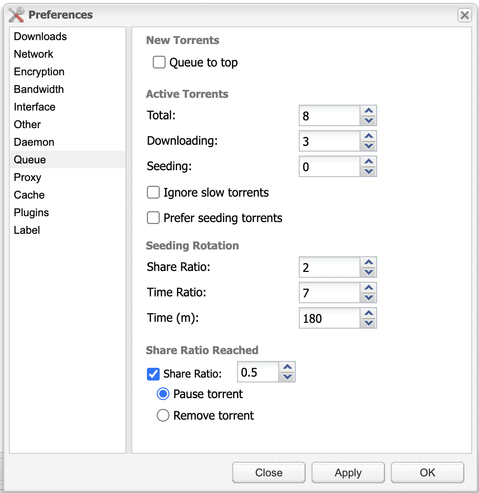

@yanksno1

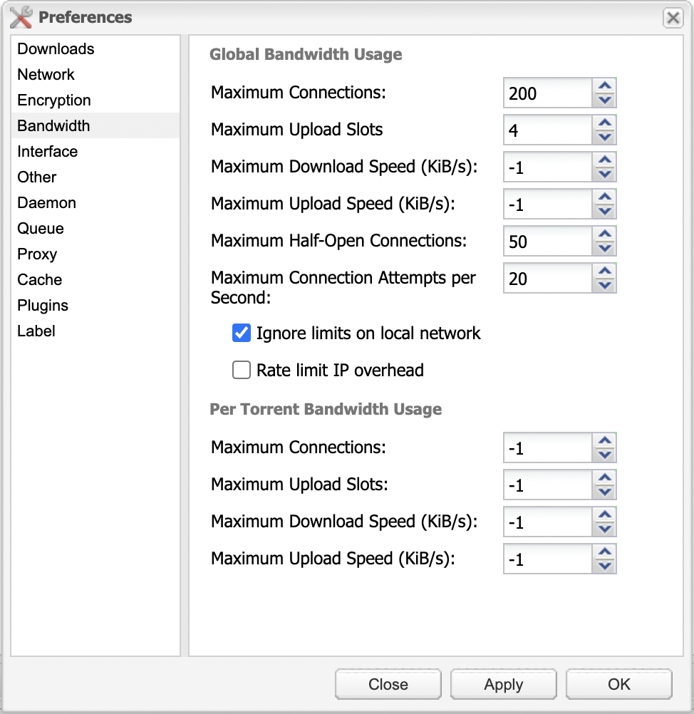

Can you also post screenshots of Deluge - Downloads, Queue? So far everything looks ok as far as settings.
In your syslog, there are Disk Read errors for Disk 1. I'm not sure if this is of consequence, but that drive may be having issues. I would do research on this forum how to repair/rebuild/replace that drive if necessary.
Yup, here they are. I first got a couple of those Disk SMART errors a few months ago. At the time, there were only 2 but looks like I now have 5. Asked here if I should replace the HDD, but someone thought it wasn't that big of an issue since it was 2 and I just got a clean SMART test result. Just did a new one and got back errors, 5 this time. Think it's time to replace the HDD that's causing this issue? The downloading is being done on my SATA cache drive, then moved over fine (just deluge doesn't delete it). Looks like it did get moved over to the Disk 1. Posted the screen shots and the SMART test log. Your thoughts are much appreciated!
tower-smart-20210109-0952.zip

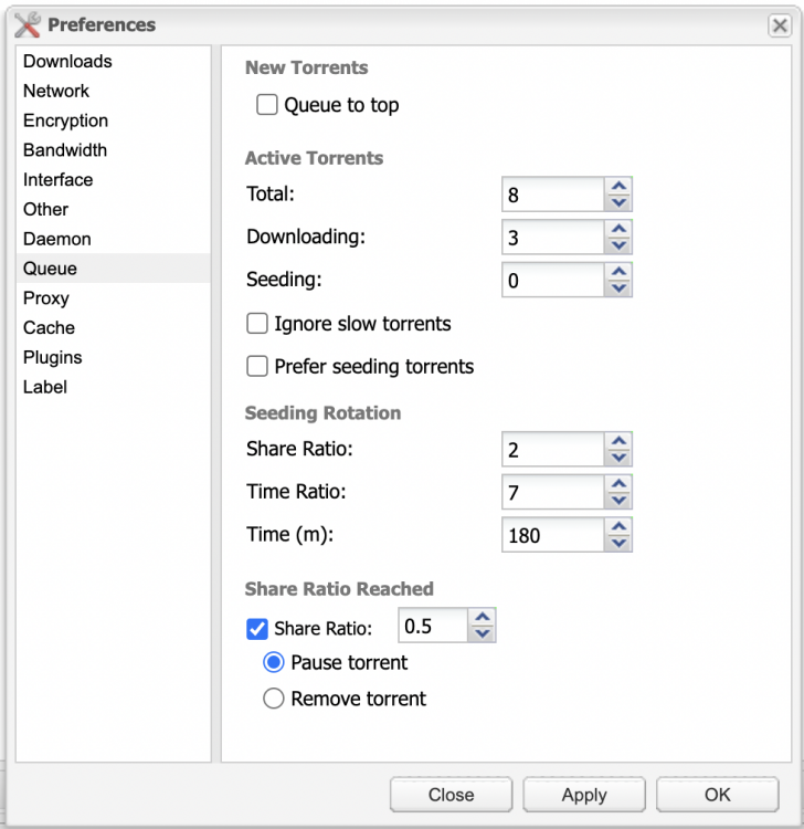

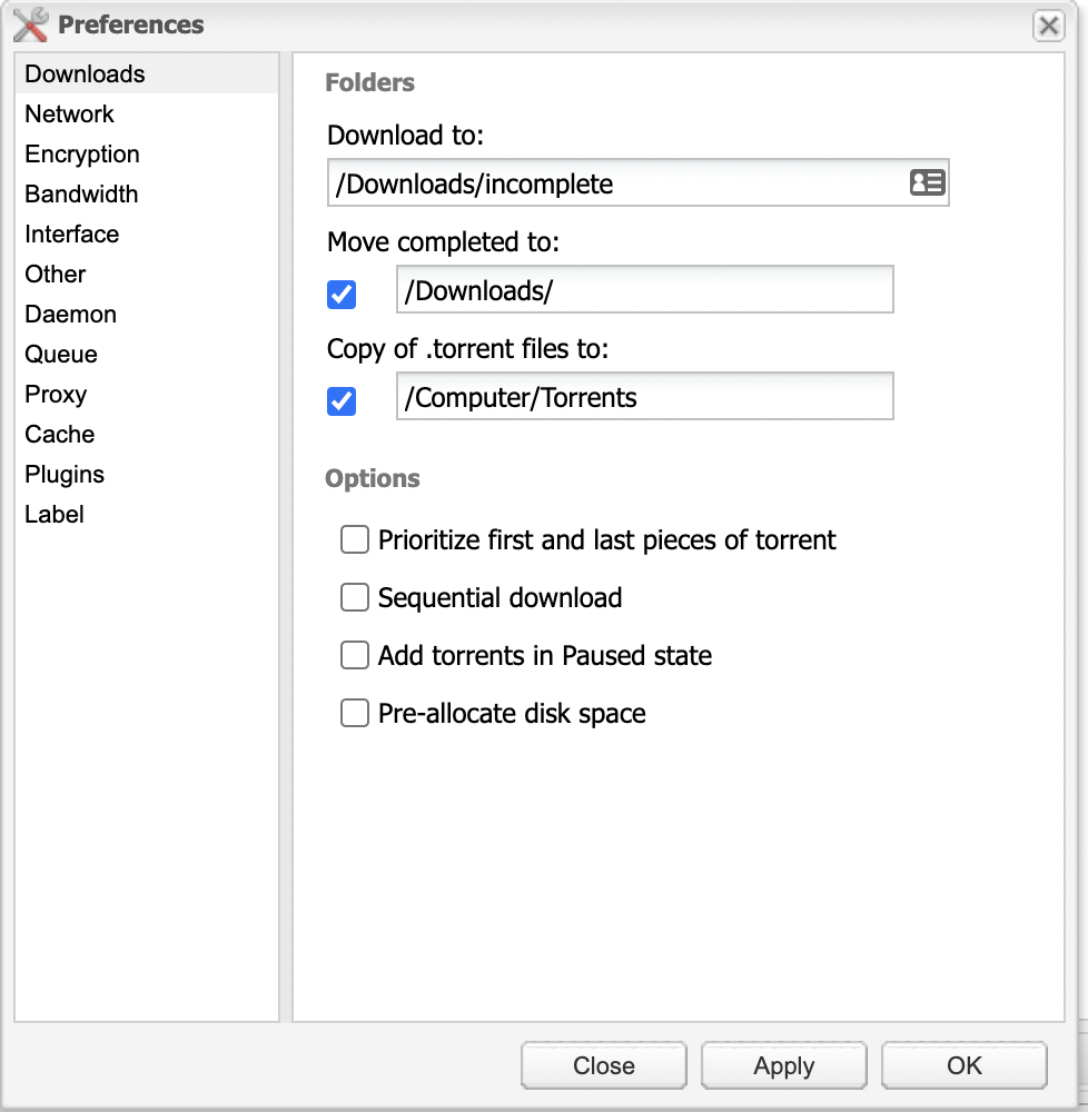

Thanks for sending those.
I'd say try these changes and see if you have success:
  1. Change your download folder directory. Right now, your completed downloads are 'upstream' of your downloads in progress. I'm not sure if you HAVE to do this, but it might be worth a try. Create a /Downloads/complete directory and keep your current /Downloads/incomplete.
  2. Check the box for 'Share Ratio', then keep the bubble checked for 'Pause torrent.' Make the share ratio as low or high as you'd like. Maybe turn it down as low as you can while testing. Also, your downloads may not have been removed because they are set to seed for high share/time ratios. Decrease all the numbers for 'Seeding Rotation' while you are testing, then bump them back up to whatever you'd like.

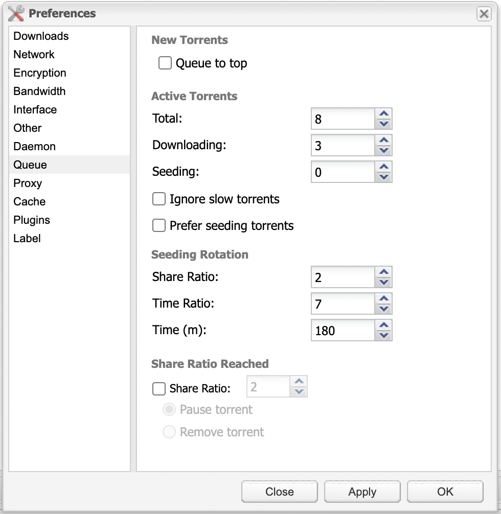

Made those suggested changes and still behaving the same way. Did move it after it finished to the Completed folder! But the torrent in deluge and the original file is still there in the Completed folder on Disk 1. Think those SMART errors are the problem and it's time to replace the drive? Here's how I have the Queue set up now:
88186011_ScreenShot2021-01-10at2_48_57PM.thumb.png.3ab9e10c31958c184d556d01c6543861.png
EDIT: Also should mention if I manually delete the torrent in deluge, it WILL delete the file in the Completed folder. Any other suggestions to try?
Edited by yanksno1
Is the file still seeding after it is moved, or is it in a paused state? You could still turn down the Share Ratio, Time Ratio, and Time to as close to zero while testing.
It could be a permissions issue. Do the sonarr logs point to anything?
