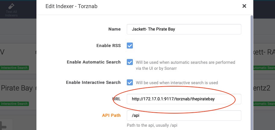

Guys I'm really drawing a blank here, I cant seem to get my indexers working through jackett anymore.
I tried reading the FAQ but I'm not sure exactly which parts are relevant for my configuration, could anyone take a look and see what I missed?
https://imgur.com/a/NTsi0ZM
Edit: So today when I checked everything just worked for Sonarr without any more changes, Radarr still have the same problem though and I have the same settings there.
Any tips?
