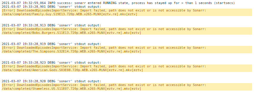

Hey Fellas

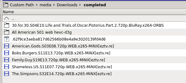

I need some help trying to figure out why this issue cropped up with Sonarr. First let me start off by saying that everything has been working correctly. I use a combination of Binhex Sonarr, Radarr, qBittorrentVPN, and sabnzb.
So the logs are showing this which by now WE ALL know has to do with drive mappings being "incorrect"

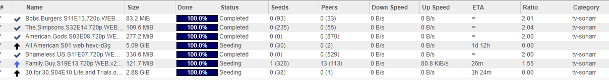

As we can see the files in question have all downloaded

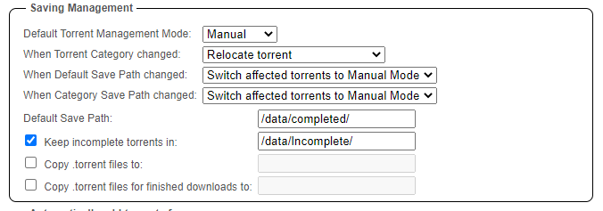

qBittorrent points to the following ... but we are going to come back to this because I noticed something here.

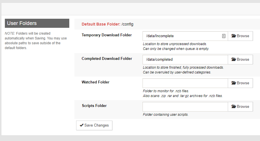

This is the locations for SabNZB
If we look inside the folder you will see the files

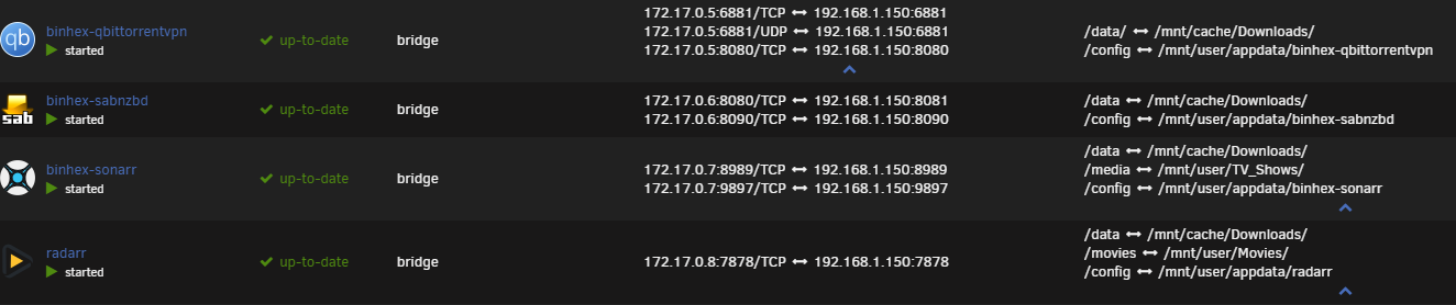

And here are the drive mappings for all the dockers ... they are exactly the same across the board. And like I said this was ALL WORKING up until today. I don't touch this stuff as I like to set it and forget it.
Now I HAD this same issue when I first installed Sonarr on this new server a couple of weeks ago. If you look at the pictures above in qBittorrent you will see that the folders have a wack " / " at the end, I had to remove the last wack " / "  in order to get Sonarr to work the first time around, but this time I can't remove that wack anymore. Everytime I do it comes back when I go check it. This is the only difference between the working SAB and the no longer working qBit
I am sure you guys are absolutely tired of seeing these questions. Like I said I had this all working and today for some odd reason it stopped.
Here is the last successful download from qBittorrent which was yesterday
21-3-6 09:58:15.3|Info|DownloadService|Report sent to QBitTorrentVPN. 30 for 30 S04E10 Life and Trials of Oscar Pistorius Part 2 720p BluRay x264-ORBS

Those episodes in green downloaded and transferred correctly. And this is the first failure of an episode from qBittorrent in the log from yesterday evening.
21-3-6 21:44:55.2|Info|DownloadService|Report sent to QBitTorrentVPN. American Gods S03E08 720p WEB x265-MiNX
21-3-6 21:44:55.2|Info|RssSyncService|RSS Sync Completed. Reports found: 440, Reports grabbed: 2
21-3-6 21:46:06.0|Error|DownloadedEpisodesImportService|Import failed, path does not exist or is not accessible by Sonarr: /data/completed/American.Gods.S03E08.720p.WEB.x265-MiNX[eztv.re].mkv[eztv]
21-3-6 21:47:37.0|Error|DownloadedEpisodesImportService|Import failed, path does not exist or is not accessible by Sonarr: /data/completed/American.Gods.S03E08.720p.WEB.x265-MiNX[eztv.re].mkv[eztv]
21-3-6 21:47:42.0|Error|DownloadedEpisodesImportService|Import failed, path does not exist or is not accessible by Sonarr: /data/completed/American.Gods.S03E08.720p.WEB.x265-MiNX[eztv.re].mkv[eztv]
21-3-6 21:49:06.2|Error|DownloadedEpisodesImportService|Import failed, path does not exist or is not accessible by Sonarr: /data/completed/American.Gods.S03E08.720p.WEB.x265-MiNX[eztv.re].mkv[eztv]
21-3-6 21:50:36.2|Error|DownloadedEpisodesImportService|Import failed, path does not exist or is not accessible by Sonarr: /data/completed/American.Gods.S03E08.720p.WEB.x265-MiNX[eztv.re].mkv[eztv]
21-3-6 21:51:36.3|Error|DownloadedEpisodesImportService|Import failed, path does not exist or is not accessible by Sonarr: /data/completed/American.Gods.S03E08.720p.WEB.x265-MiNX[eztv.re].mkv[eztv]
21-3-6 21:52:36.4|Error|DownloadedEpisodesImportService|Import failed, path does not exist or is not accessible by Sonarr: /data/completed/American.Gods.S03E08.720p.WEB.x265-MiNX[eztv.re].mkv[eztv]
21-3-6 21:54:06.4|Error|DownloadedEpisodesImportService|Import failed, path does not exist or is not accessible by Sonarr: /data/completed/American.Gods.S03E08.720p.WEB.x265-MiNX[eztv.re].mkv[eztv]
21-3-6 21:55:36.4|Error|DownloadedEpisodesImportService|Import failed, path does not exist or is not accessible by Sonarr: /data/completed/American.Gods.S03E08.720p.WEB.x265-MiNX[eztv.re].mkv[eztv]
21-3-6 21:57:06.5|Error|DownloadedEpisodesImportService|Import failed, path does not exist or is not accessible by Sonarr: /data/completed/American.Gods.S03E08.720p.WEB.x265-MiNX[eztv.re].mkv[eztv]
21-3-6 21:58:36.5|Error|DownloadedEpisodesImportService|Import failed, path does not exist or is not accessible by Sonarr: /data/completed/American.Gods.S03E08.720p.WEB.x265-MiNX[eztv.re].mkv[eztv]
21-3-6 21:59:36.5|Error|DownloadedEpisodesImportService|Import failed, path does not exist or is not accessible by Sonarr: /data/completed/American.Gods.S03E08.720p.WEB.x265-MiNX[eztv.re].mkv[eztv]
There was no docker updates, no server reboot, as I said I like to get things running and then leave it alone as I find that when you tinker with shit you end up breaking shit! So any insight you guys may have or if you see something that I miss let me know. This one has me stumped today.

Had an update to Sonarr today, however, it now although the Docker appears to start, the web page cannot be accessed..
Log extract as below:
2021-03-09 07:07:39,777 DEBG fd 8 closed, stopped monitoring <POutputDispatcher at 23179386370032 for <Subprocess at 23179386370320 with name sonarr in state STARTING> (stdout)>
2021-03-09 07:07:39,777 DEBG fd 10 closed, stopped monitoring <POutputDispatcher at 23179385933344 for <Subprocess at 23179386370320 with name sonarr in state STARTING> (stderr)>
2021-03-09 07:07:39,777 INFO exited: sonarr (exit status 2; not expected)
2021-03-09 07:07:39,777 DEBG received SIGCHLD indicating a child quit
2021-03-09 07:07:41,780 INFO spawned: 'sonarr' with pid 65
2021-03-09 07:07:41,790 DEBG 'sonarr' stderr output:
Cannot open assembly '/usr/lib/sonarr/NzbDrone.exe': No such file or directory.
I don't see a sonarr folder under /usr/lib ?
Thanks
Ian
Thanks
Ian
I had the same issue. Not sure if it's the correct procedure, but I bashed into the container and changed the script in: /home/nobody
and change the app path to /usr/bin/mono --debug /usr/lib/sonarr/bin/Sonarr.exe -nobrowser -data=/config
Wierdly, when I reset the container, same issue, but they just pasted "/usr/bin/mono --debug /usr/lib/sonarr/bin/Sonarr.exe -nobrowser -data=/config" in the terminal and it ran.
I believe they changed the app name from NzbDrone to Sonarr in V3.

see recommended post at the top of the screen - that error (now fixed) was fallout from the switch from v2 to v3.
I did try the :latest tag, but for some reason, it didn't seem to pull properly for me :/ I don't know enough about Unraid/Docker to say why it didn't work as it should for me.
