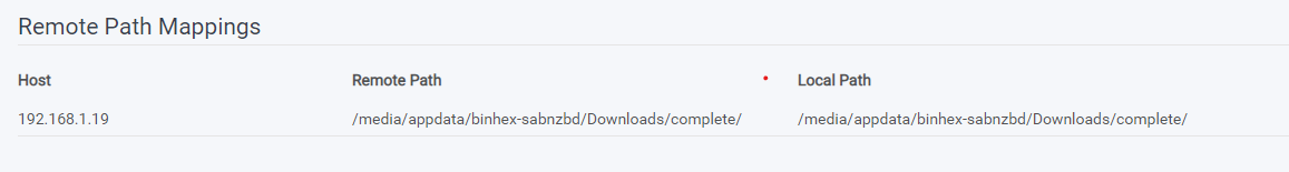

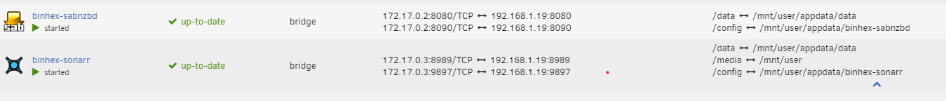

I feel like I'm missing something basic.  New to Unraid and Docker, but not SABNzb and Sonarr (used them on Windows machines previously).  Sonarr is not seeing/copying/moving downloaded files.  Help please?  Thanks in advance!
Container basics:
Sonarr config
SABNzb config
Container basics:
Sonarr config
SABNzb config
I would first create a separate share for Downloads (with "complete" and "incomplete" folders) and then map /data to that share (/Downloads) on both SABnzbds and Sonarrs containers. Right now your downloads will go into you appdata folder.
Then you point /media in Sonarr to the folder on unRAID where you have your TV shows.
Regarding your Sonarr config I don't use Remote Path Mappings so I can't give you answers there. But I don't think that is needed if you configure the rest correct?

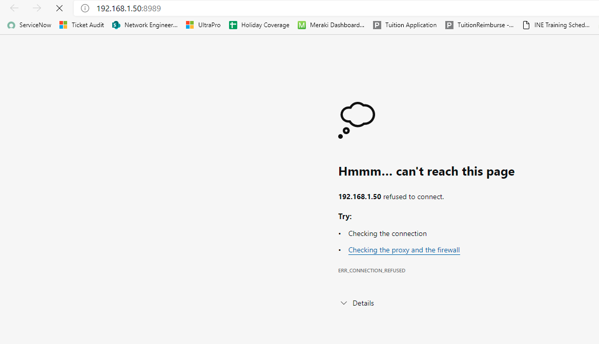

I have been using Sonarr for a while and has been working great. The other day I was unable to login to the WebUI. it displays this message
"Hmmm… can't reach this page
xxx.xxx.x.xxx refused to connect.
Try:
Checking the connection
Checking the proxy and the firewall
ERR_CONNECTION_REFUSED"
I've tried reinstalling docker, it's fully updated, I've tried changing port numbers, tried from multiple computers\browsers. Also my other dockers are working including SAB,Plex,Radarr, Krusader.
Any ideas of what else to look at to fix this?

check the log file, attach /config/supervisord.log

14 hours ago, Bill leeder said:
crap...sorry here is the sonarr one
as i suspected, you have a corrupt database, from your log:-
database disk image is malformed
you need to restore your configuration using 'Appdata Backup/Restore v2' plugin (if you dont have this installed then i highly recommend it), if you dont have a backup of your appdata then your only course of action is to delete the existing corrupt db and let it re-create a blank one, then reconfigure, to delete the db do the following:-
1. stop container
2. delete files /config/logs*
3. delete files /config/sonarr*
4. start container and reconfigure.

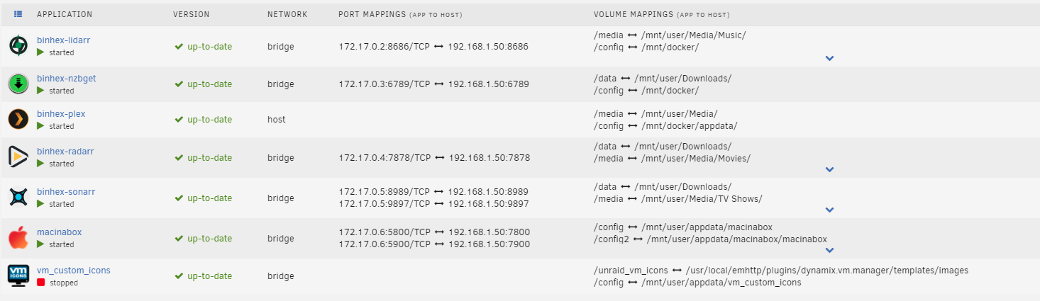

I am having issues with a number of dockers showing refused to connect:
Below are the dockers I have so far:
Plex, NZBgetm and radarr have no issues.
Lidarr and Sonarr refuse to connect
I am running a bond interface:
I have deleted the dockers, deleted their folders in my appdata folder and re-installed
unraid-diagnostics-20210512-1055.zip
sonarr.txt
supervisord.log
