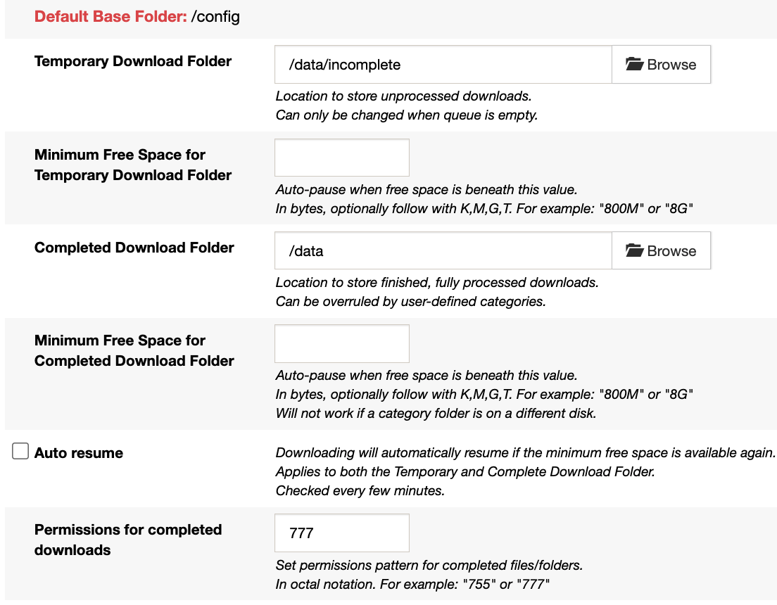

These are my SABNZb folder settings:
I cant seem to figure out where Sonarr is pulling the path /Data/TV from

So I have matched the download folders paths for both Sonarr and  SabNZB so they are pointing to
/mnt/cache/downloads/completed/TV/
In Sab the completed download folder is pointing to /Data
The error message is still saying: /data/TV ...Ensure the path exists and the user running sonarr has the correct permissions.
What am I missing?

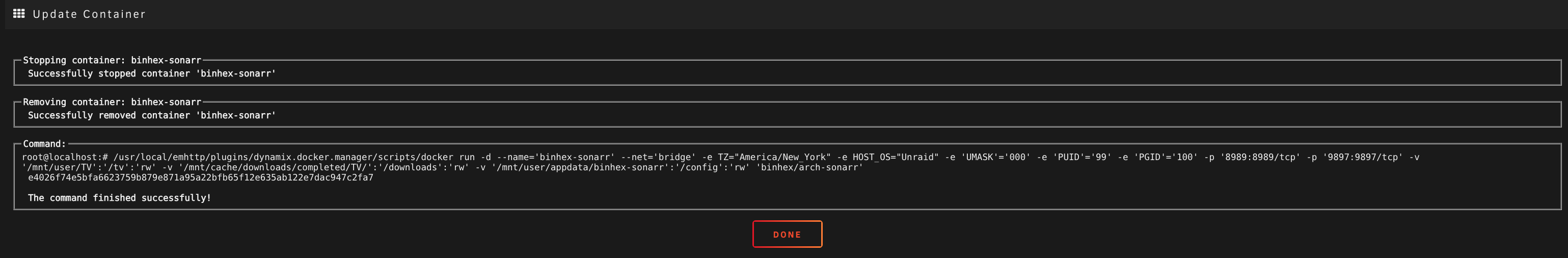

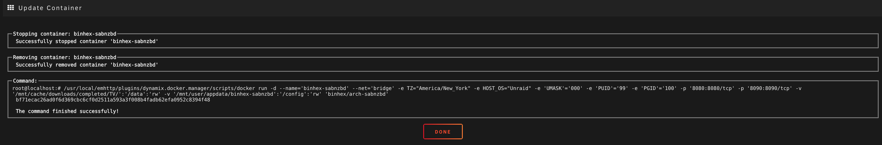

Here is the data you requested.
Apologies for my inability to follow simply instructions

2 minutes ago, ashman70 said:
Ive read your thread and I still don't understand how to get the docker run command to appear, sorry.
Open the settings for this docker in the webUI. Change any setting and then change it back. When you click apply the run command will be displayed in a popup window. You can just copy and paste it to your next post.
Thanks, I figured out how to post the docker run commands.
I am still having the issue.
Edited by ashman70
Because data != downloads
2 hours ago, jonathanm said:
both halves of the mapping?
You only made the host side match, container side must be the same as well.
"Container side must be the same as well"
Do you mean in the app itself or in the docker settings?
The template settings.
Or put another way, Sab tells sonarr that the download exists at /data/fileNameHere.mkv
Sonarr dutifully tries, but there is no /data mapped to it, hence the error you're seeing.
Changing the container path within either sonarr or sab to match the container path on the other will fix you up.
Thank you for your help, I was able to figure it out.
